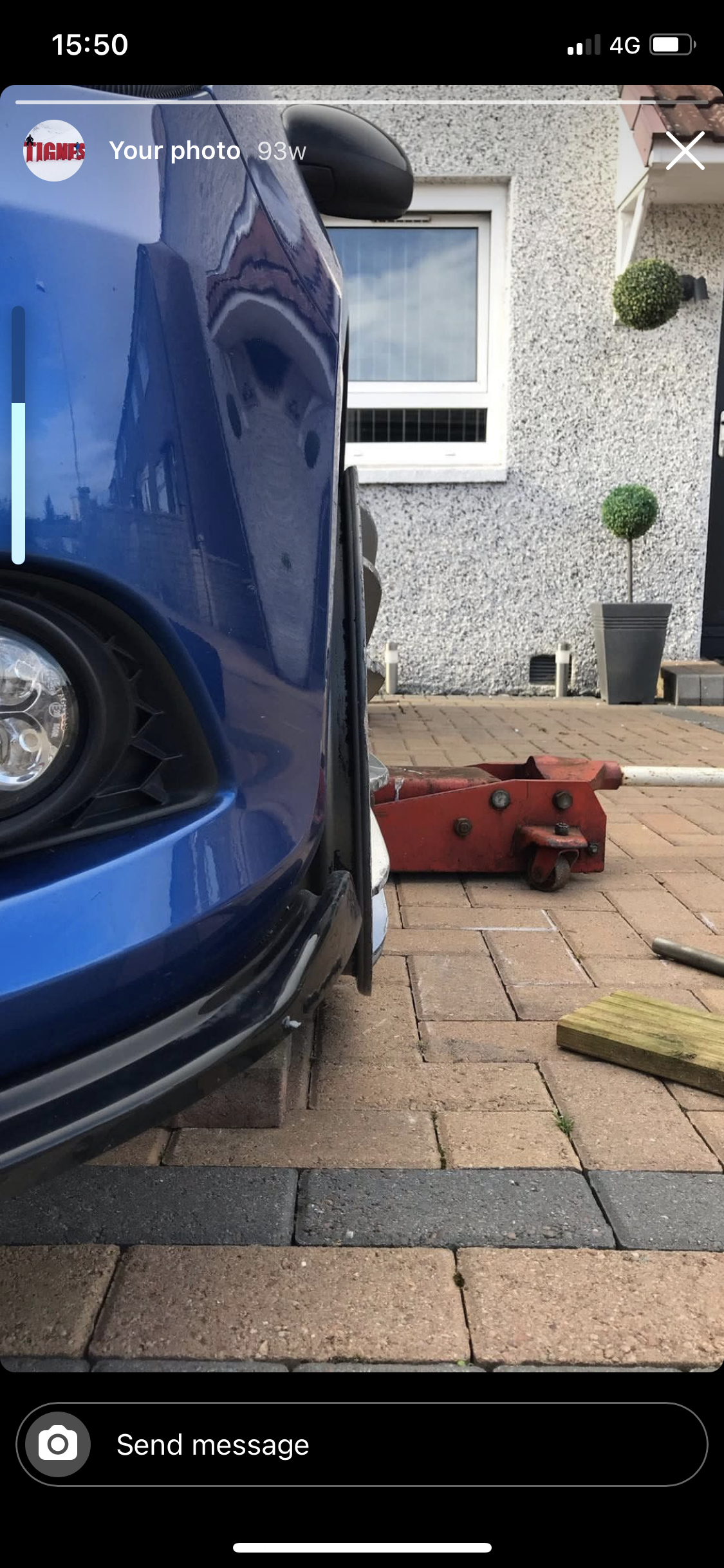

So the most I can go really is 8j ET35 with 205/40 on to be safe of mo rubbing. I don't mind having the tyre stretched.
I brought some 8.5j, 9.5j staggered they are far too big wide lol. Alloy websites say they will fit my car though???

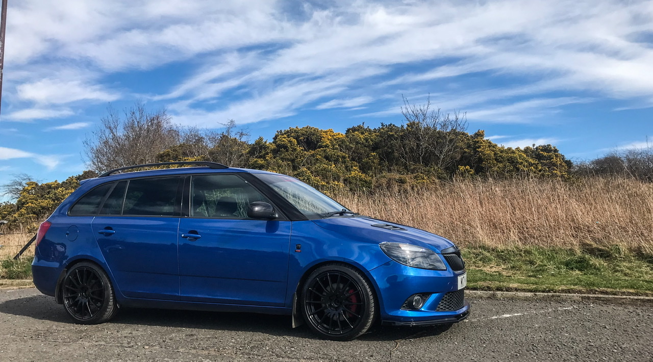

I've ran 18"x 8J ET38  on the fabia on 215/25/18 without issues, Also ran 17"x8j ET30 with no issues & lowered 40mm
I'm now running 17"x7j alloys, 18's looked great but not practical.
Edited by Mickmartin
Hi again. What size wheel is on your car in the top picture?
