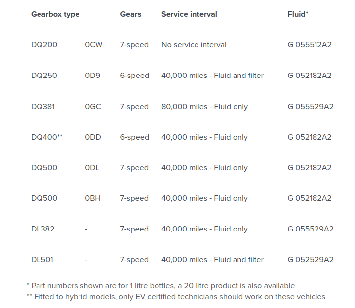

It is a DQ200 DSG if a 1.6TDI.
 It is if FWD and with an engine producing no more than a 250Nm of torque.
That is how it has been since 2009.
(As for a Sealed Box, well there was the World Wide Recall in 2012 & the European Service Campaign from 2014 when the Oil was changed from Synthetic to Mineral in boxes 2009-2012.  Then there are members here that do oil changes as nothing is sealed for life if it has a drain plug and a refill place.)

If you still have the car in 2027 maybe think about having the oils changed but that is up to you.
There is no service interval or regime or any recommendations for doing any servicing on a DQ200 DSG.
It is a case of doing nothing unless you have a fault.  They can need Clutch Packs, they can need new or refurbished Mechatronic Control Units, they can go wrong, but not according to the VW Group.
So there is no Servicing Schedule or Recommendations from the VW Group.
Some do preventative servicing but that is their and your own choice.
