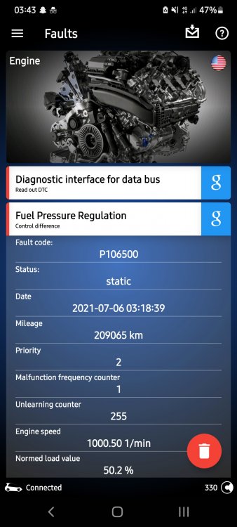

Hi,
I am getting fault code fuel pressure regulation- control difference code P106500 erased code re appears after a day or two searched what this could be can't find answer. Not much on the net regards to this.
Any help would be appreciated.

Couple of areas that I would look at:
1) The incoming fuel pressure.  Have a look at the fuel filter to see if you are not suffering from fuel starvation.
1a) Check the status of the fuel pump - this may also be showing signs of failure.
2) Check that you don't have pressure issues on the high-pressure side of your fuel system into your injectors.  At 209,000kms or 129k miles, I would also be look at fuel injectors that could be failing.
3) Make sure that the high-pressure fuel pump is also not failing - from low pressure to high-pressure.
