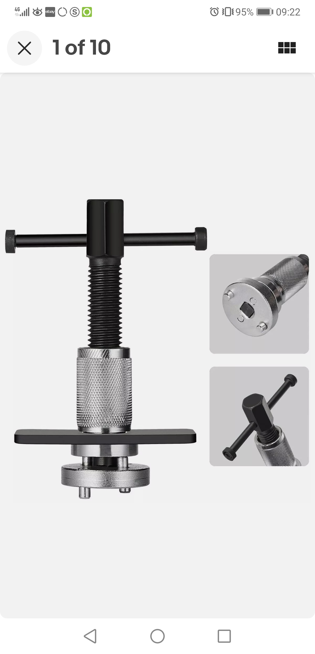

You will need a windback tool. https://www.ebay.co.uk/itm/114581339679. Don't buy the other cheaper types they dont have the strength and slip. This has a spanner fitting on the piston the others dont.

@foru2justnv & @Snapper1725 Thanks guys, much appreciated. Sounds like it may be sensible to buy a windback tool, just to be on the safe side. Or else just take it to a garage and let them worry about it!
Just dont buy this one. If your piston is stiff this will slip
@foru2justnv Duly noted. To be honest, given the cost of the windback tool, the pin repair kit and the time it will no doubt take me (every time I do something mechanical on the car I swear never again!), I'm leaning towards just taking it to a local garage and letting them at it. I'll probably buy the tools later on, but really I need it looked at sooner than the time it would take to get the windback tool from Amazon and the repair kit from eastern Europe etc. I am still in two minds, but I think I'll speak to a garage today and see what it would cost to get them to do it.

Halfords do the Laser one which I bought

The main thing with the rear brakes is to make sure the windback tool rotates the piston as it goes in, and doesn't just push straight back. For the slide pins, probably all that's needed is give the pins and the socket they slide in a rub down with some 600 grit emery paper and put some grease on them.
@foru2justnv Famous last words! Yeah, that's one of the videos I'd looked at, but I know from experience that Autodoc's videos make things look far simpler than they are. But anyways, you've talked me into it. I ordered the windback tool and grease and I'll give it a bash once they arrive. When it all goes pear-shaped, I'm holding you firmly to account! Thanks for all the help.
