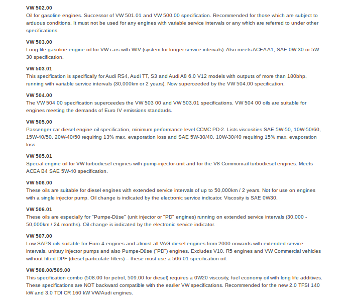

The VW group recommended oil for your car is 5w 30 FS III (Long Life) which is to VW 504 00 / 507 00.
The 0w 20 FS IV is what VW started using from the factory for the WLTP / RDE and when the GPF's were fitted to TSI's, and that is VW 508 00 / 509 00
It is not a recommended oil for your age of TSI and it is another chance for a co-ck up with Dealership employees.
These are the people that say you must use the Recommended Spec of oil.  That is the Manufacturers Recommended, not some muppets with no idea of their arse from their elbow.
*They need to read the 'Not backword compatible.' bit in the VW Group Information.*

Usually it is best to go for the correct oil for your vehicle and in your case it is VW 504 00 and that is usually 5w 30 FS III  be it fixed or variable service intervals.  You can do oil / filter changed at up to 18,000 - 20,000 miles.     VW 508 00 so 0w 20 FS IV is not the correct oil for your car.
I recommend that the best stuff is the VW/Skoda/Seat 504/507 0W-30 Longlife LEIII engine oil.
