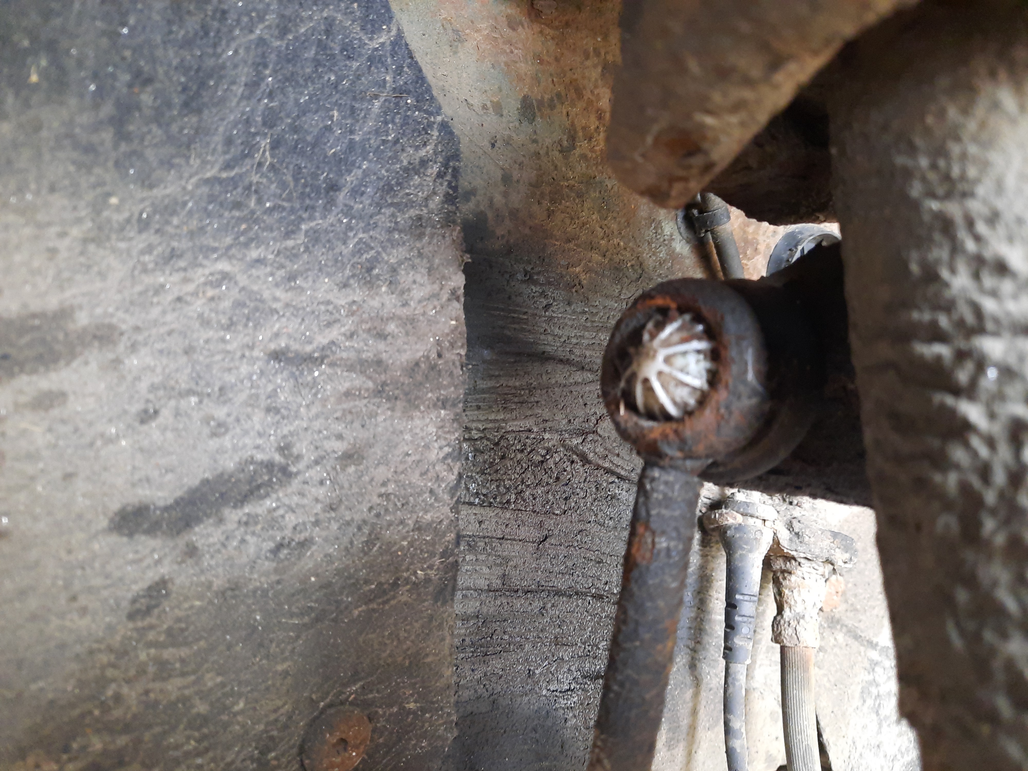

How do you remove this nut it just spins, there's a white plastic cover thing on the other end do I have to remove this first?

There's generally a hex, XZN or torx-key orifice in the end of the threaded rod, for counterholding.
Or sometime flats nearer the balljoint that an open-ended spanner can get on.
Edited by Wino
Where the nut is, you should be able to put Allen key or torx,
If not then you should be able to put a spanner near the joint where the rubber boot ends and then undo nut

Where the arrow points

I see that. So I tried a 4.5mm Allen bit and it seemed a good fit however it may well be a torx of similar size and I may end up ruining the hole. Is there an obvious way to tell which bit type and size needed?
I didn't actually try and remove the nut yet just tried a bit for size.
No obvious way as different brands may vary in size,
If the Allen fits snug (no movement) hold it tight then just go for it,

I've never come across a 4.5mm Allen fitting on anything VAG I don't think, so my money is on a Torx.
