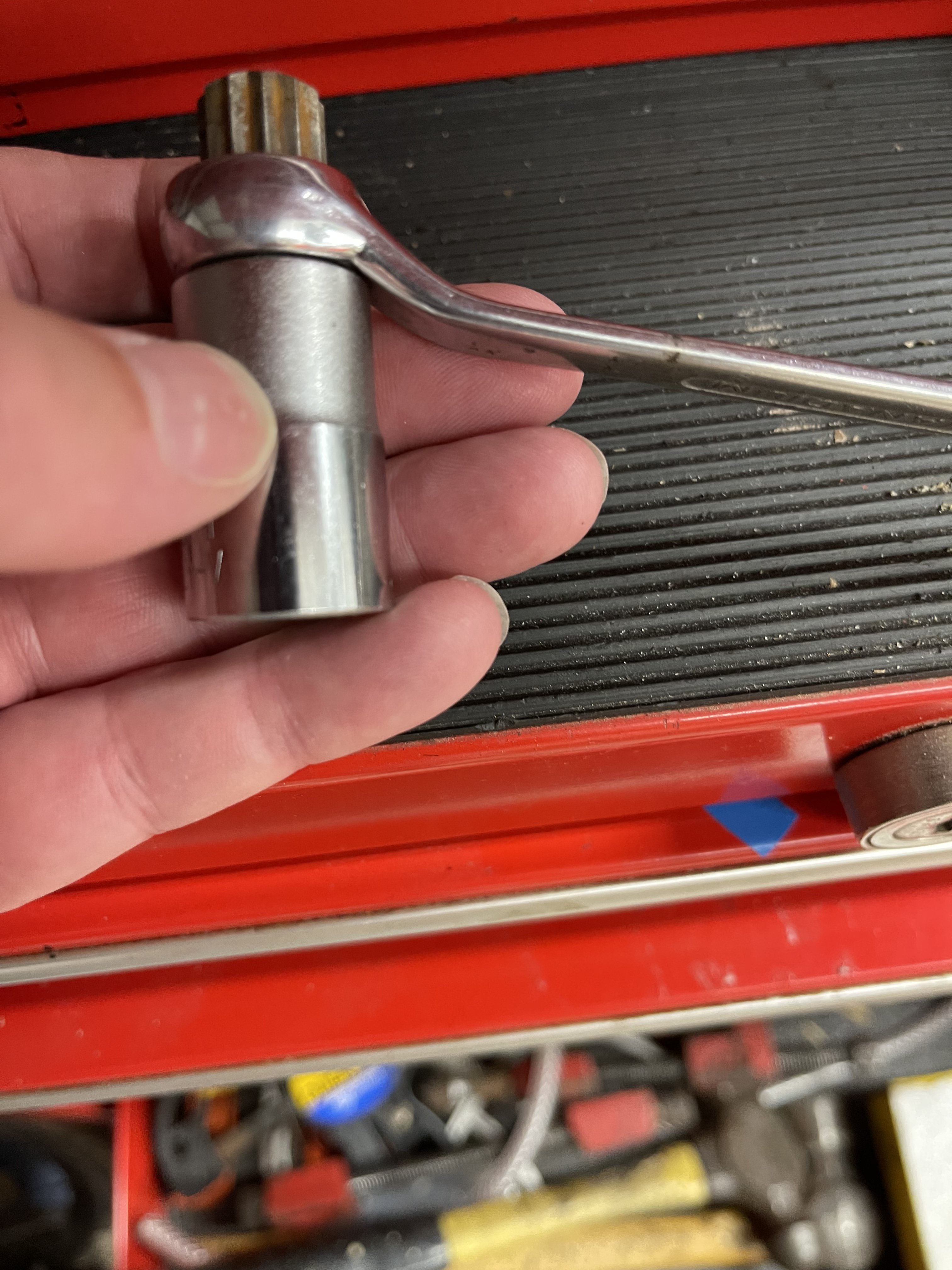

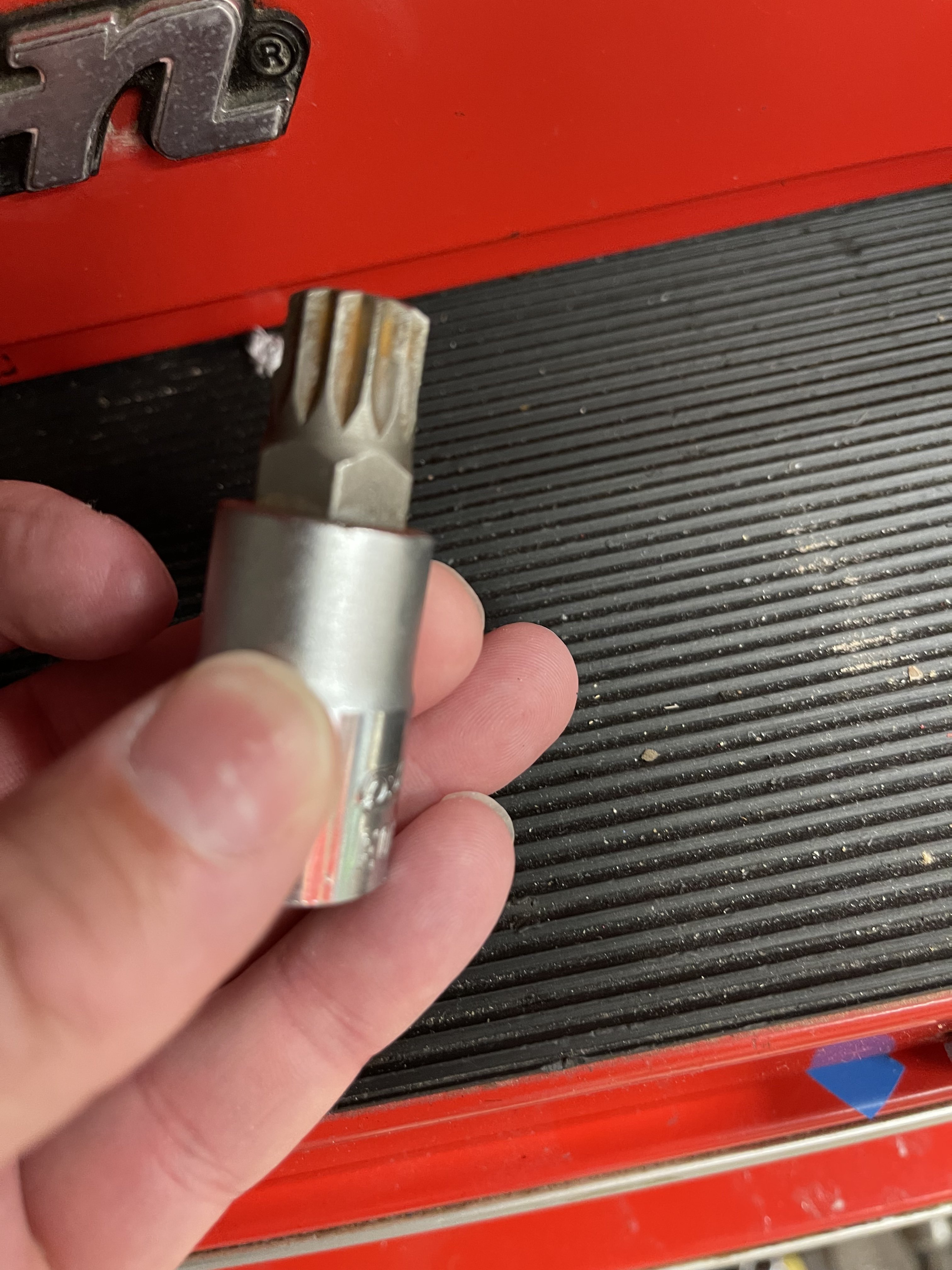

Yes the carrier bolts are a pig, I manage with a wobble drive extension and flex head ratchet
Also now use a 14mm spanner on the M14 spline
That's just the kind of tool I wish I'd had today and yesterday.  Don't know why the hell VW don't use hex headed bolts given the access issues.
