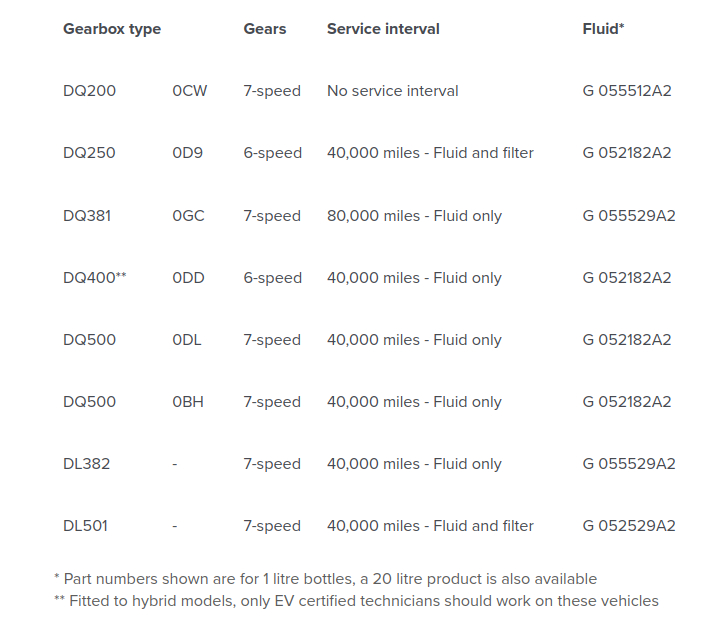

The DQ200 DSG did not need a (preventative) oil change.
 There are 2 oils for this 7 speed twin dry clutch DSG and they do not have a Service Schedule for oil changes.
People might well change the oil if they want to, but really need to know what they are doing.
Oil for the box & oil for the MCU.  (Wet Clutch DSG's are just 1 oil that does both functions.)

Why did you have the DSG oil changed?
I got this car December 2013. It has 264000 km . First hand. From the consumption display I see 8.5 /100 and I was used into seeing 5.5 6.2 . Its a dry clutch. I didn't change the oil of the mechatronics. I just change the 1.7 or 1.9 oil for the gearbox. Underneath the battery. Since the battery was out for an hour or more i am thinking maybe it lost the memory? 4 years ago I had a software update that Skoda gave for my car. Is it possible to lose the update?
The software update '34H5' on many DQ200 DSG's from 2013-2015 was started in 2017 and you should be OK with that still being there.
(This was after the World Wide Recall on 2013 on the 2009-2012 cars which was just a a Service Campaign in Europe, changing oil from Synthetic to mineral & a software update. 34F7.)
The DSG can reset and then settle to your driving style, as will the Maxidot and the fuel consumption once you have got back to your usual driving should then recognise the Average Consumption and calculate again when you fill up what your fuel use was in the short period before going to the pump.
