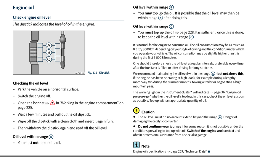

Always check your cars oil after someone services it, check before the engine is started and if cold and check when you get to your destination or the engine is up to temp. Then check again once cooled.
Different strokes for different folks, and differences in VW Group Owners Manuals.
http://briskoda.net/forums/topic/461969-correct-way-to-check-engine-oil-level-12-htp-51kw
Edited by e-Roottoot

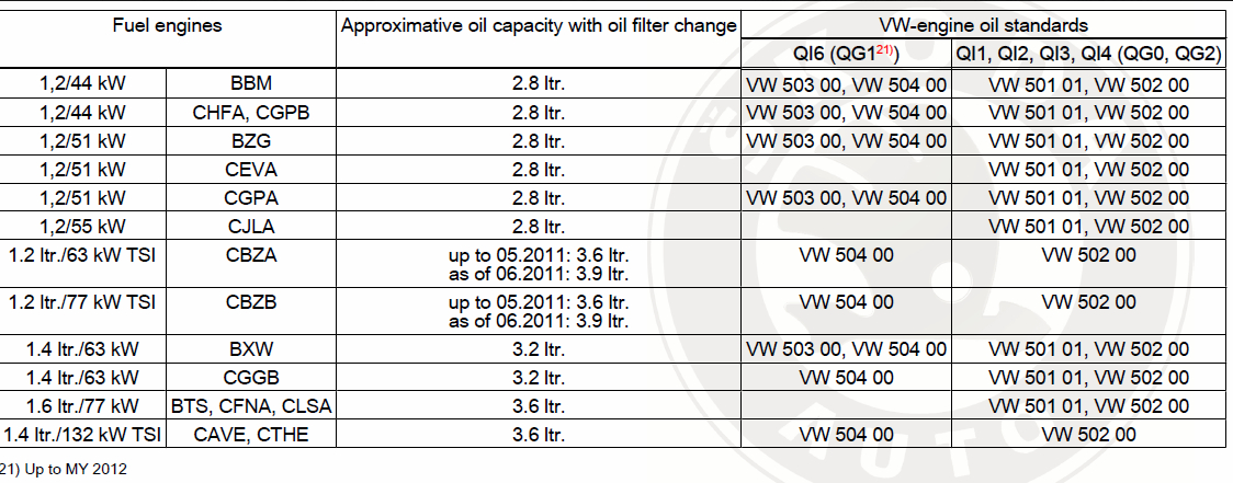

There were 1.4TSI / TFSI 132-136kW Twinchargers getting Official Oil Consumption tests and Techs that could not follow the TPI and did reports not knowing that 1 litre of engine oil at 15*oC is 857 grams according to VW.
Cars were getting new engines and leaving Dealerships Overfilled with Oil or in cases under filled.
So as much as some trust in Gods they need to at least know the basics on checking oil levels.
Also accept that oil is a coolant and if an engine is going to be worked hard or just do long journeys at least have the correct quantity of oil in, know you have before starting out.
Especially if you do not know if the engine uses oil or not.
Many say 1 litre difference between the high and low level.  Well not in all engines and some dipsticks are not the best to read.
In some VW Group engines with less than 4 litres oil capacity the level can be 1.5 litres low and no Low Oil Warning, maybe a Low oil Pressure appears first.
Then open the bonnet, do nothing, just shut the bonnet and a Low Oil Warning light can go out for 60 miles / 100km.
So simple to check Oil Level anytime you collect a vehicle.
Odd how those with a C&G in Mechanical Engineering or a NVQ can co-ck it up but many do.

A problem I've experienced is the location of the dipstick, and installation of the engine. My 1.2 htp BZG engined fabia has a massive tilt from left to right. Easily more than a inch maybe two higher at the left than right. There was a thread about this many years ago, some people had it, others had level engines.
The very long dipstick is at the left high end of the sump.
If I fill it to the top of the hatched area of the dipstick it takes 3.3 - 3.4 litres. Hot, warm, cold makes little difference. The official spec is it should take 2.8 litres. So after scratching my head for a few years about this, I finally decided on running it between halfway and two thirds up the hatched area which equates to around 3.0 litres.
Anecdotal, I admit, but it seems happier, a little quieter and more economical like that, it could be it reduces the incidence of crank counterweights thrashing the oil, which theoretically, in extremis, could aerate the oil leading to loss of dramatic oil pressure. Not to mention overloading the oil seperator and other things.
