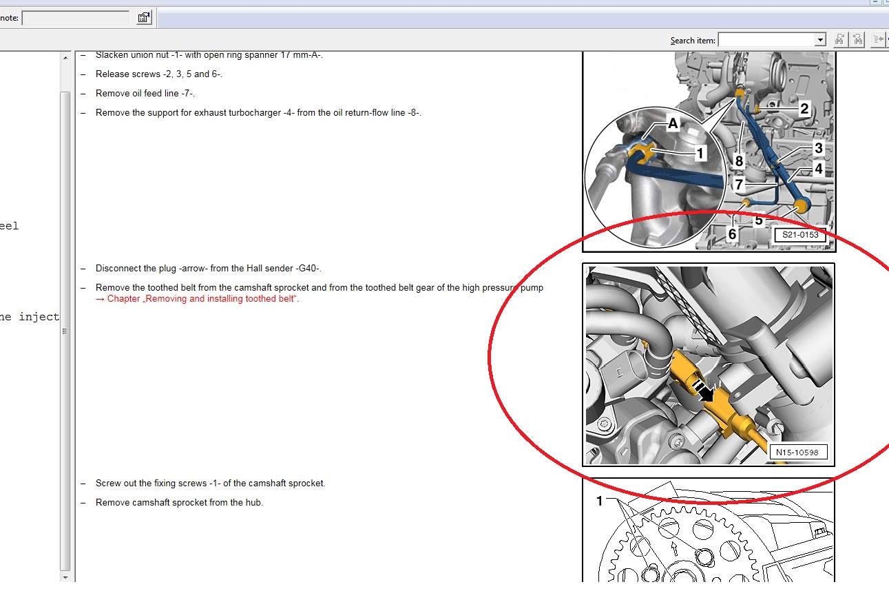

I think its here...
Hi thank you for this and your help, this has really helped narrow it down.  When it stopped raining, I had another look.  It looks like its one of the below two.  The one behind the oil filter looks promising, the only thing that throws me is its supposed to have a small screw holding it, and this has a rather larger bolt.
def don't think its the one near the oil filter, thats a 2 pin connector for a start.
The picture of yours I edited with the red circle, is the same area as the workshop manual I pictured and in the same area as your top image.
