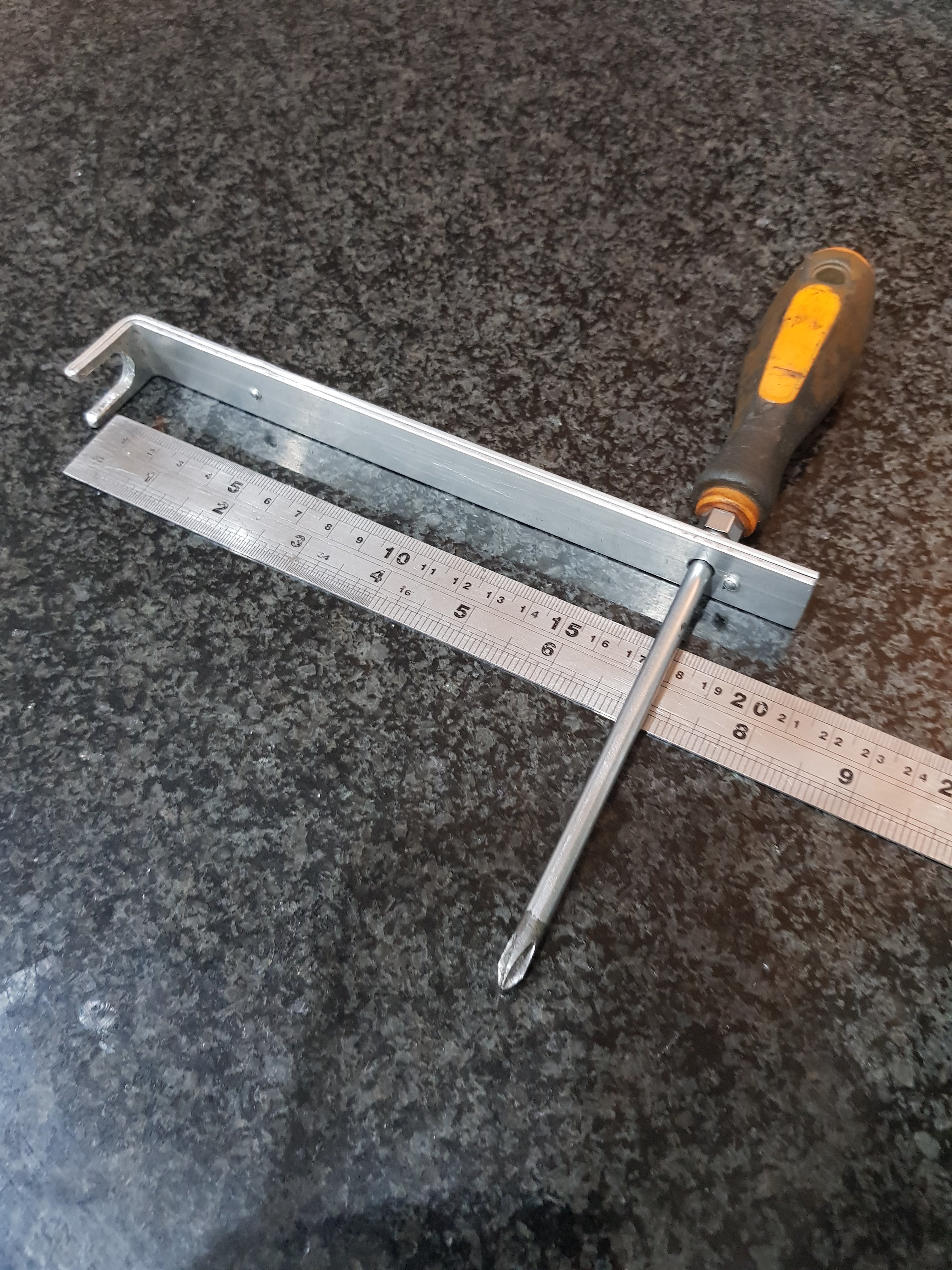

Having recently replaced my plugs I was reluctant to buy a special tool so made one myself from a 0.5m long piece of 20x2mm of ally bar.
Folded it in half, bent a 25mm 90deg angle on' the bottom then cut/filed a slot in it to fit around the top waist of the plug cover.
For extra pull I drilled a hole in the top to put a screwdriver through.
Did the job quickly and efficiently.
Saw a Youtube video of removing the spark plug covers using cable ties. Wrap cable tie around the shoulder of the cover, pull tight and wind the cable tie upwards around a spanner to pull of the cover.

I saw that too, seemed like more of a palava than making a tool!
