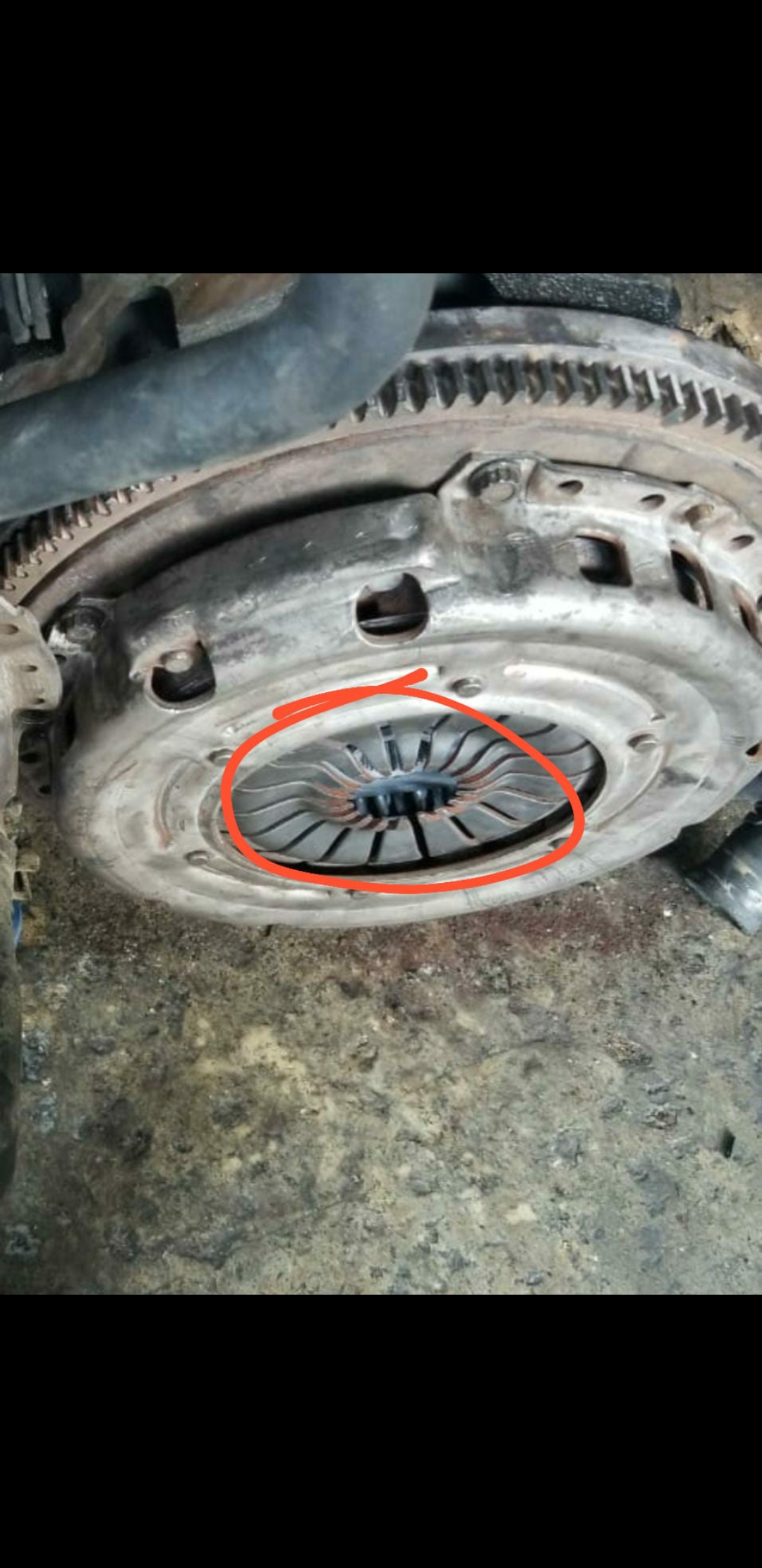

Is this normal?
The mechanic says it is too deep (the pins) and i say it is because it is a new clutch.
Is it too deep?
Is it true that it is too thick?
No, it looks new and unworn.
This is me against all of them.
They say if i leave it that way i wont be able to change gears.
I was looking everywhere which is the thickness of the clutch disk  because they say that clutch is too thick

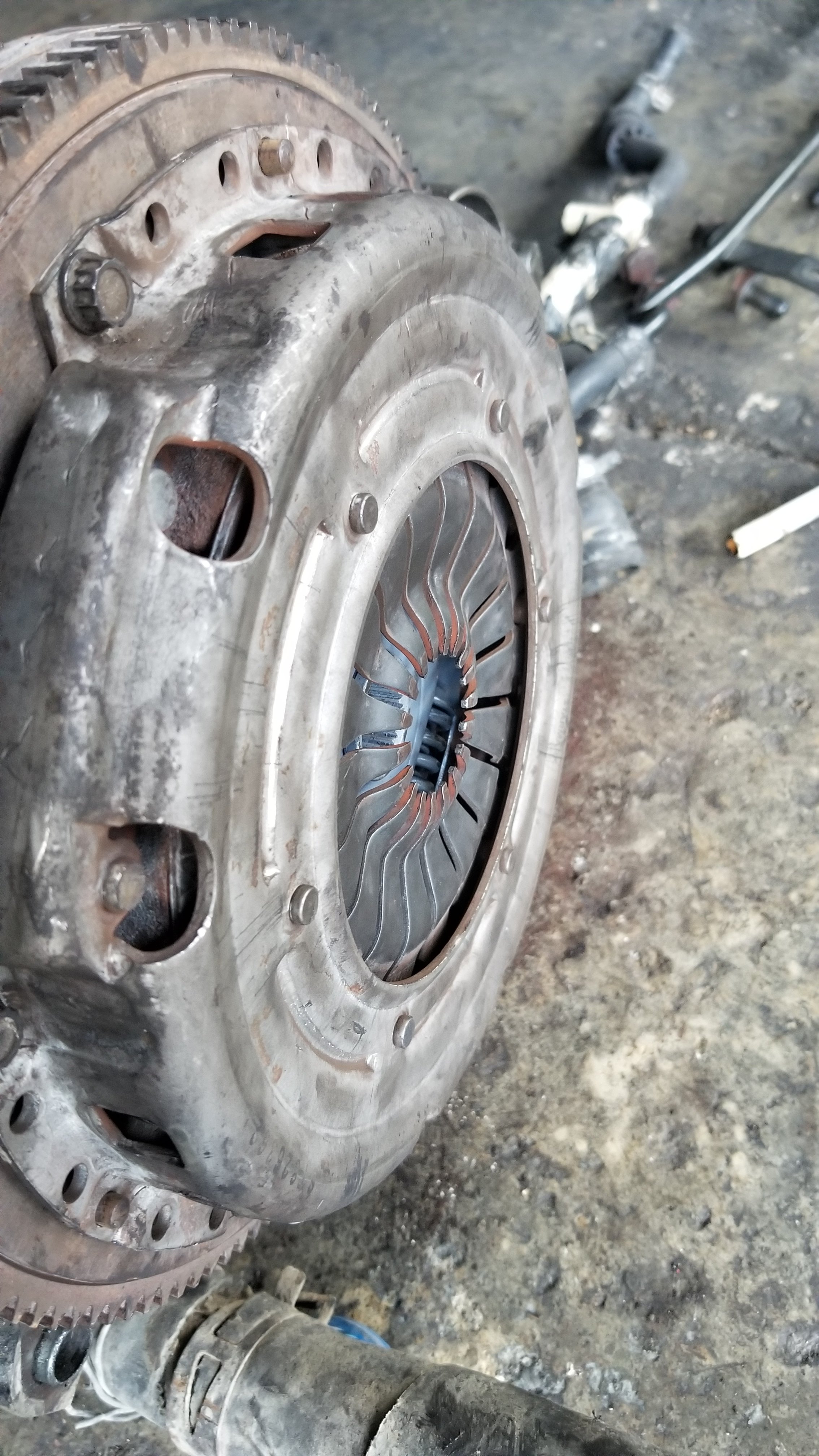

You need to mark up the photo with the item they are referring too as the only "pin" I can see is the pressure plate to flywheel dowel. Or are they talking about the pressure plate fingers.
 Do they just say "the clutch" is too deep, or are they more specific - clutch disc, clutch pressure plate - did they put the new/old pressure plate side by side, the only real issue in depth may be down to wear on the pressure plate fingers or even pressure plate face, but this would be negelegable.
Those pins (the diaphragm? )
Is what they say they are too deep.

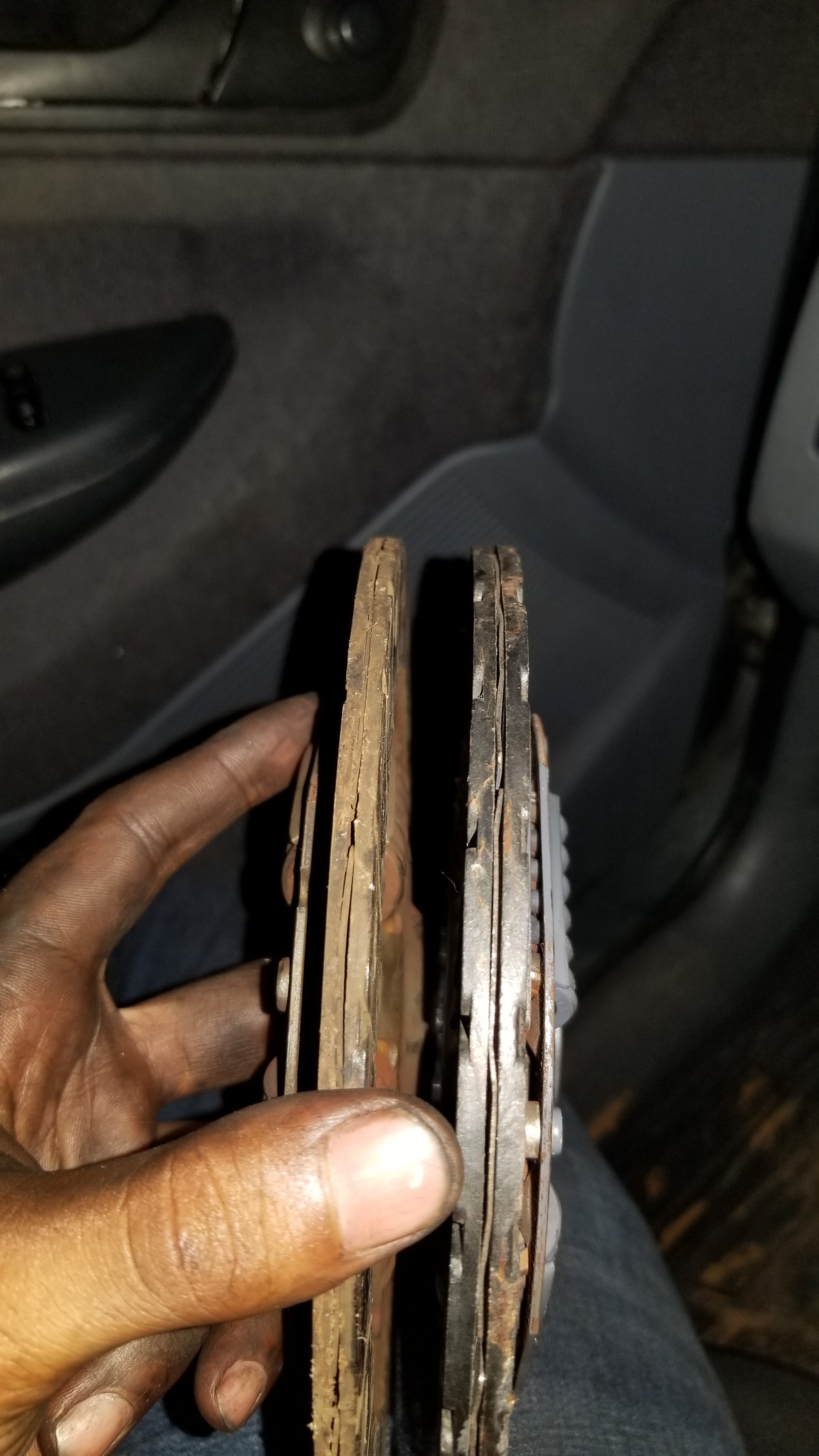

The repaired clutch disc is 8.2mm and the new original is 7.7mm
Could that be the cause?
I went to a clutch and brake repair shop they test the clutch and they say it is working good
https://youtu.be/NStfUwsccjg
0.5mm will not be a problem.
Those pins are called spring fingers and together they make up a diaphragm spring which acts on the pressure plate, how can they be too deep?
Ok, i got it.

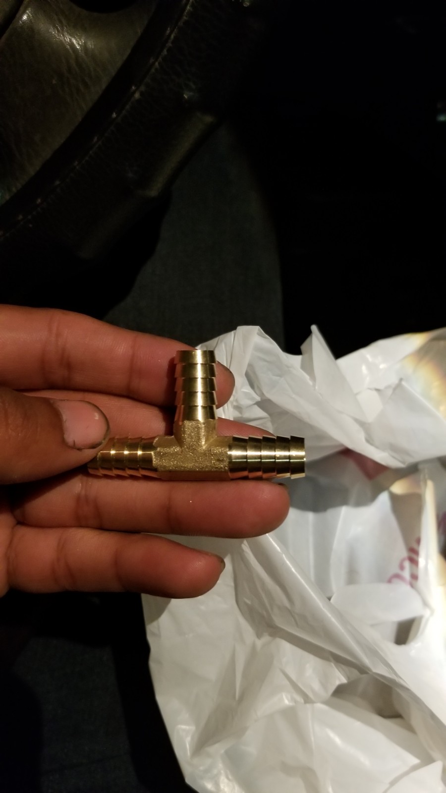

I accidentally broke twice the plastic T used in the cooling system.
Can i use the metal one instead? (I think it is brass.
No problem with corrosion electrolysis, static or that sort of things?
No, that would be fine.
Great, thank you.

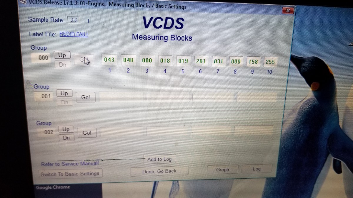

The engine is already installed and working, the mechanic say the pump is right but id like you to check these parameters.
