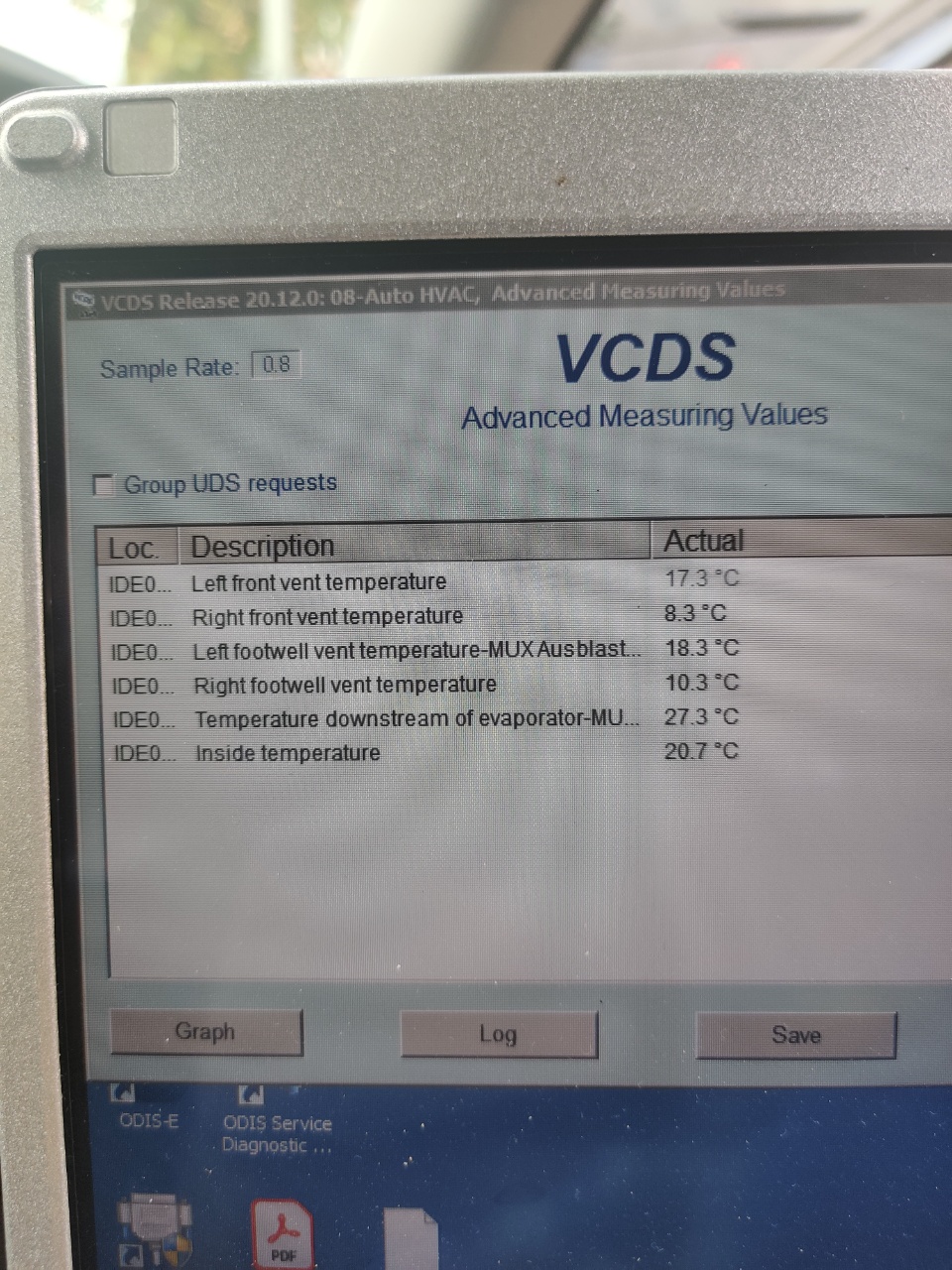

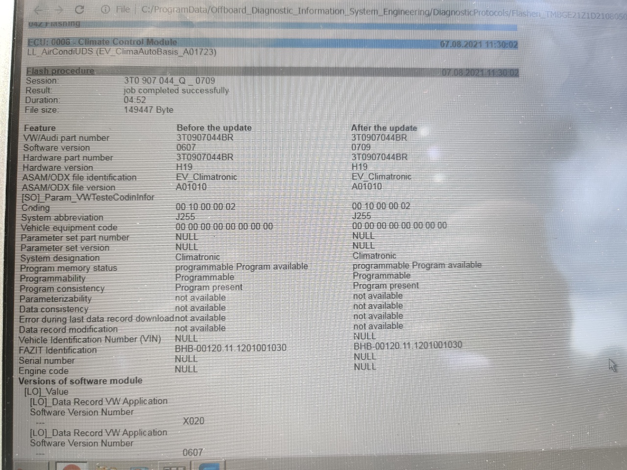

VCDS came out, no faults found. Recalibrated her flaps (hehehe), no difference.  I found a post from Russia ( https://www.drive2.com/l/509495822321189043/ ) that suggested a software update solved lots of strange Climatronic behaviour, so out came ODIS-E and I updated it from version 0607 to 0709.  If anyone attempts this themselves, it throws up lots of error codes on just about everything, lit up the instrument cluster like a christmas tree, and takes a solid 5 minutes to flash what is a tiny file, but it's normal.  Anyway, I reset all codes on all modules, recalibrated flaps, again - no difference.  Measuring blocks confirm a lack of any air conditioned air on the passenger side based on the vent and footwell temperature sensor outputs, and that's with both sides set to the same temperature.  Everything seems to be behaving properly in terms of moving when its supposed to in terms of positioning feedback in measuring blocks.

When you recalibrated her flaps (oo-er missus!) did you notice any difference in flap positions between left/right/hot/cold (this is getting worse)? As I recall the range is from 0-128.
It's possible the electrical connector on the affected side has oxidised or the motor/plastic gear has jammed/broken.
Make search on here as a few years ago there was a report of no cooling on the passenger side being caused by low gas in the air con. As you have all the software tools perhaps there is clue there?
I think pikpilot may be correct, a regas solved a similar problem for me on a 2007
