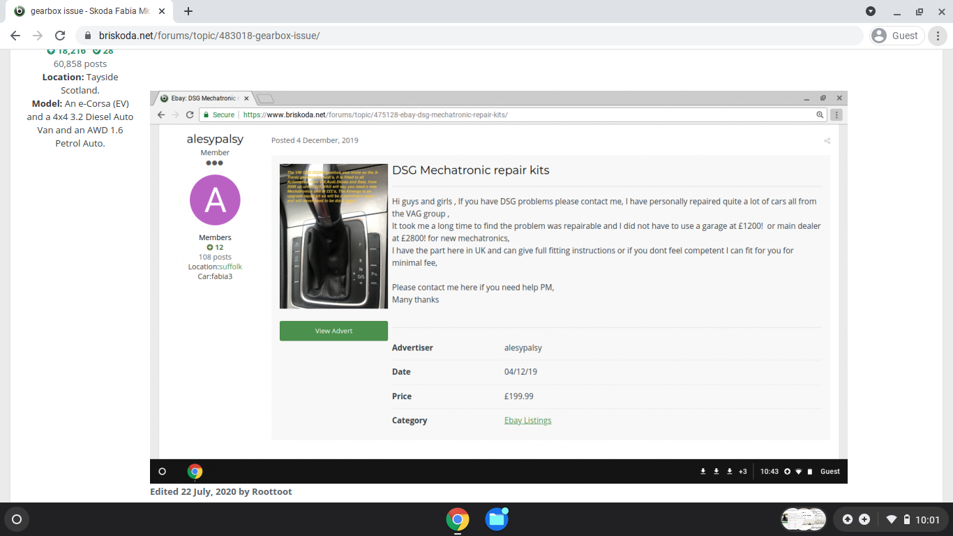

http://briskoda.net/forums/topic/444617-7sp-dq200-dsg-failure  They can have all the gear and still little ideas or qualifications / experience.
2018 the cost was £1,750 for Diagnostic & a new MCU fitted.
It needs someone that fixes DQ200 DSG's, so they can maybe get reconditioned Mechatronic Control Units's, or not change ones that are not the fault.

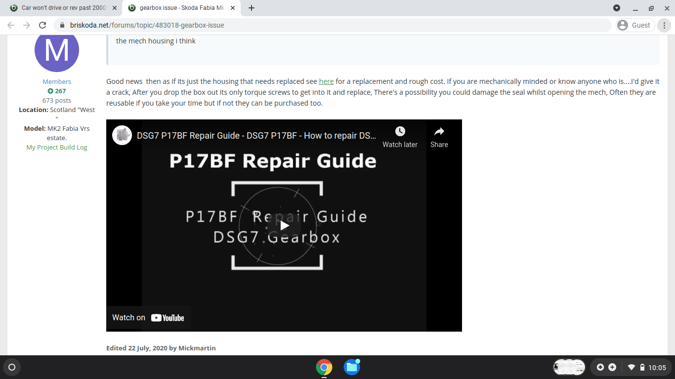

Does your car have a sticker in the boot showing that '34F7' was carried out since early 2014.
The Synthetic Oil changed to mineral and a Software Update.   Should have date done and a dealers stamp?
http://briskoda.net/forums/topic/483018-gearbox-issue
