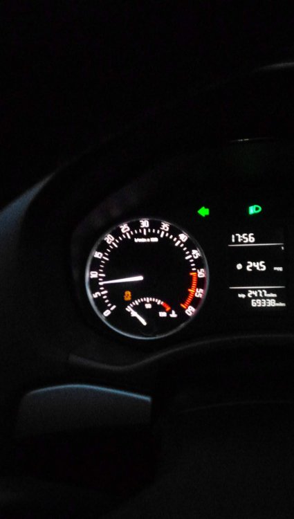

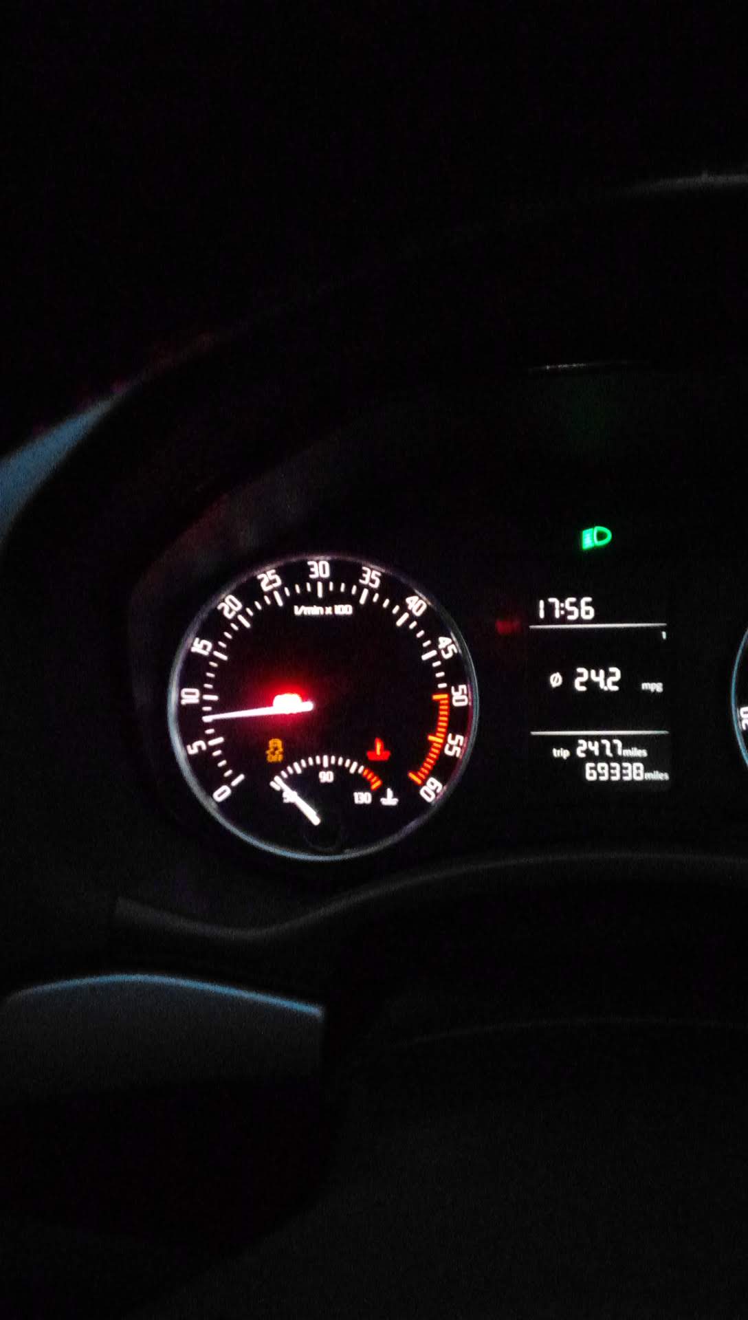

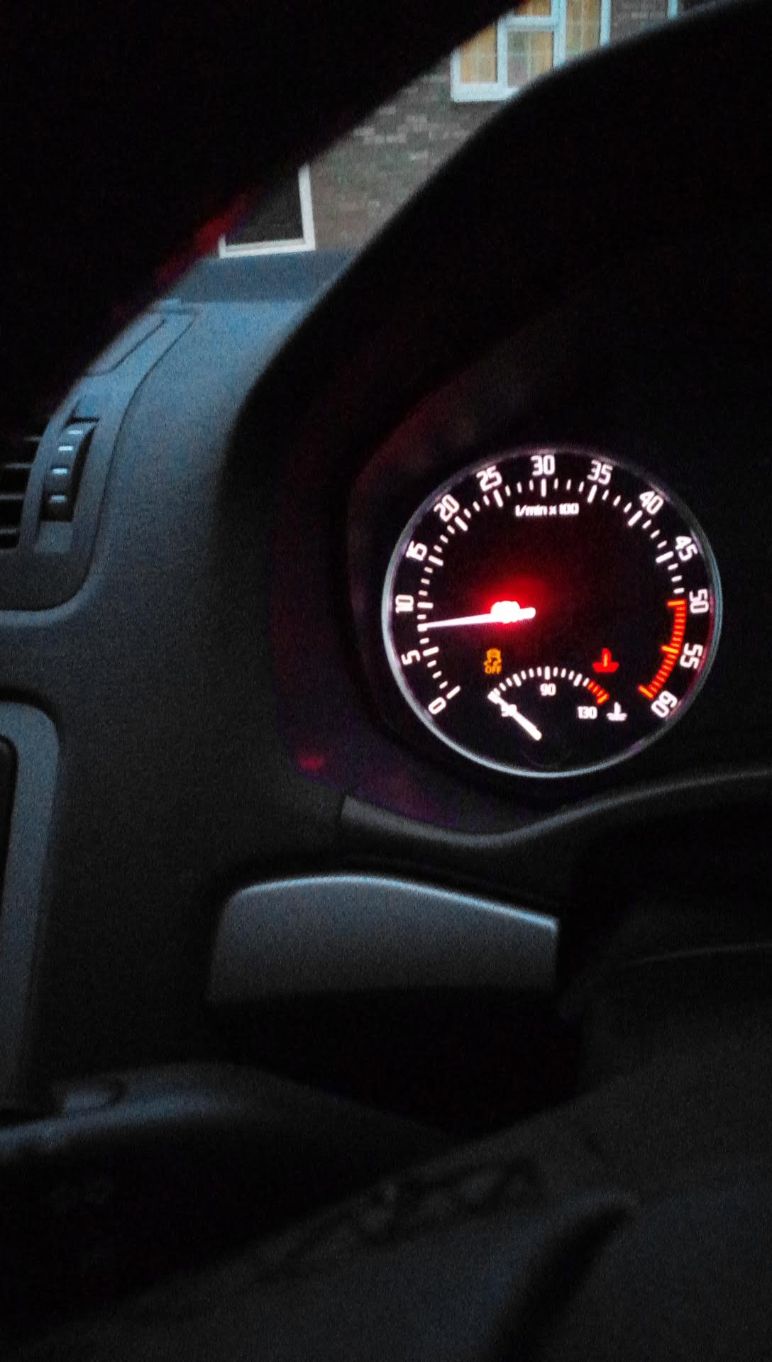

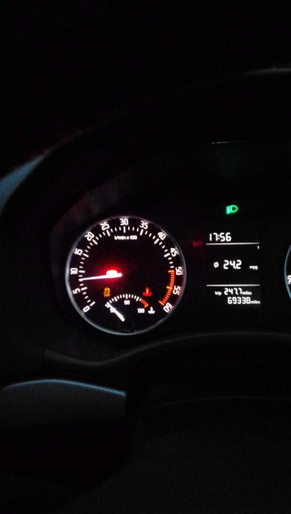

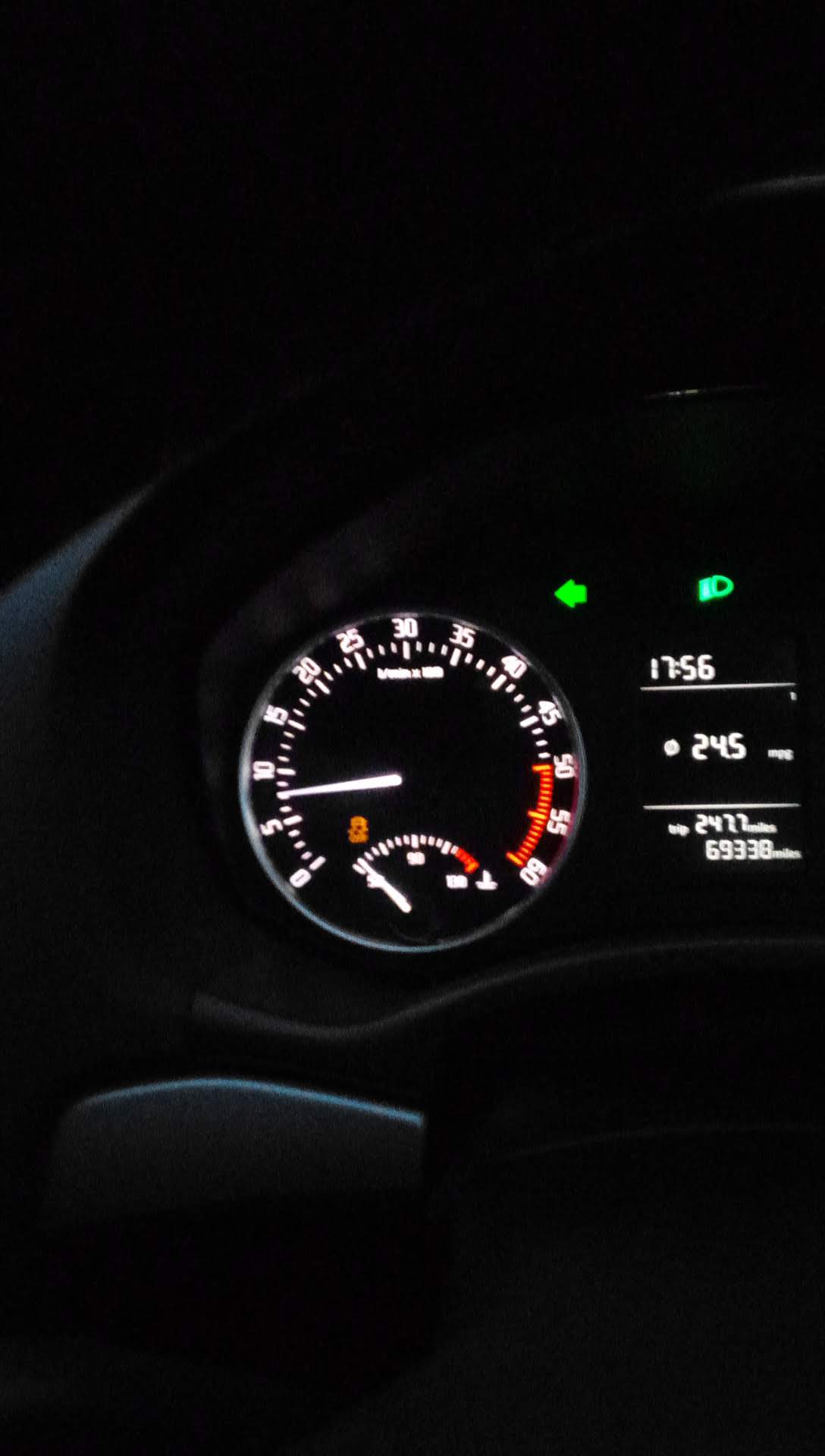

I had a similar problem earlier this year after the car was stood unused during a period of nearly two weeks of rain.
Several other people had reported similar random dash board warning lights. In all cases the clue was that the faults lights changed depending on what else was switched-on as shown in attached photos.
I fixed mine by leaving all the windows open on the first sunny day. Likely to have been moisture condensation. No problems since then.
