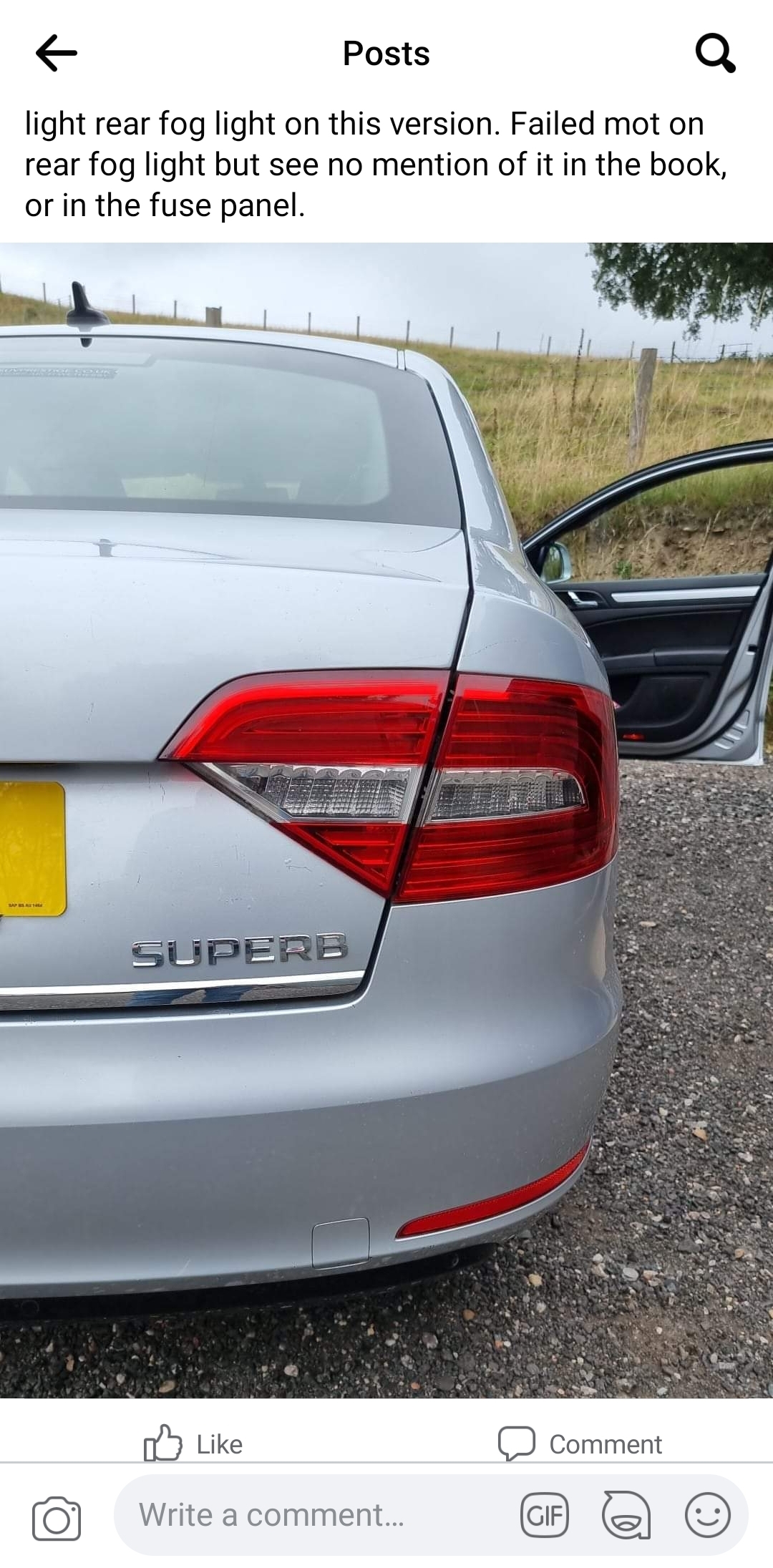

does anyone have any insite as to why the fog light wouldnt work. i cant find a fuse for it in the manual or online, its a 2014 and i believe its all led on the back.
it just failed the mot on it, thats all...bit irritating really

Just checked on mine(also an led facelift twin door)   and the fog light is on the right cluster - could this be the usual twindoor wiring fail? I suppose you'd expect a bulb fail warning but not sure if the led fog light is covered by that?

I think it's the angle I took the photo / daylight - the rear LED sidelights are on when the rear foglight is on:-
