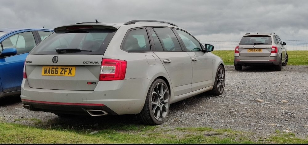

Here's my experience with lowering my VRS...
I'd definitely go for a VRS if you can. Much better looking and even though I've never driven a 'normal' one, I imagine much much better performance aswell. Economy is amazing too, I've averaged 47.6mpg in my nearly 2 years of owning mine, and it's remapped. I took this on the weekend of mine Vs a 'normal' one :tongueout: Not that it's all just about looks of course...
