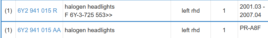

I've tried in vain to find some way of finding an online source, so any help to find one would be appreciated.
https://skoda.7zap.com/en/cz/
