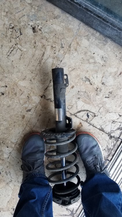

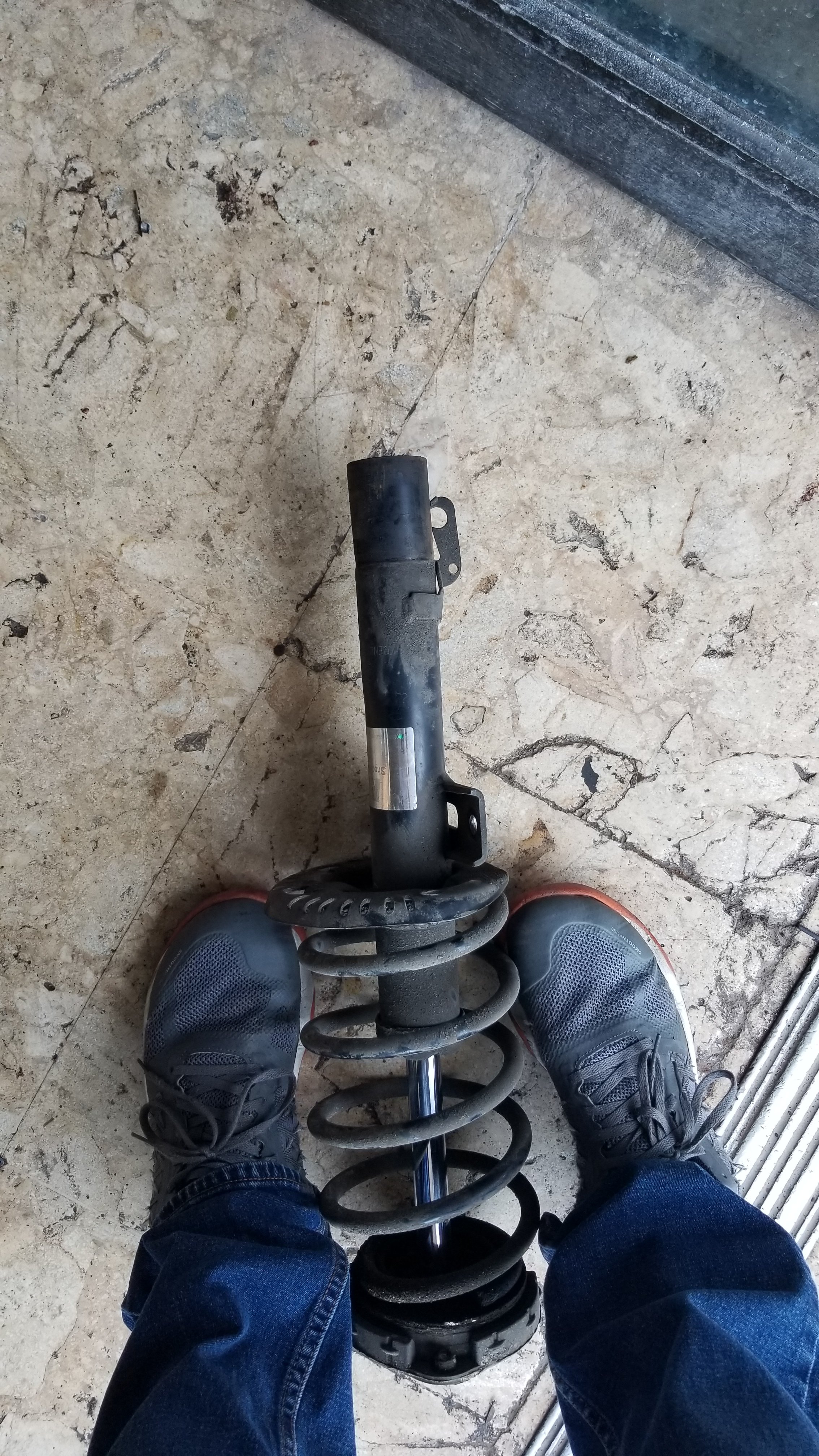

I can not find the reason of the negative camber.
Hi.
Since i got this car i noticed a negative camber and a lower height  in the left side (driver, side LHD).
Shock is not bent, neither the hub, neither the lower ball joint (both ball joint the same)
Driver sitting on the left, loads the LHF spring more.
Either that or the spring is broken, which is a pretty common problem on VAG group cars.
I have heard that, but...
I think there are two problems.
The spring could be an issue,  but enough to cause that camber?, it is just some centimeters lower than the other side and the other side has  ot ghat camber even when there is loat there
Shock absorber  was bent
