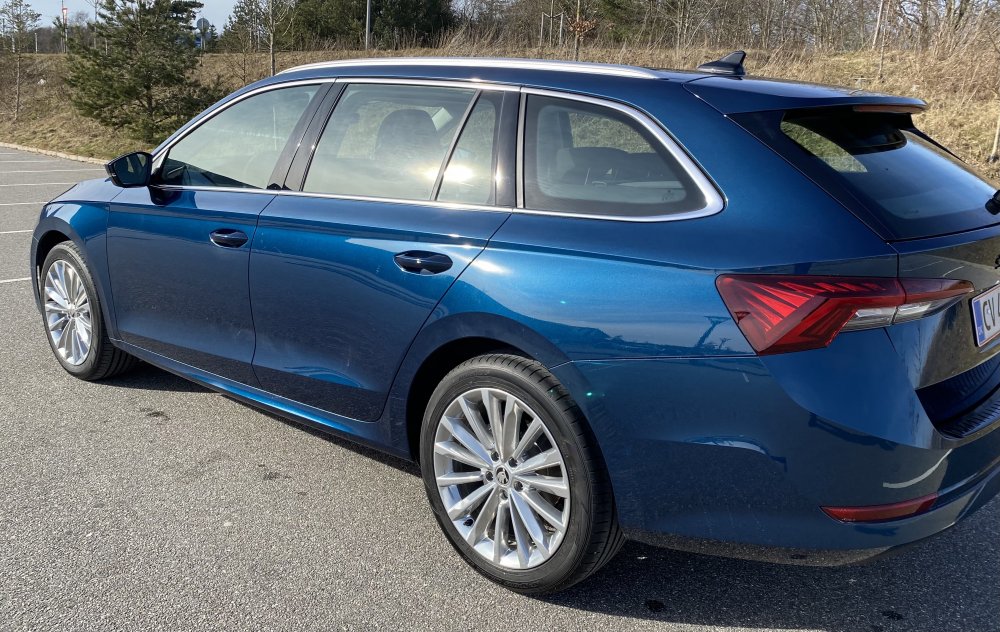

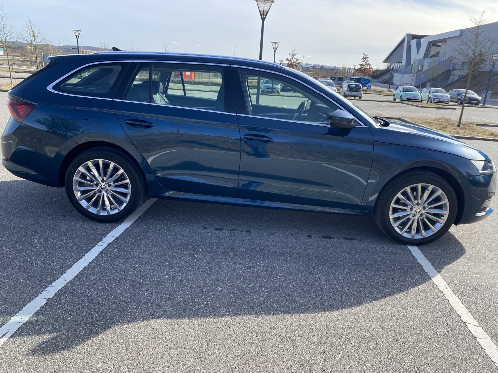

7.5J or 8J for 225? Example pictures?
So i'm thinking about winter wheels. Its going to be 255/45/18. But what wheel size and perhaps ET42 or stock ET48?
Would like to see pictures of 7.5" and 8" with 225 tyres.

Oh yeah. 225/45/18 is what i ment.
At the moment i'm getting 3rd party rims which i'm struggling to device between 8" or 7.5". If it would be 7.5" i think i might go with ET42 to make them stand out abit more.
Just wondering if someone has gone with 8" and might have some examples.
235/45/18 ET 42, a bit over size but good looking. Car was returned 3. month ago.
