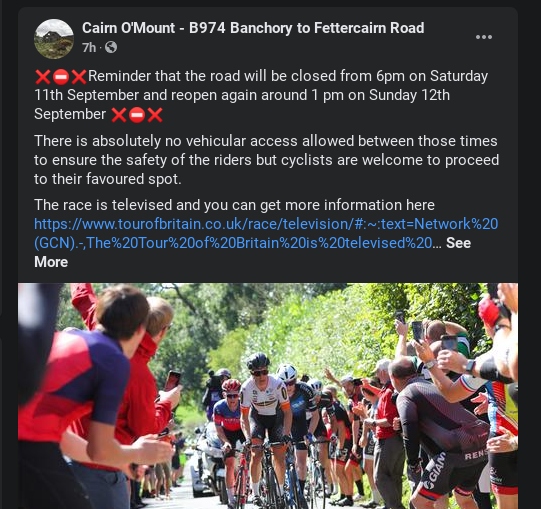

B974 Cairn O Mount closed 6pm Saturday night until the Tour of Britain goes over on Sunday.
Heading up on Thursday 16th to get pictures of the Scottish Malts 2021 cars coming south from a start in Aberdeen.
