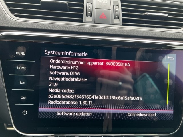

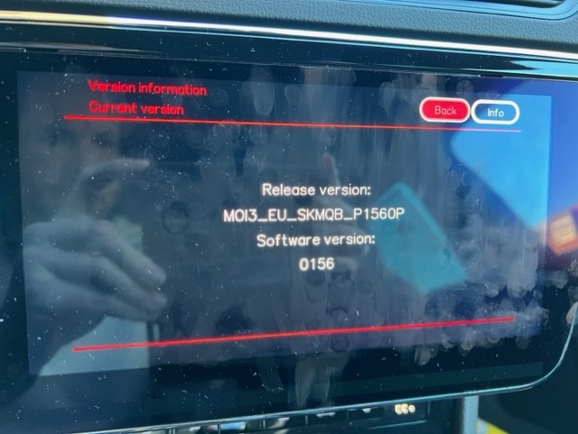

Initially it had the base firmware: 0156 (language is Dutch btw)

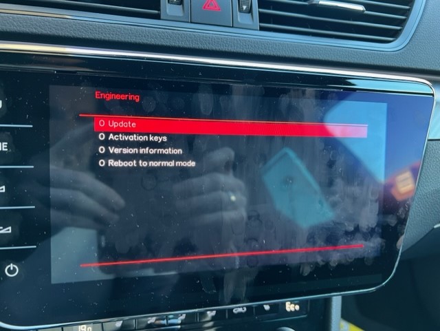

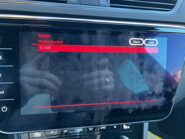

- Create an USB C (or A with C adapter) including the triple update. Extract the base file and put it on a disk. Format as exfat.
- Go to the service menu (columbus -> hold menu button)

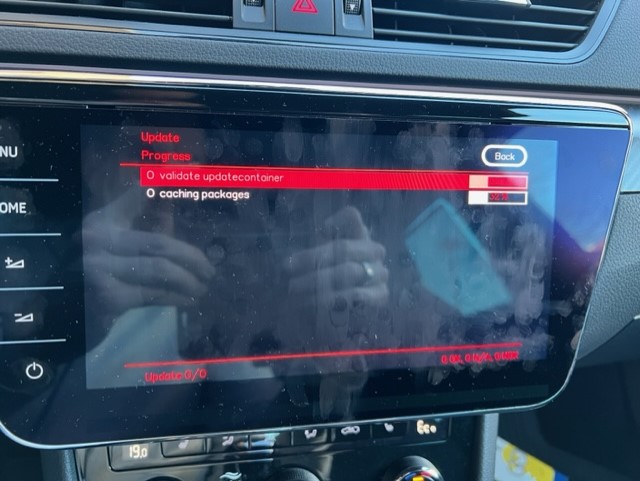

Press update:

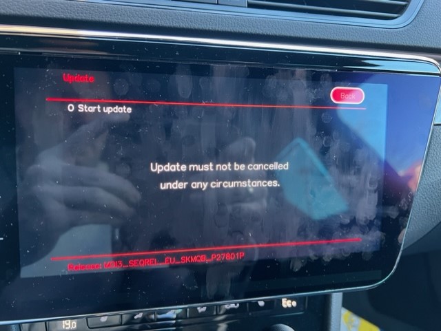

Notice the message:
Keep your ignition on or use a battery charger. This update takes 45 minutes... in case of IV just enable the car and the battery will be charged during the process.

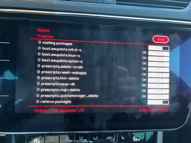

Updating starts. It first reads the packages.
After several restarts (don't worry) the sequence below goes up to three. (3 steps) after that you get a fresh reboot:

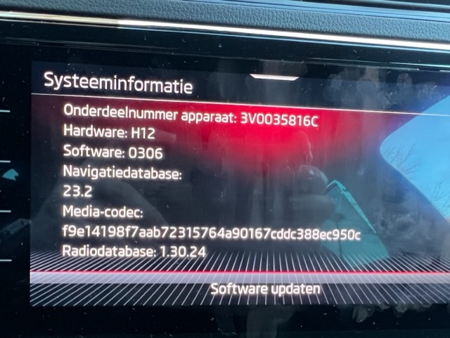

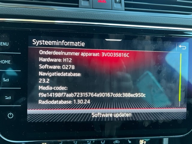

Notice the difference in devicenr (onderdeelnummer).  First step done. Up to the 0306, same procedure:
- Prepare usb
- Service menu
- install update

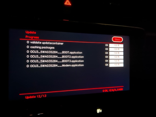

Skoda connect is a different story. I can't find out why it's not working (right now) already updated the OCU to 0143 (thanks Varooomer) but it is not working like it should. Shop is grey (no icon) and juridical stuff the same. Profile can load but not saved, annoying.

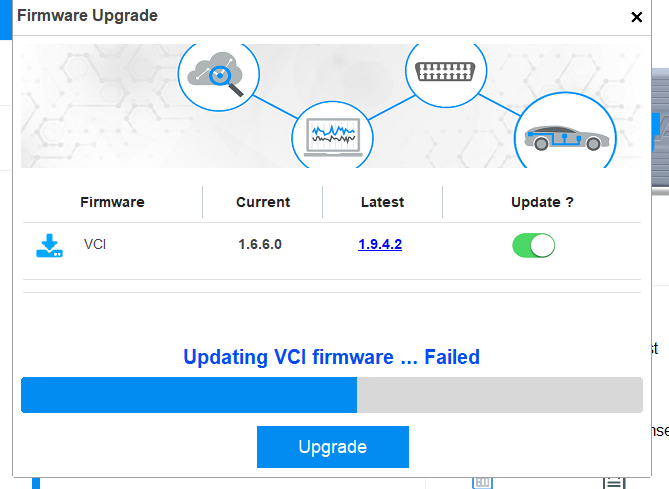

Well, time for an update 😉
Everything works now! Thanks to varroom, I also updated to 0324 with a sidestep to 0308 (0306 —> 0308).
The main problem I had, was updating the OCU. Somehow, it went wrong and the parameters could not be updated automatically. Long story short: fried it 😉 they replaced it and now everything works as it should.
Long story short: I you are on 0278 already, updating is a straight proces. No need for odis stuff etc. If you are on 0156, a lot more coming on your way.
- Need to update parameters via odis for infotainment and ocu
- try to find a friendly person on a dealership who want to give to the activationcodes on the excel sheet for the predictive navigation so you can activate the FEC in odis (according tpi)
- You need a good vci…
- Have to build up odis knowledge when you don’t have it (not hard but very less info or youtubes online..)
- Odis online required
Should I do it again?
Yes, the system is more responsive, new screens, working apps (news, weather —> not relevant but now they work). Quick startup. The infotainment of my car works now like I expected when I buy such a car…
Some notes:
Somehow dealerships are not familiar with this stuff. If it aint broken, don’t fix it. Most of the time they hold the power button to reset the unit 😉 They aren’t aware of new updates, it’s not a proces on maintenance etc.
Besides that, I can’t remove my above post: it was a result from a chinese VCI clone, avoid it 😉
