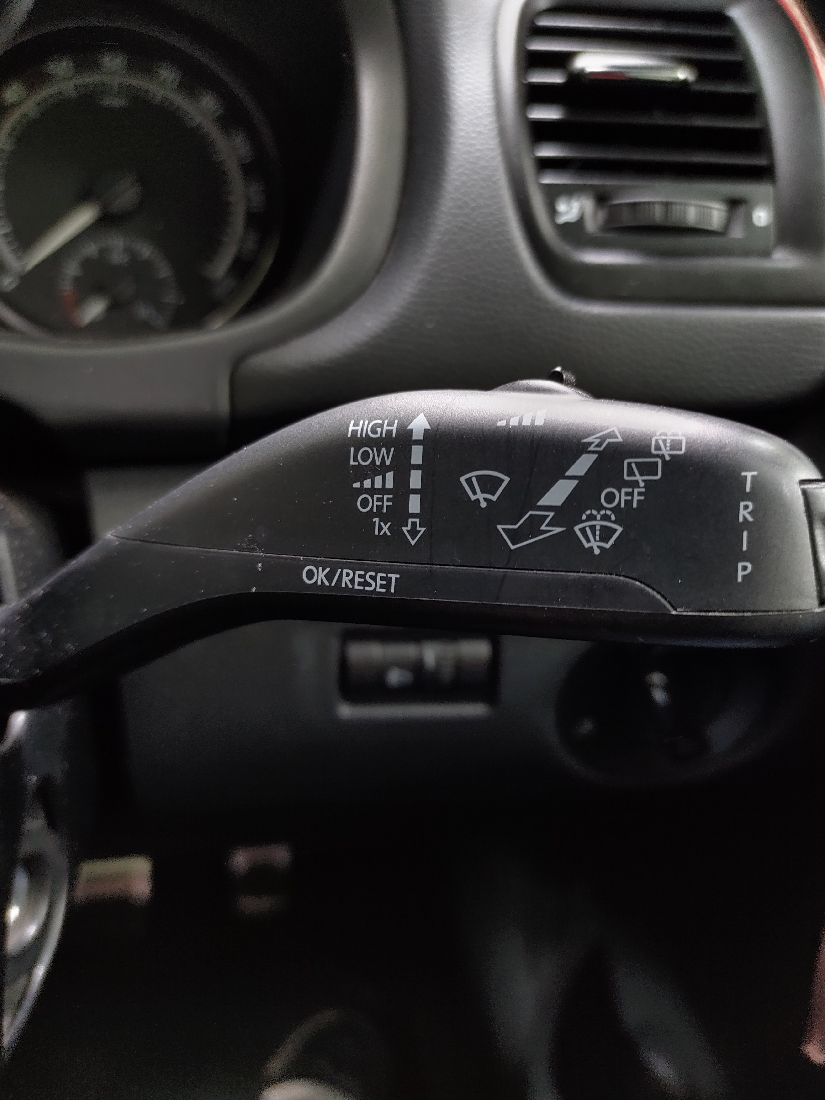

I'd be more certain if you'd written in English or French, or even Flemish! The mileage to next service count can normally be reset by switching on, and holding the reset button on the underside of the rh stalk for 5 seconds.
I'm speak french.... I dont undestand the button you tell me to press. I dont have board computer. Just 2 touch one 0.0 on the right and one for clock adjust
The advice is to look under the windscreen wiper stalk on the right hand side of the steering wheel (not the Speedo clock) and you will see a button that says ok/reset. Press and hold that button

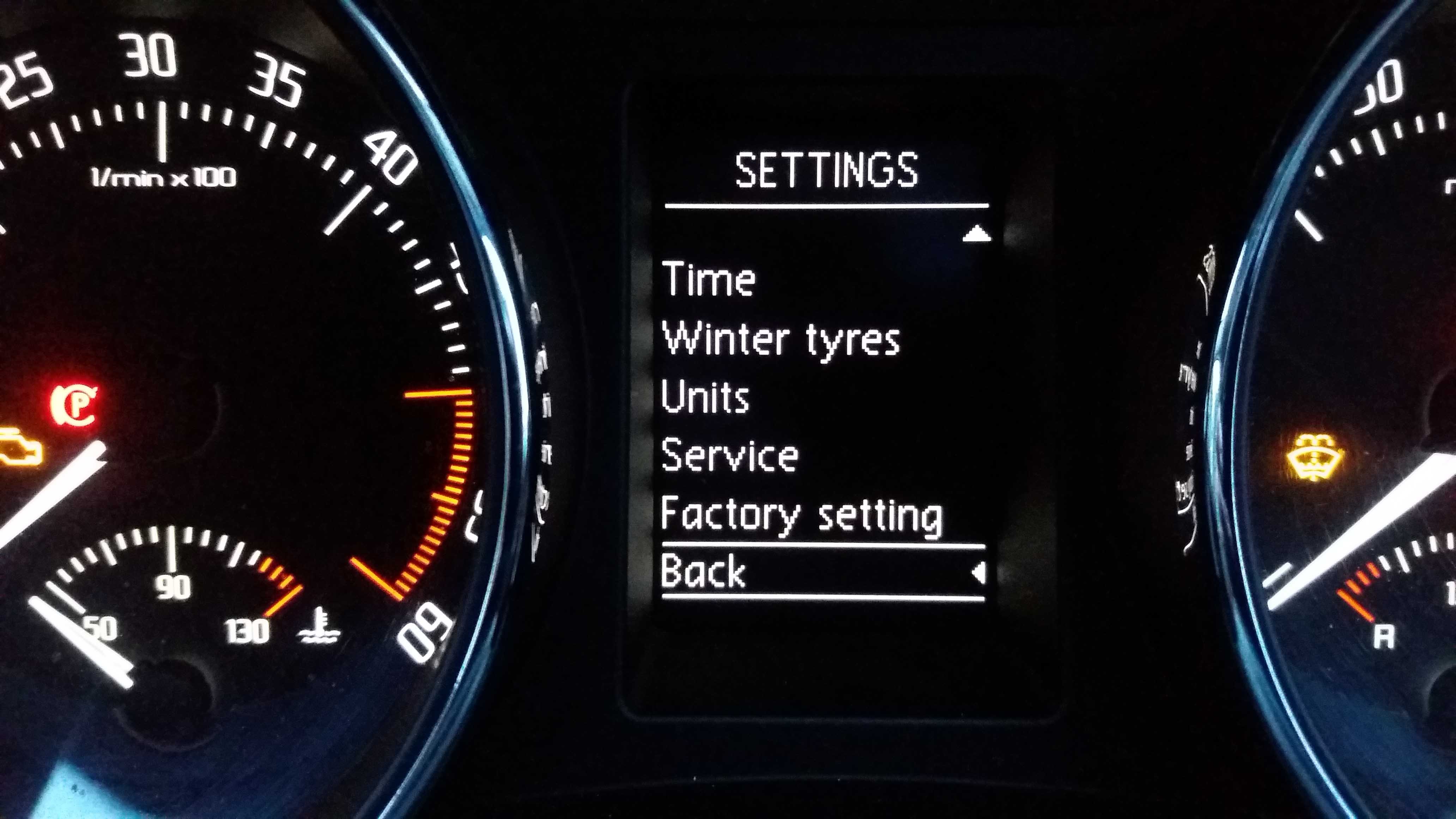

The Maintenance reset is there in the Menu if you have Maxidot and the car is set for Fixed Service Intervals.
The end of the stalk on that kind changes choices / settings, button can select.
