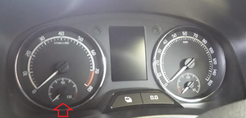

I don't think any Fabias have an oil gauge, other than some that may have a digital oil temperature readout?
I speculate that you actually mean a coolant temperature gauge, as shown in the image below?
Changing instrument clusters may be tricky, with coding needed, so I suspect it'll be more trouble than it's worth.

That higher spec gauge is called a "maxidot" display. Probably is possible but would be easier to use an app called torque pro like I use, or put an auxillary gauge on yourself.

Nah, just replace the default gauge set with the Maxidot earlier discussed. Having my phone connected to the OBD port, whilst practical, I don't really want to have my phone on the car at all times. Mounting a gauge to show me the coolant level is also a bit annoying, because it might affect its resale value (if I decide to sell it) and it feels like an unnecessary job. Replacing the gauge sets from this:
Ceasuri bord Skoda Fabia 2 din 2011 5J0920810E 5J0 920 810 E | Dezmembrari  Automobile
to this:
feels a bit more elegant and it might be easier to do. One such set is about 50 euros around here, maybe I'll get to 100 euros with the work a specialist might do to change the odometer to the correct value.
