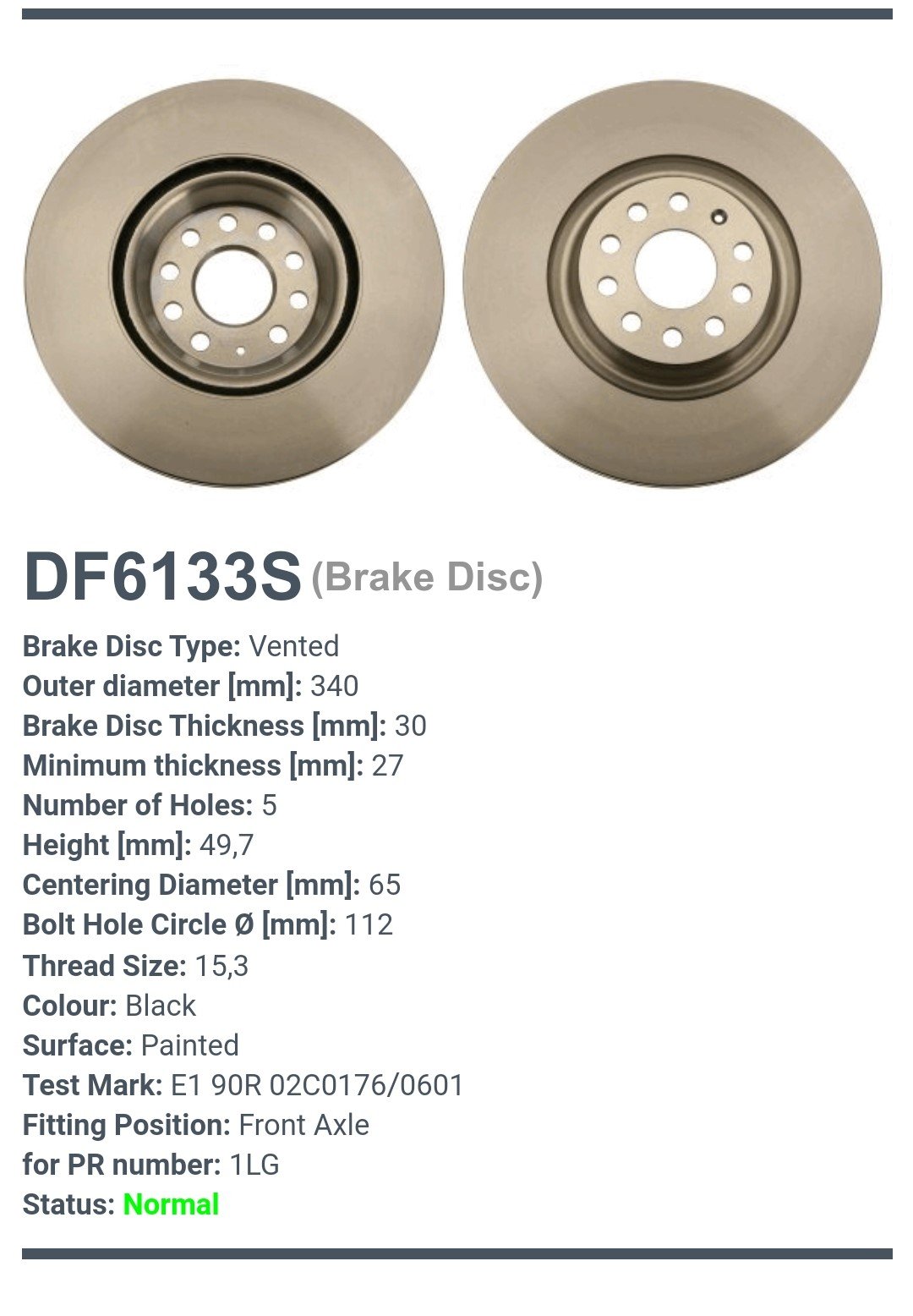

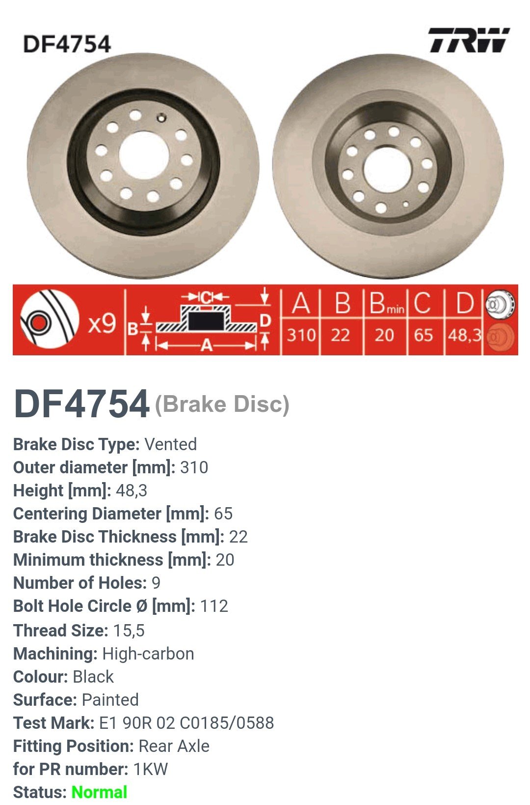

I have just had a look at TRW and both the 312mm and 340mm discs do not show as high carbon, how did you find out yours are?
The 340mm units (DF6133S) in the screenshot attached have no mention of it in the specs, but other discs they list it as per the other screenshot.
