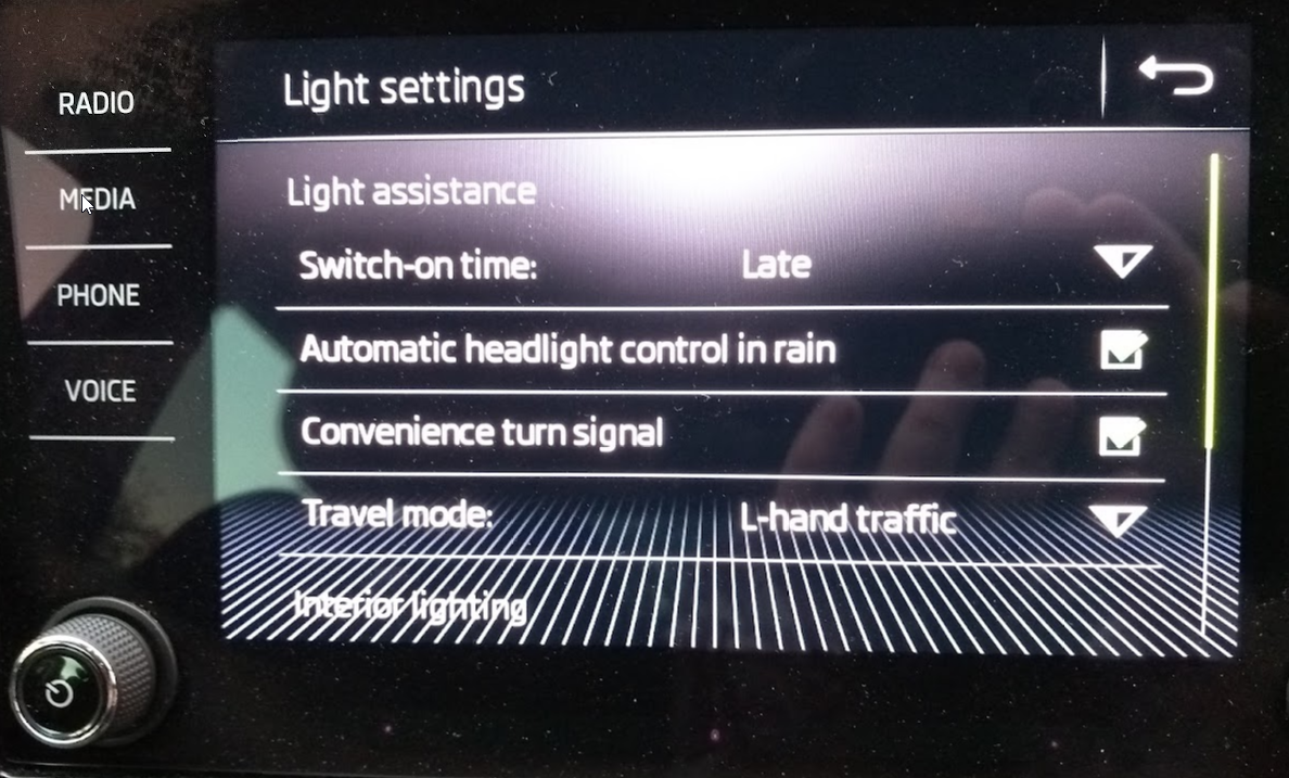

9 minutes ago, Berisford said:
Mine doesn't have that setting:

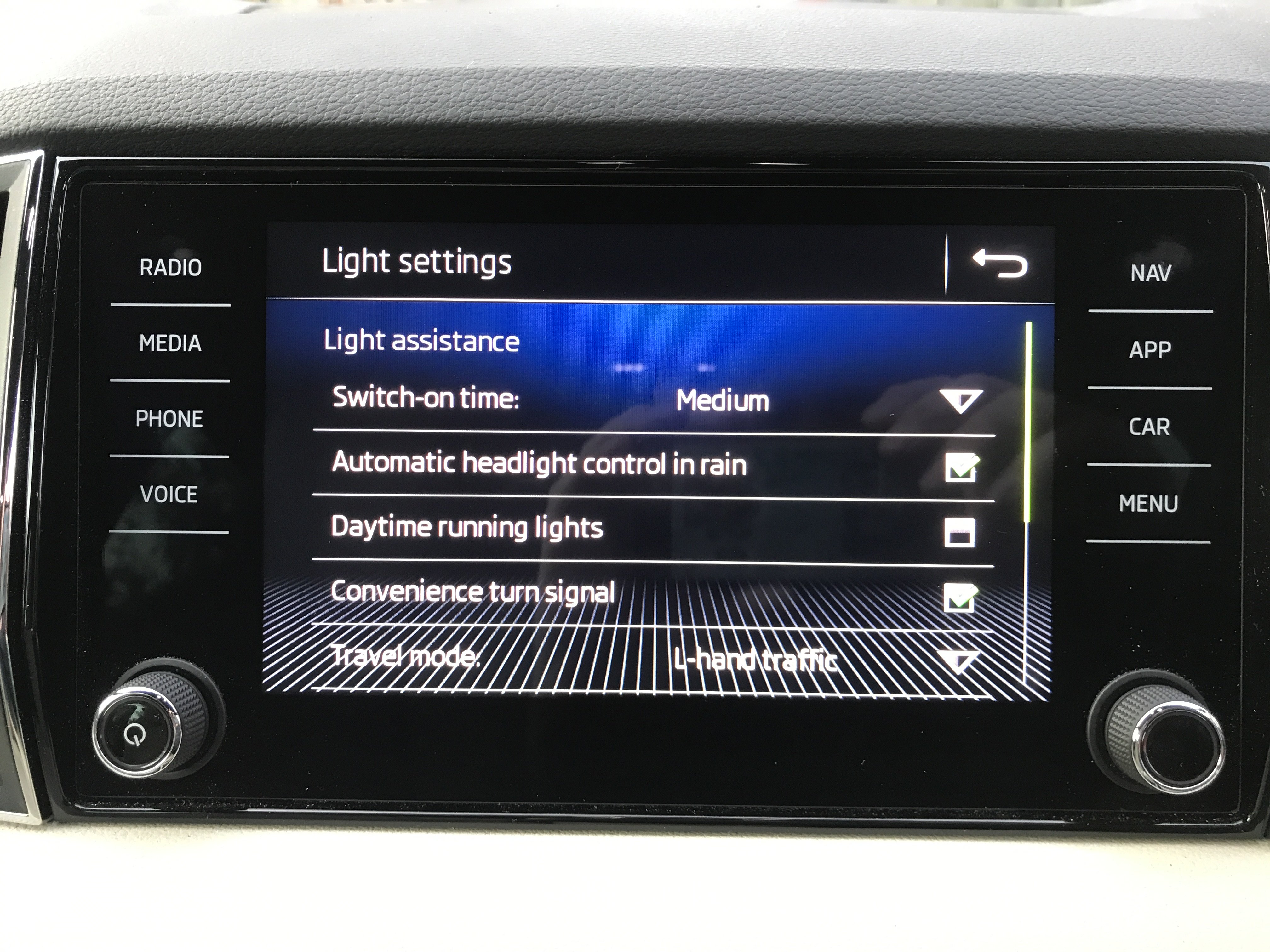

Sorry - my image got a bit lost so here it is again 🙂
