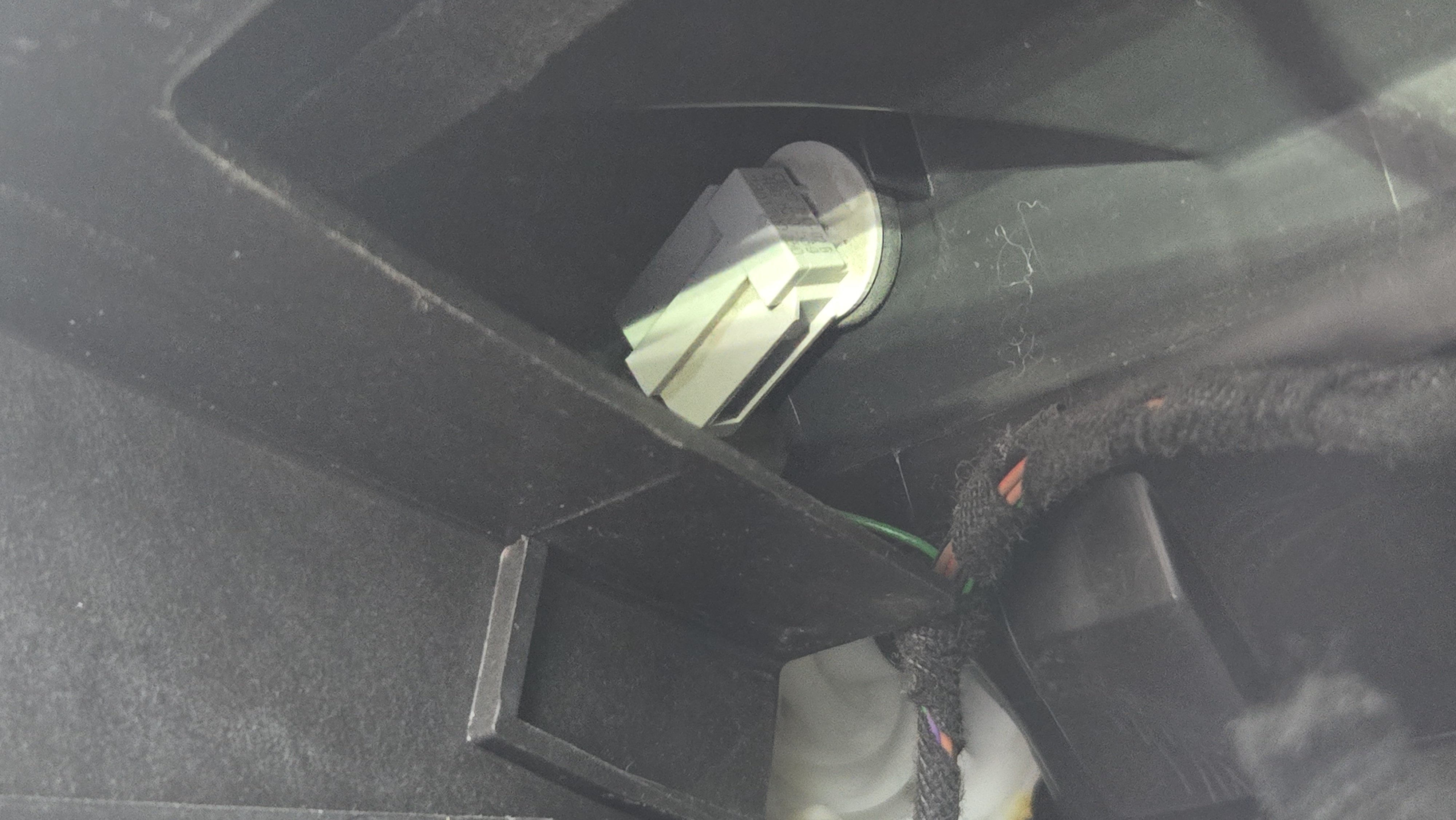

I've found 1 sensor on20211010_153447.thumb.jpg.3d9d9a729765a403d1ea92263d10bd13.jpg the LHS air vent very near the centre vents; behind the radio. It looks like a thermistor. Anyone know what it should read if all is working correctly?
There should be two, compare them.
I was hoping not to take the rest of the dashboard apart. But, good point.

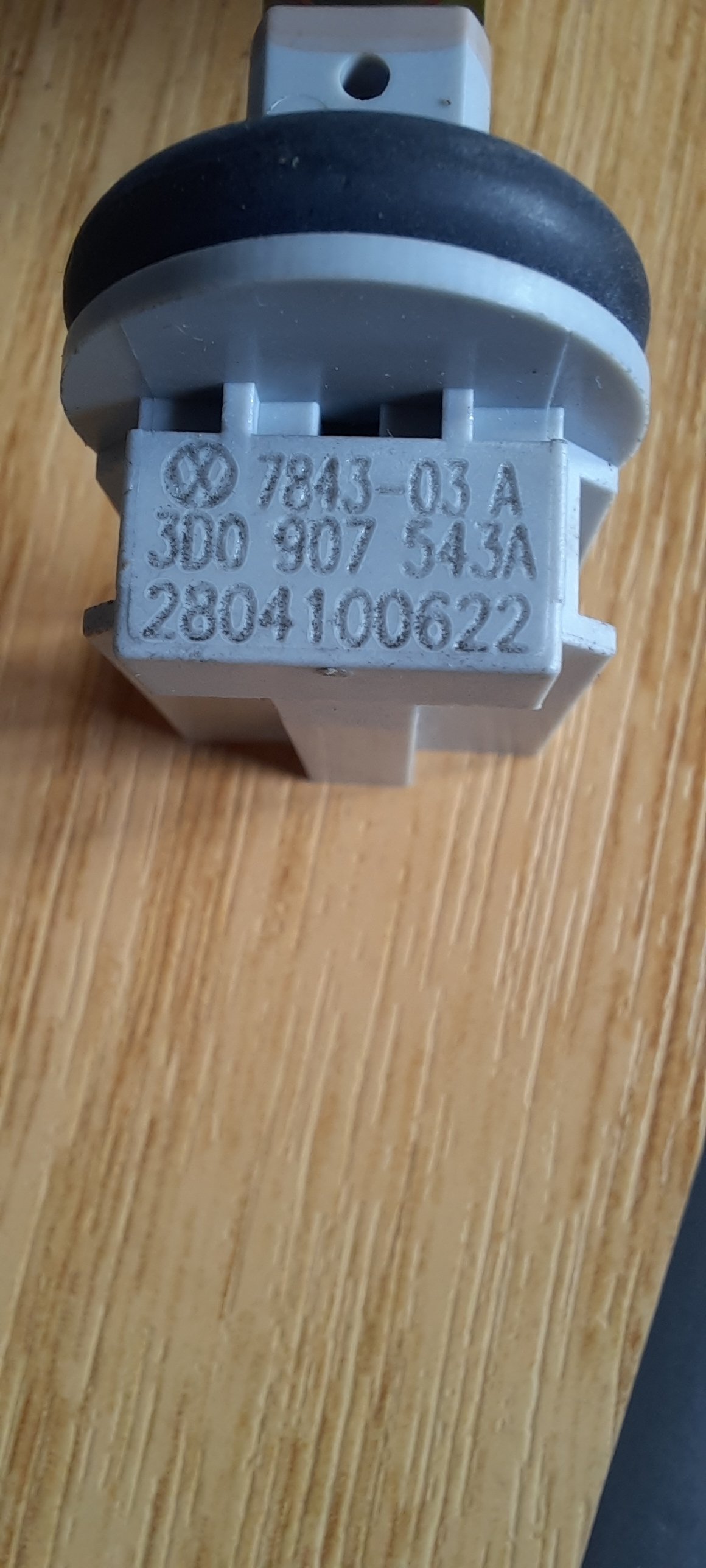

I phoned the local parts shop and they didn't have the part. The main dealer has quoted me £33.and it's a special order.  But, just to be safe I've I've managed to get at the other sensor and measure the resistance.
14C 13k Ohm
finger temp 10k Ohm
my "dodgy" sensor - 3k Ohm
So, explains everything.
I should add A) Calling the main dealer turned out to be a waste of time. I was told £33 and that someone would call me back. They never did.  My friendly, local garage ordered the part for me and it was only £30.Original VW part as well.

Reply to my own answer. On my LH steering wheel car (scandinavian) octavia 2010 MK2, 1.6tdi, the front left upper temp sensor is behind the radio. Need to pry off the silver plastic frame with plastic tool. Next use same tool on the black inner frame and now you will see 4 torx screws T25. Take them out and just grab the radio and pull out. Disconnect 2 connectors on back. You will see the left front tempsensor to the left upper side. Pretty easy access. That is 3D0 907 543A.
The right temp sensor is located behind the passenger compartment box. Take this down and you will see it high up to the left towards the centre console.
High up is the left front sensor behind the radio
Just pry out the frame with appropriate tool
