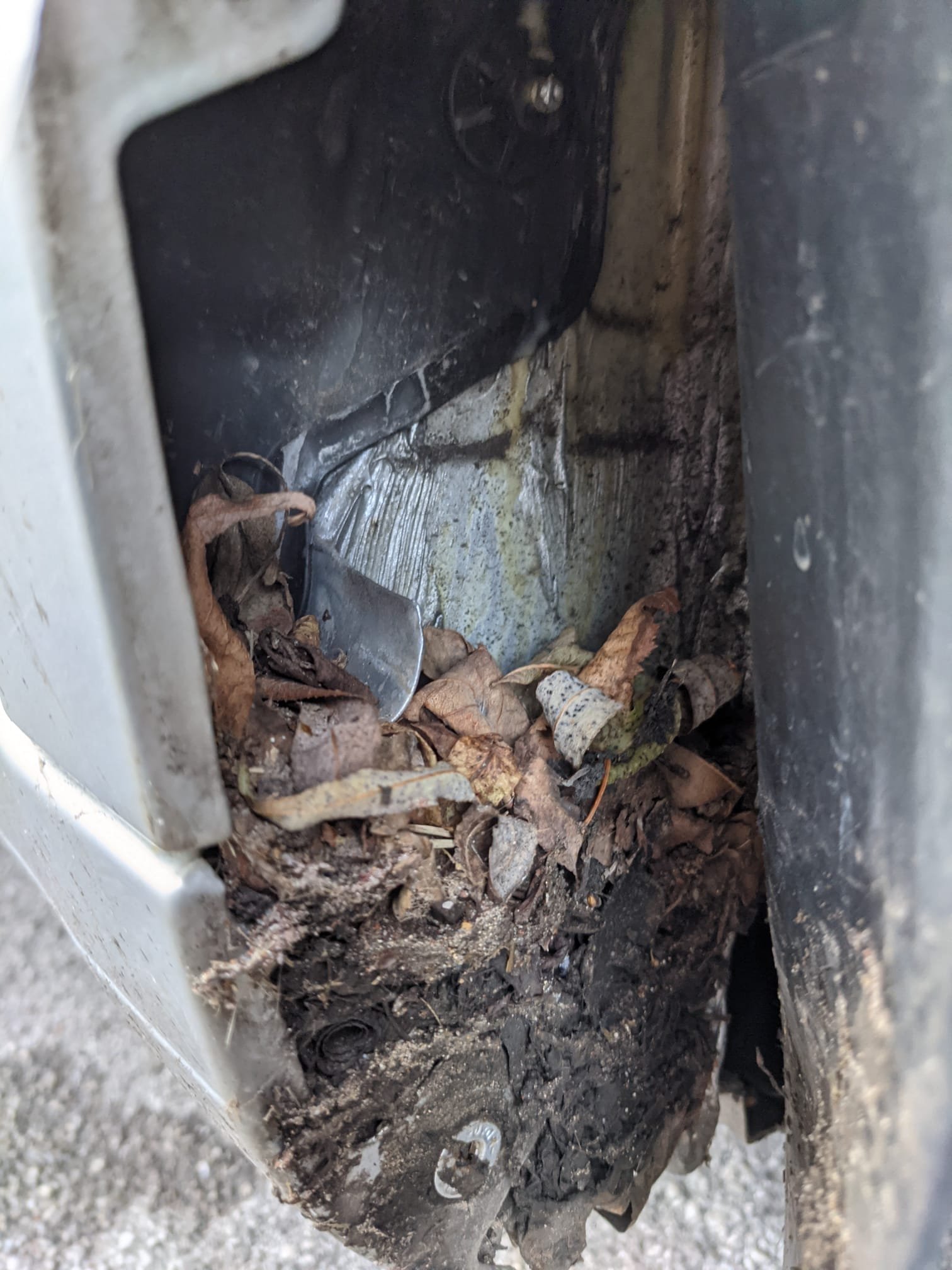

You're not kidding, pulled back wheelarch liners today to have a look see and Houston....
Fortunately below that built-in garden it was just gleaming silver paint. I suspect if it had been left a couple of years that wouldn't have been the case. I can only presume the plenum chamber drains through this area - hence the leaves etc..
Before and after shots of one wheelarch, I decided Dinitrol was the poison of choice to protect and whilst I was at it treated boot lid(inc around numberplate lights), bonnet and door bottoms as well. Fortunately the only rust encountered was a small stone chip sorted with Kurust + touch-up brush.

Exactly what mine was like

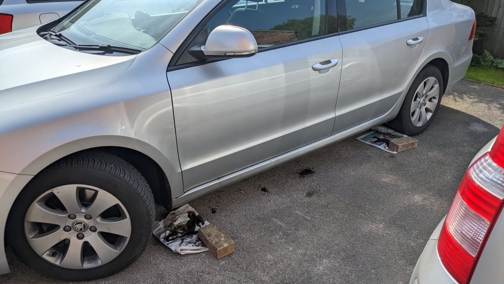

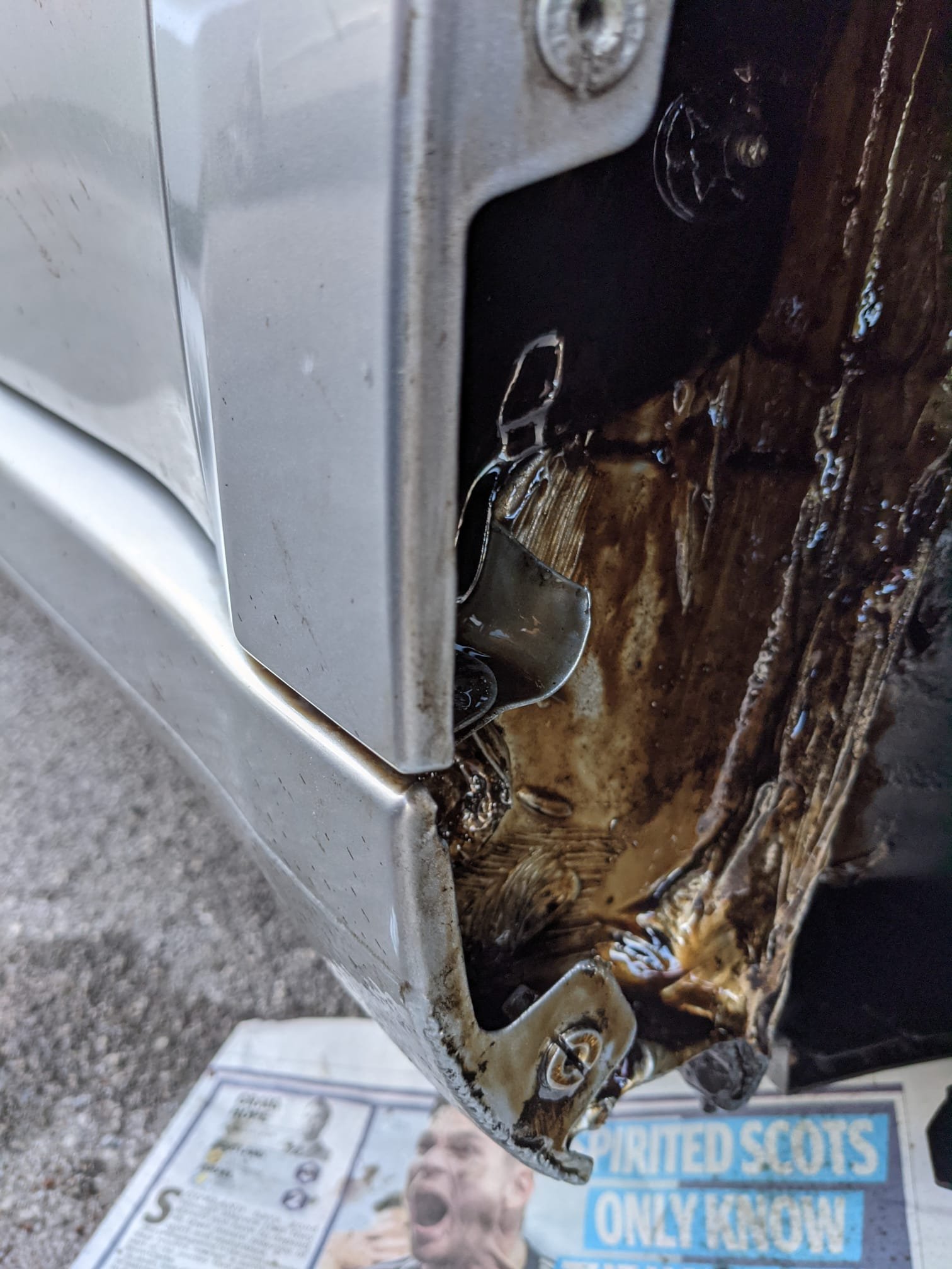

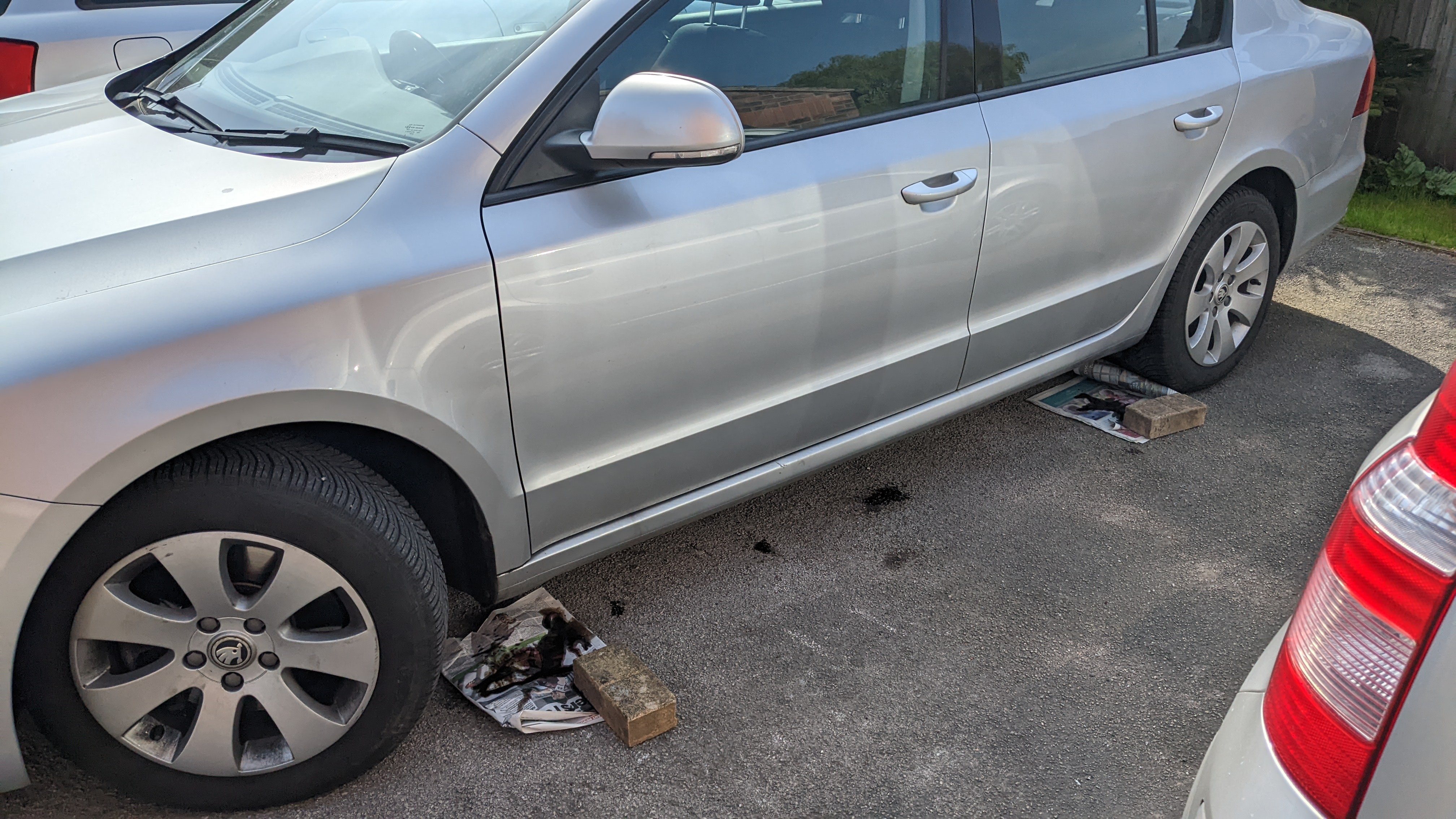

After I found out that my old previous 2003 mkI Superb has just badly failed it's MOT re body rot ( looking like it's been caused by trapped water in the sills) -  I decided to re examine preserving mine a bit more so I investigated the sills on my mkII. No drains or bungs to speak of along the full length but I have found drain channels at low level front and rear behind the wheel arch liners accessible by removing a bolt or two. I'm glad I found this as on one side the rear drain channel was blocked. Fortunately no evidence of water or rot thus far. I've liberally sprayed DINITROL ML PENETRATOR WAX using the extension spray tube inserted into drain channels each end - it's made a right mess but it seems to have done the job.
On a mkII it's really worth checking the front and rear sill drains - and clear out if blocked!
