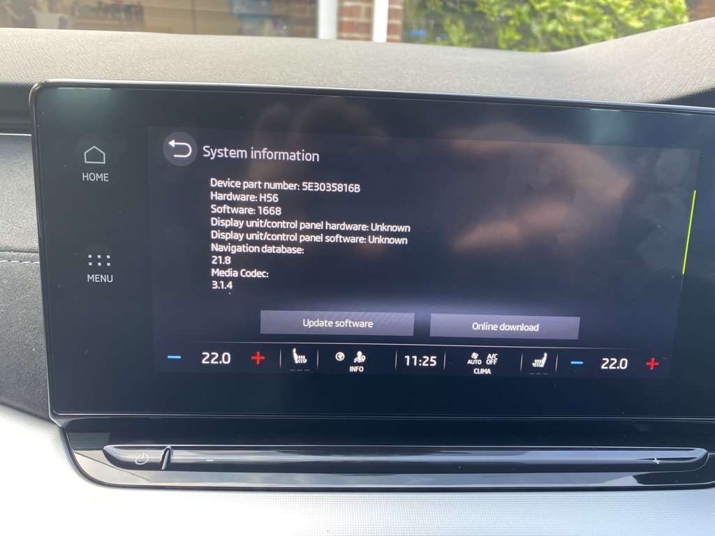

Well picked the car up today after its been in all day for 'software update'. They have changed something!! Below is the System Information before it wet in, and after it had done some over the air updates and it thought was 'up to date' with no waiting updates.

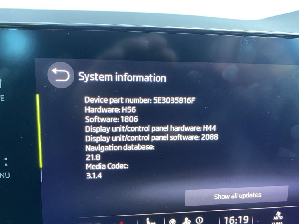

This is what it is now reading after picking it up, note the part number has changed and most of the software.....
A6B7283A-8389-43F9-AB7C-489BC0336188_1_105_c.thumb.jpeg.cae6a894d36575a25a61bd4311080be8.jpeg
Fingers crossed thats fixed the SOS and popping. In fainess to the garage they were excellent, said they knew exactly what it was and dont worry we will fix it.......
