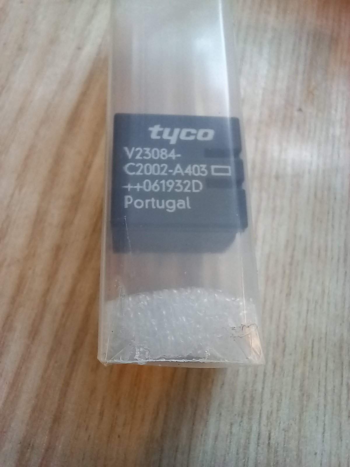

  • Sponsor
This is the one I've got. Probably a good plan to check that this is what's in your current unit before we go too far.
That’s same relay I’ve seen used in other Fabia 2 and Polo but please see PM - no probs if turns out to be different.

Thanks again for sending relay. On the old board I bought there are another two which both test OK, so at least I'm not short of relays!
Good call Wino, with seat out I could get enough purchase to remove the module.
The good news is that I did verify that the relay is faulty. Both coils are ok but only one of the relays switches. Also the two switch poles which should be isolated are shorted together.
The bad news is that they changed the relay type going from the 6Q1937049D module to the 6Q1937049F which is the one in Fabia 2. Instead of the Tyco relay there's an Omron G8NW-2U with same functionality but different pin outs. I've located a UK source for the relay but for time being the car will be out of action. I could plug the module back in and reinstall the seat but it's such a pain getting the module out (despite better angle my fingers still very sore!) I don't fancy repeat performance.
