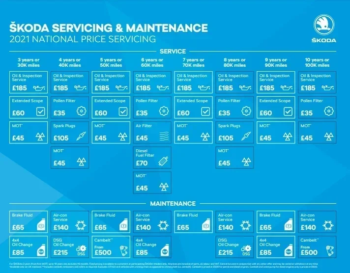

1624336521_37335614_Screenshot2021-09-14at07_38_18(3).webp.3c042b3d60ff4f7eed63333aeb416947.webp.d154c236398031a998b1fdde39041a5b.webp.8cfaafe87c7ff96e145844e3c30112b6.webp
