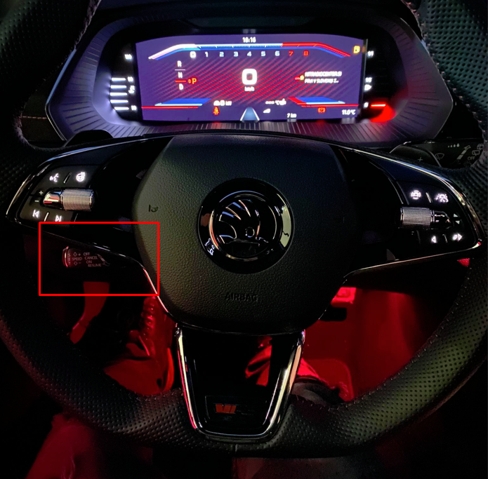

The switch on the top of the indicator stalk is the only one I know of. Pushed fully towards the steering column turns off the CC, the other way should turn it on, with a sprung 'nudge' towards the column to disengage it in normal driving.

Do you have a separate stalk for cruise control under the indicator stalk? If yes, then you need to pull it firmly towards yourself. This engages cruise control.

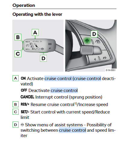

Sneal has already described where the main switch is located. Maybe this screen shot from the manual helps in any way.
