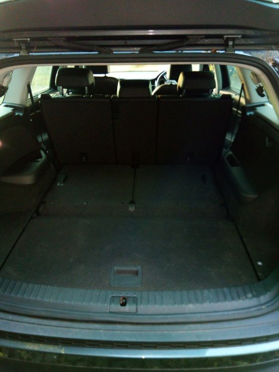

How-to for 7 seater spacesaver installation, (car originally equipped with can of slime and a compressor), if it's of any use to anyone.

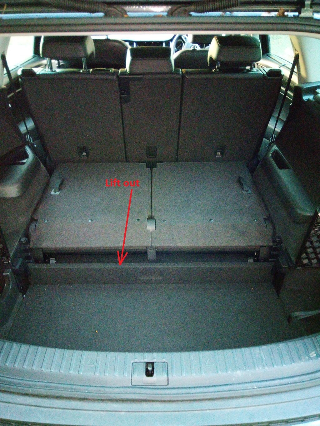

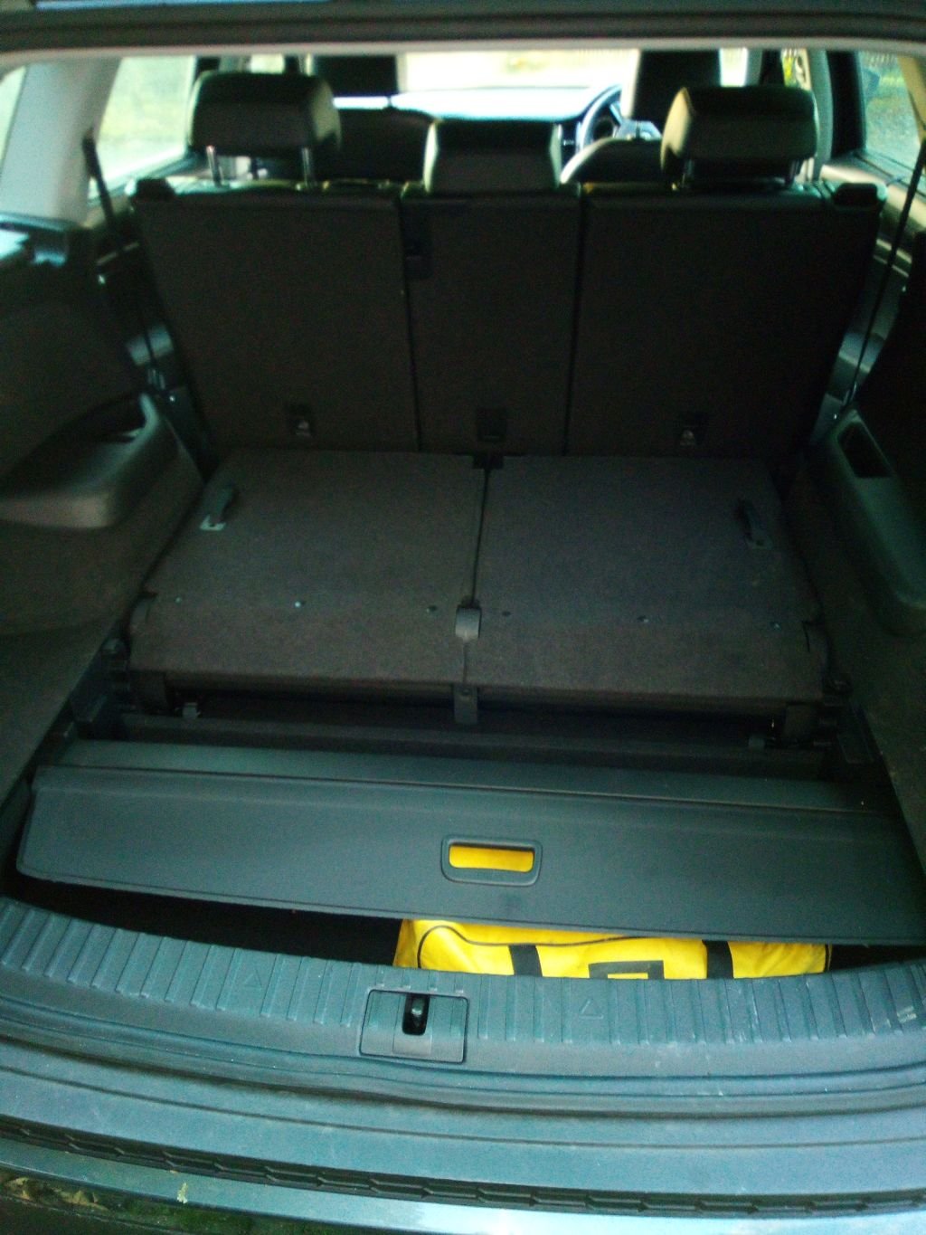

Lift out the rearmost floor panel.
Flip up the two side covers and lift out the "modesty curtain"
Lift out the separator board

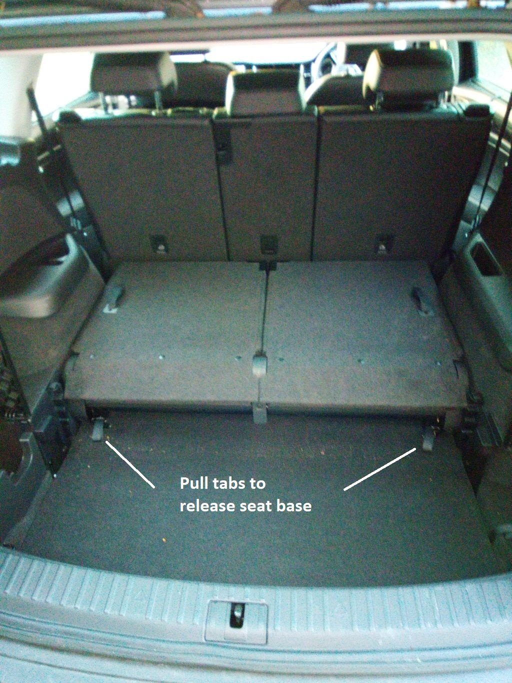

Pull the tabs to release the Row 3  seat base.

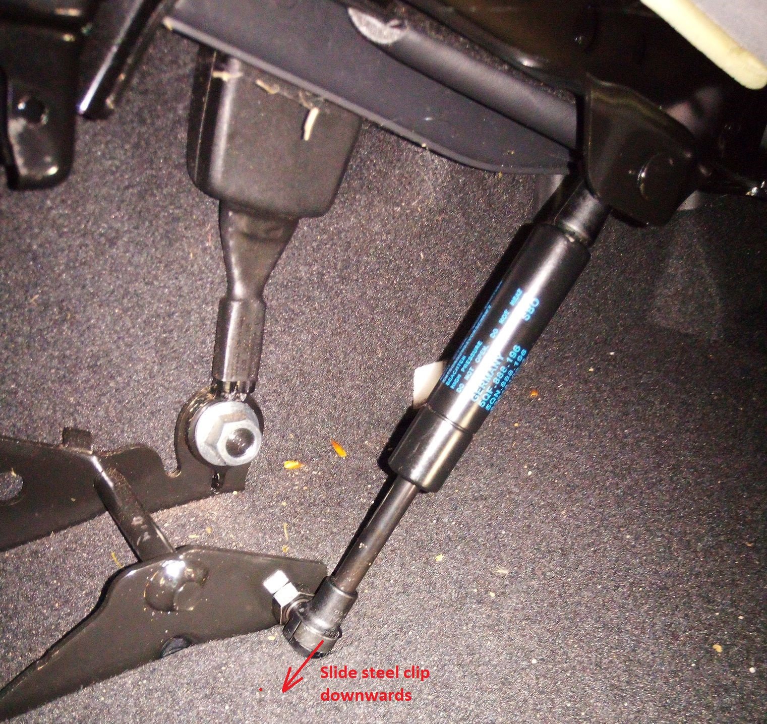

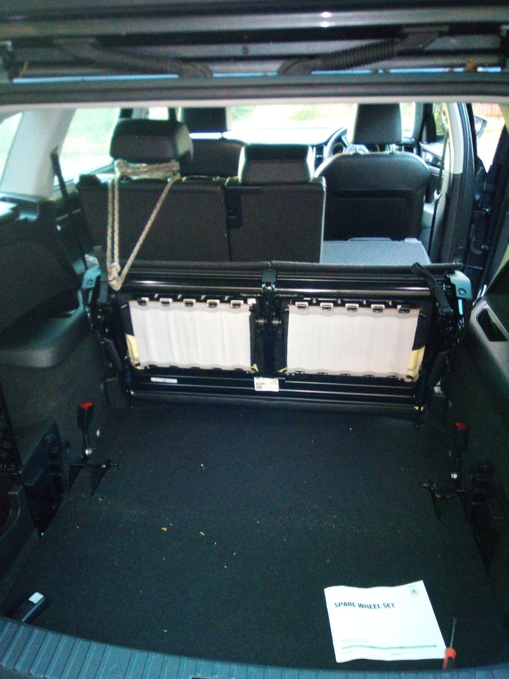

You don't have to do this next bit, but it makes access a bit easier. I popped the gas struts off their bottom mountings to allow the seat base to lift higher.
Then tied the seat base to the head rest bars to keep it up out of the way.

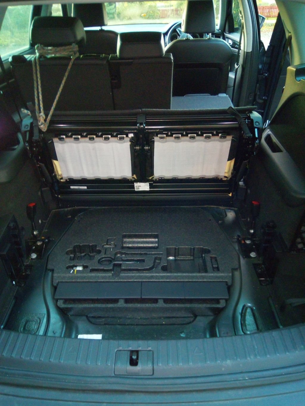

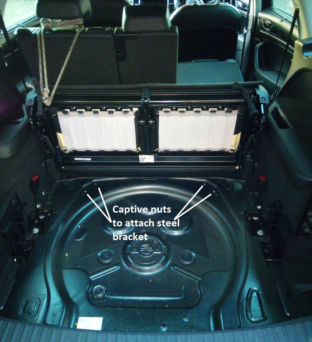

Pull out the carpet and take out the foam tray for the compressor and tyre repair "slime".

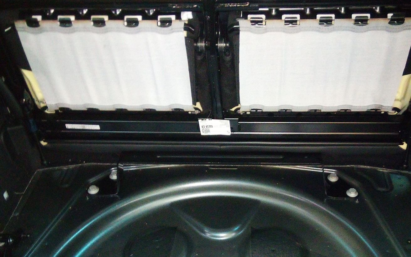

This exposes the wheel recess and captive nuts for the steel retaining bar that goes over the front edge of the spacesaver tyre.

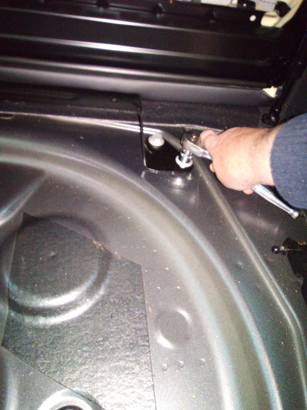

Tighten the 4 screws to secure the steel retaining bar to the captive nuts.

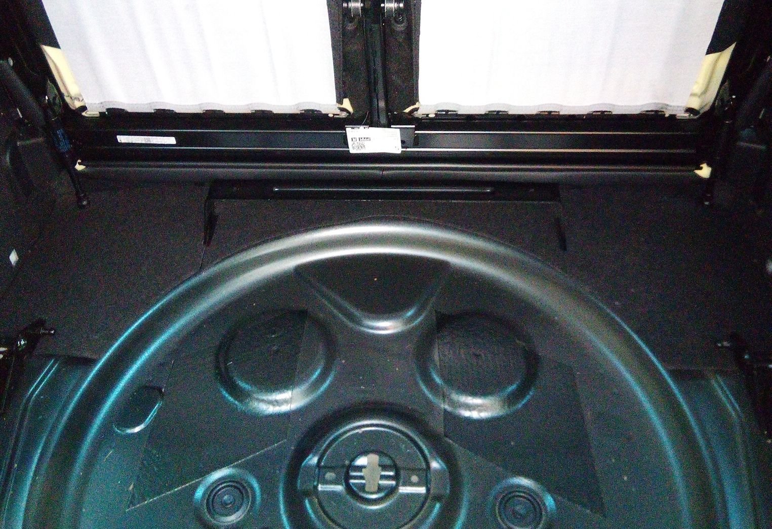

It should look like this, with the top of the retaining bar just under the leading edge of the seat.

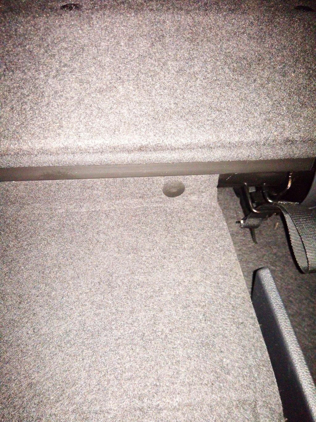

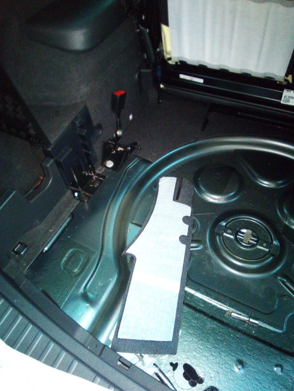

Fit the curved bit of carpet. It's a bit fiddly, it goes AHEAD of the steel retaining bar and then the ears at each side face backwards.
Peel off the backing and glue down the two side pieces of carpet.

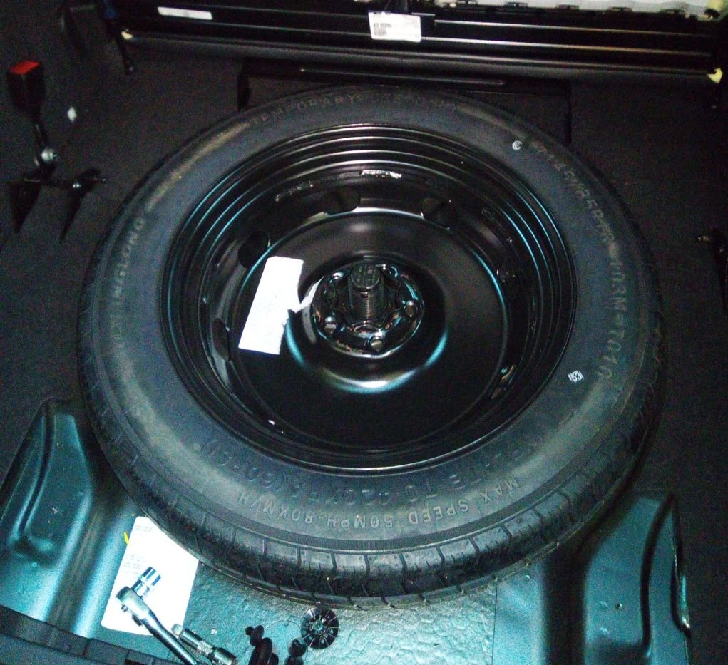

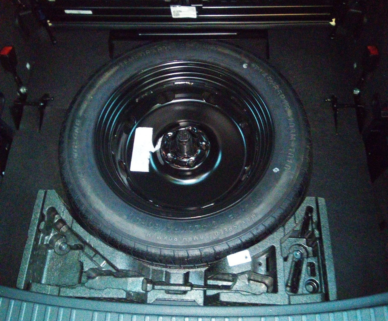

Fit the spare wheel with the yellow speed warning labels facing DOWNWARDS and push the plastic retaining screw down into the slotted steel pressing on the floor of the car below the centre hole in the wheel then turn it 90 degrees to lock it.

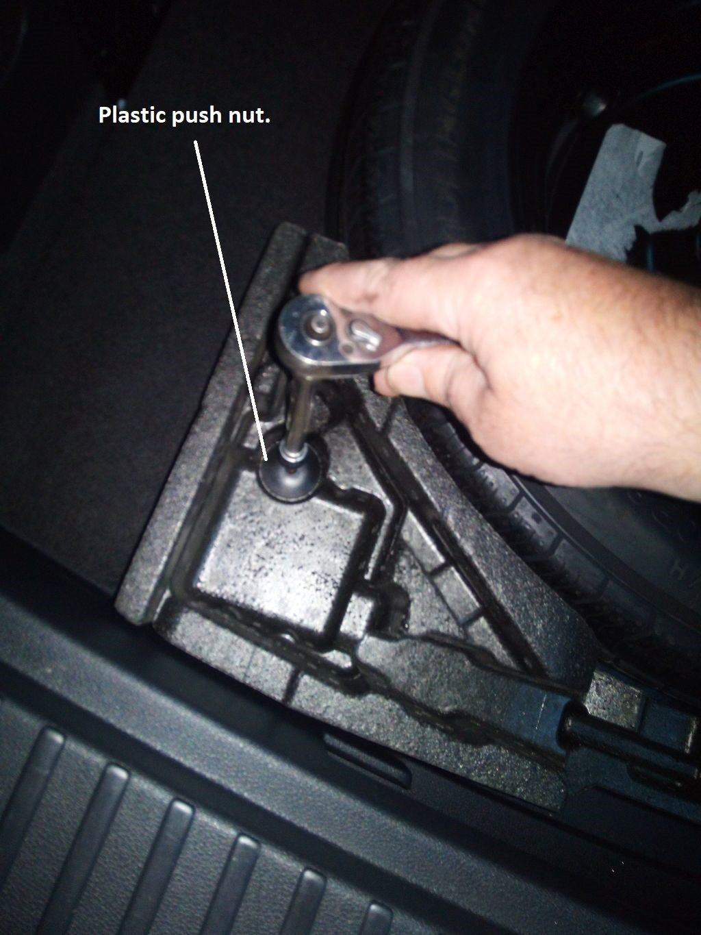

Fit the new foam tray just behind the wheel.
Secure the tray with the two Torx-headed plastic push nuts. There are studs already in the steel floor to accept them. DO NOT over-tighten!

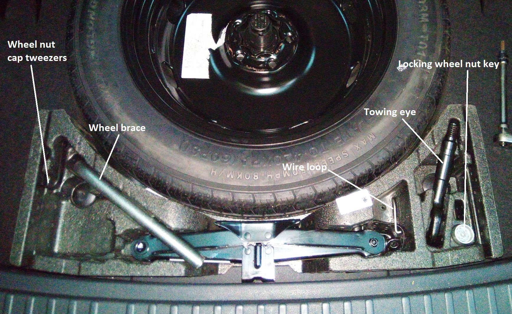

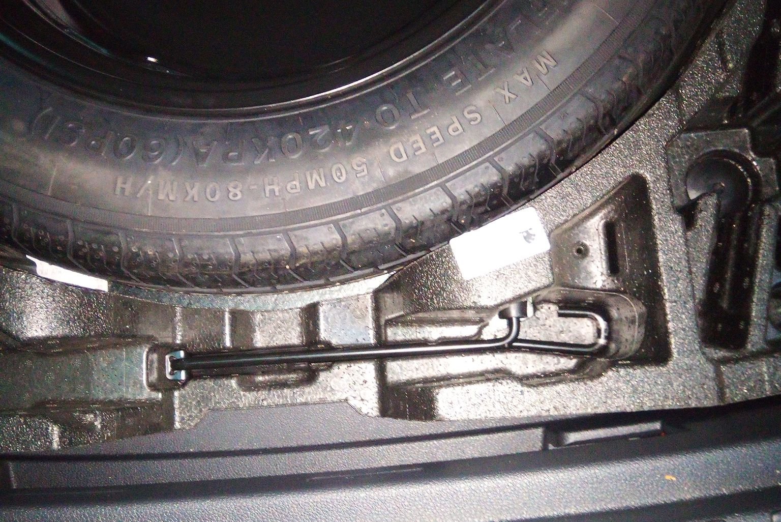

The jack handle goes in first, under the jack.
I wasn't quite sure where all the other bits go, but I think it's like this:

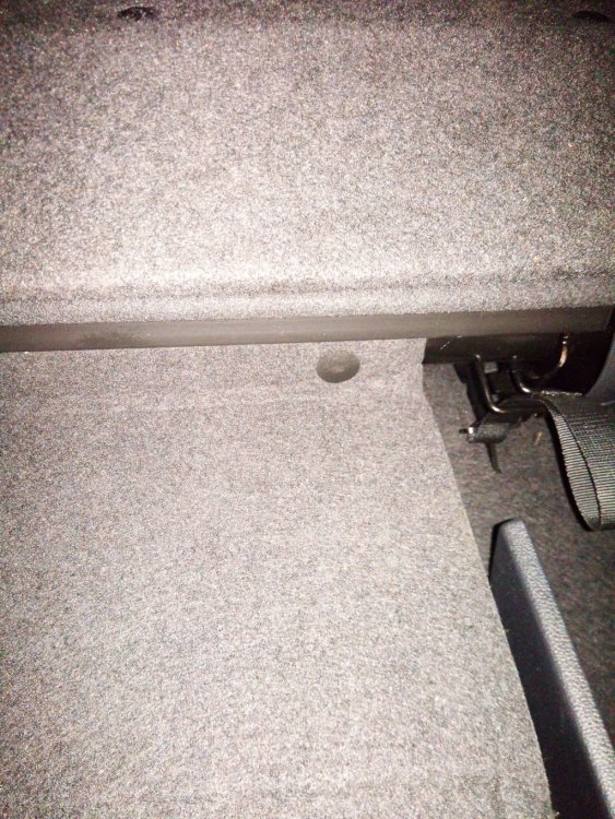

Fit the new piece of rear carpet over the tool tray. Fold the forward edge up at right angles and push the Fir tree clips into the holes already in the rearmost round bar forming the Row 3 seat base.
I'd argue it would be near on impossible if you didn't do that, from looking at your pictures...
Anyway, hope you're feeling better now - and good write-up!
I think I could probably have done it.  Perhaps getting that first bit of carpet in, ahead of the big steel top hat bracket, would have been the hardest bit if I hadn't.
