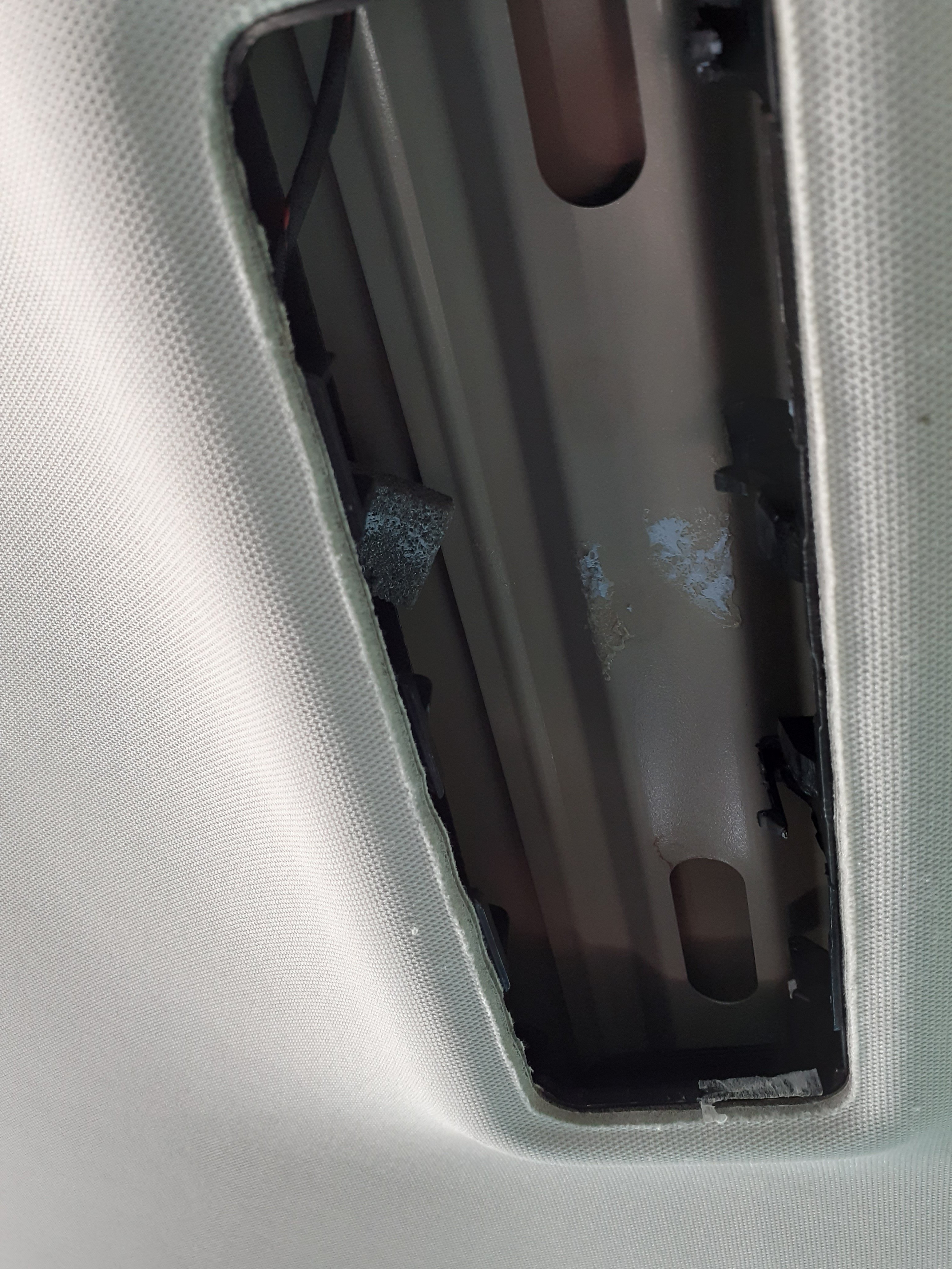

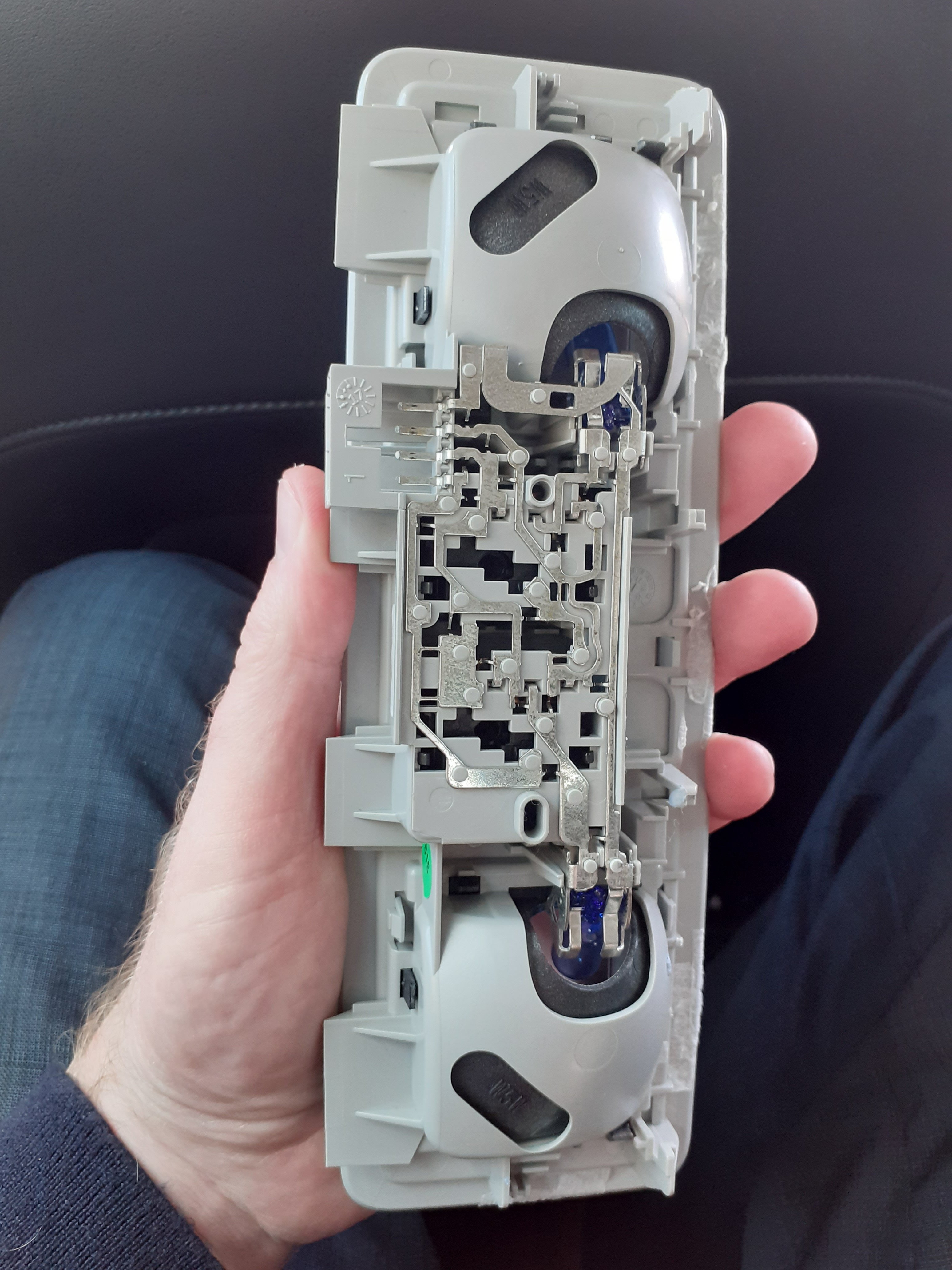

Hi. Has anyone got any instructions for replacing or refixing the rear reading light. Mine has fallen out and I'm trying to figure out if something has fatigued. Any guidance gratefully received. Thanks

The left side of the top picture slots in under the headlining facing towards the front of the car. It's hard to tell but it looks like the tabs on the other side or damaged, so not gripping the headliner. It also looks like someone has tried glue on that side which obviously hasn't worked. Might be time to look for a replacement at a breakers yard.
