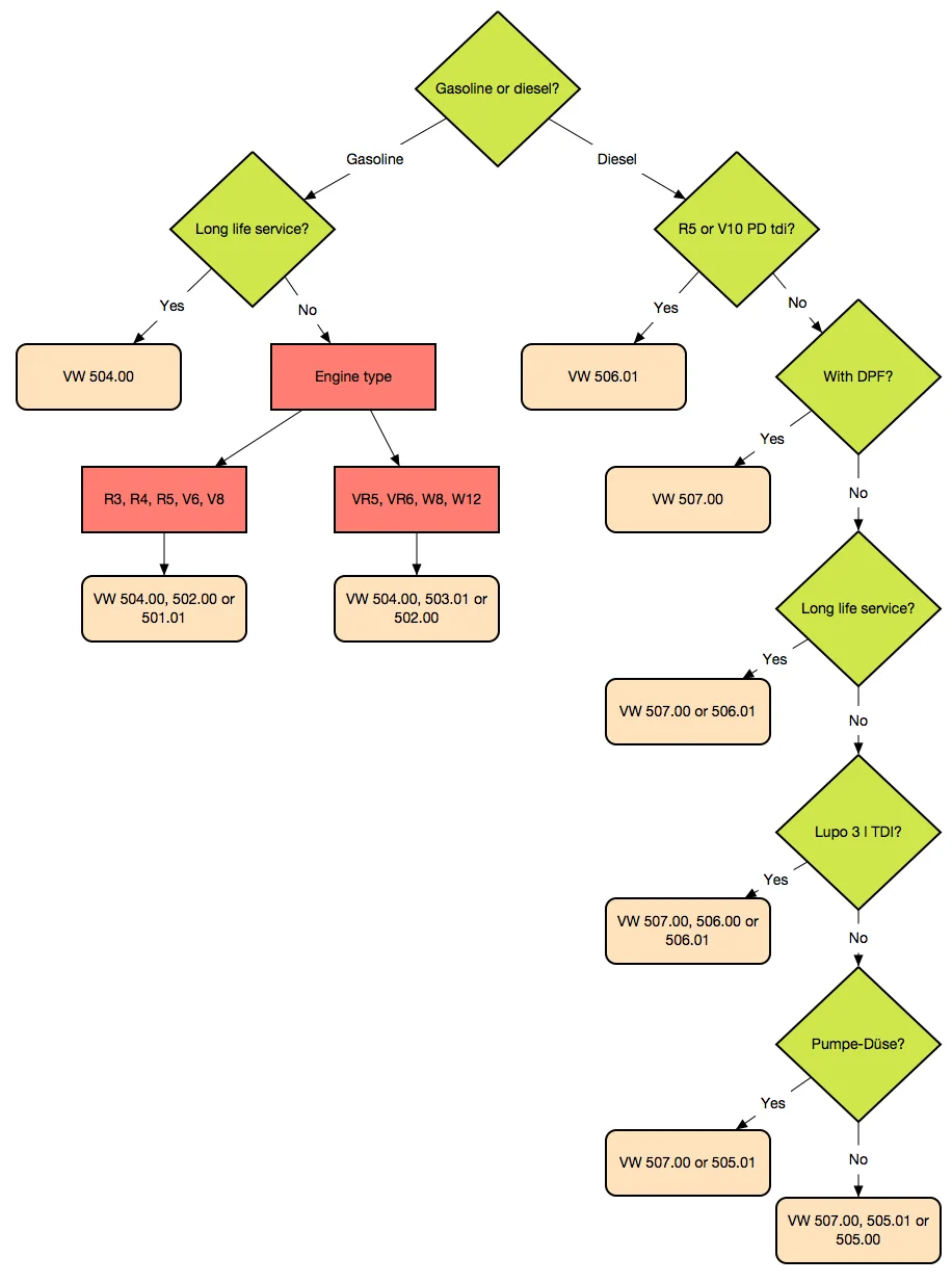

Hi guys I'm looking to give the car a service. It has used some oil from I've acquired the car. It was serviced this time last year and I can guarantee it has never saw an engine flush in its life so I'm looking to flush the engine (and the coolant while its in as the the water looks rather brown ) and replace the oil. I'm considering using high mileage oil as she's currently on 310k miles but the problem is I can't find vw507 spec high mileage oil (although it specifies low ash) and I've read other forums that seem theres no great benefit from it.

It would take a lot of effort to not be able to find oil to VW504 00 / 507 00  so 5w 30 Full Synthetic III
It is sold in Asda, Tesco and other supermarkets probably then at Motor Factors or online.
Also at Main Dealer & Filling Stations where is might well cost more.
