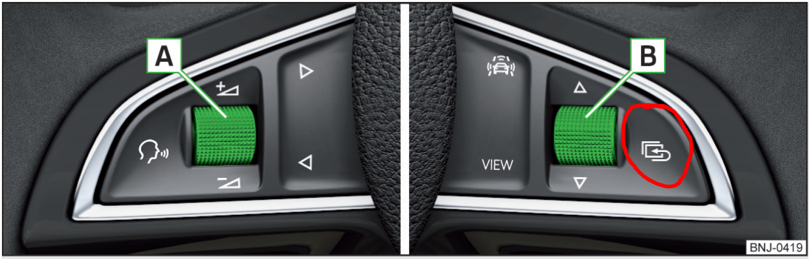

Not that i'm aware of, but simply pressing the 'back' button on the steering wheel in this scenario (where the sat nav has taken over with it's direction prompts) will revert to the previous screen, no navigation of menus or anything is needed, just a single button press.
Many thanks for that but will that still leave the Amundsen SatNav display showing?
Yes, it'll leave the Sat Nav doing it's thing on the infotainment, it'll just return the 'Maxidot' display back to it's previous screen - in your case, speed.
