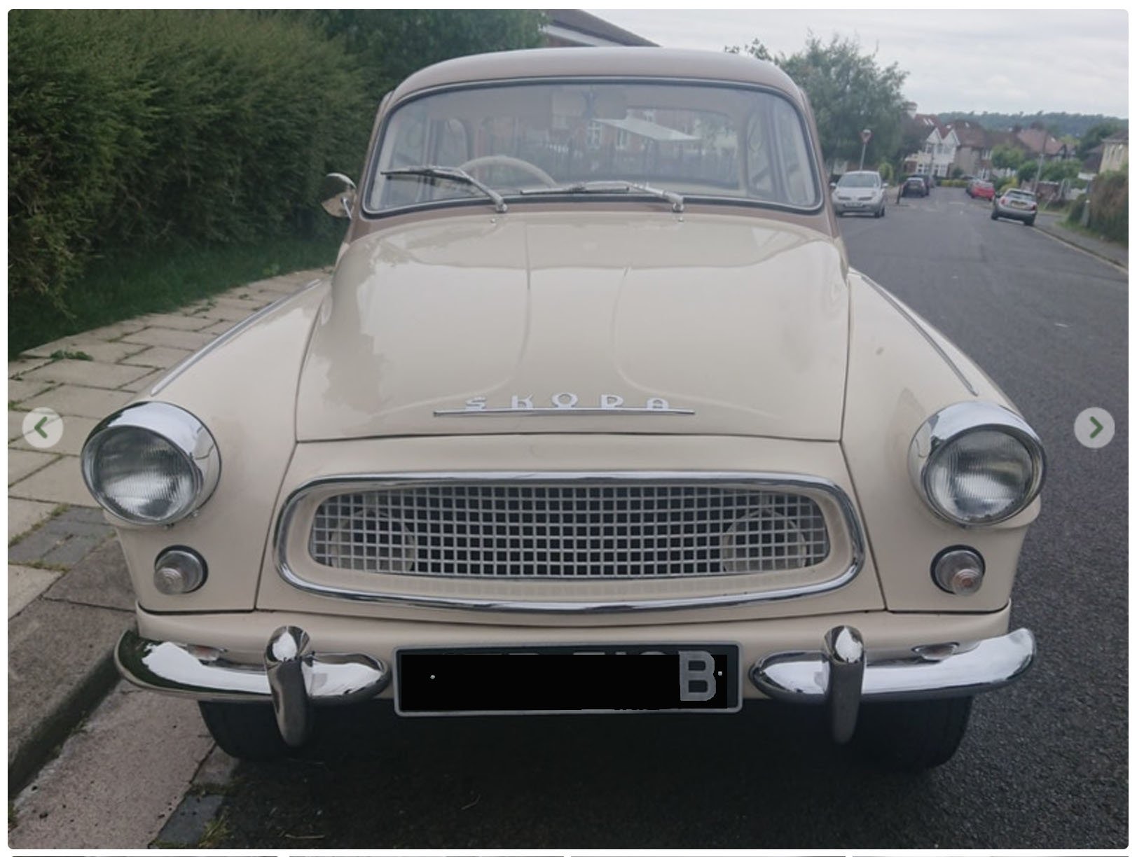

I suppose most of the latest hybrids will display quirky faults. Perhaps I ought to get a restored Morris Minor 'woody' from the Morris Minor Centre in Bath! A screwdriver and a set of spanners would be all I needed for any mechanical work.
I think this might be the answer. 1964 model on sale in Bristol for £19,750.1294960668_Screenshot2021-11-10at18_00_23.thumb.jpg.564c9ebf252dd2fe5bbb369db4d63fa3.jpg
