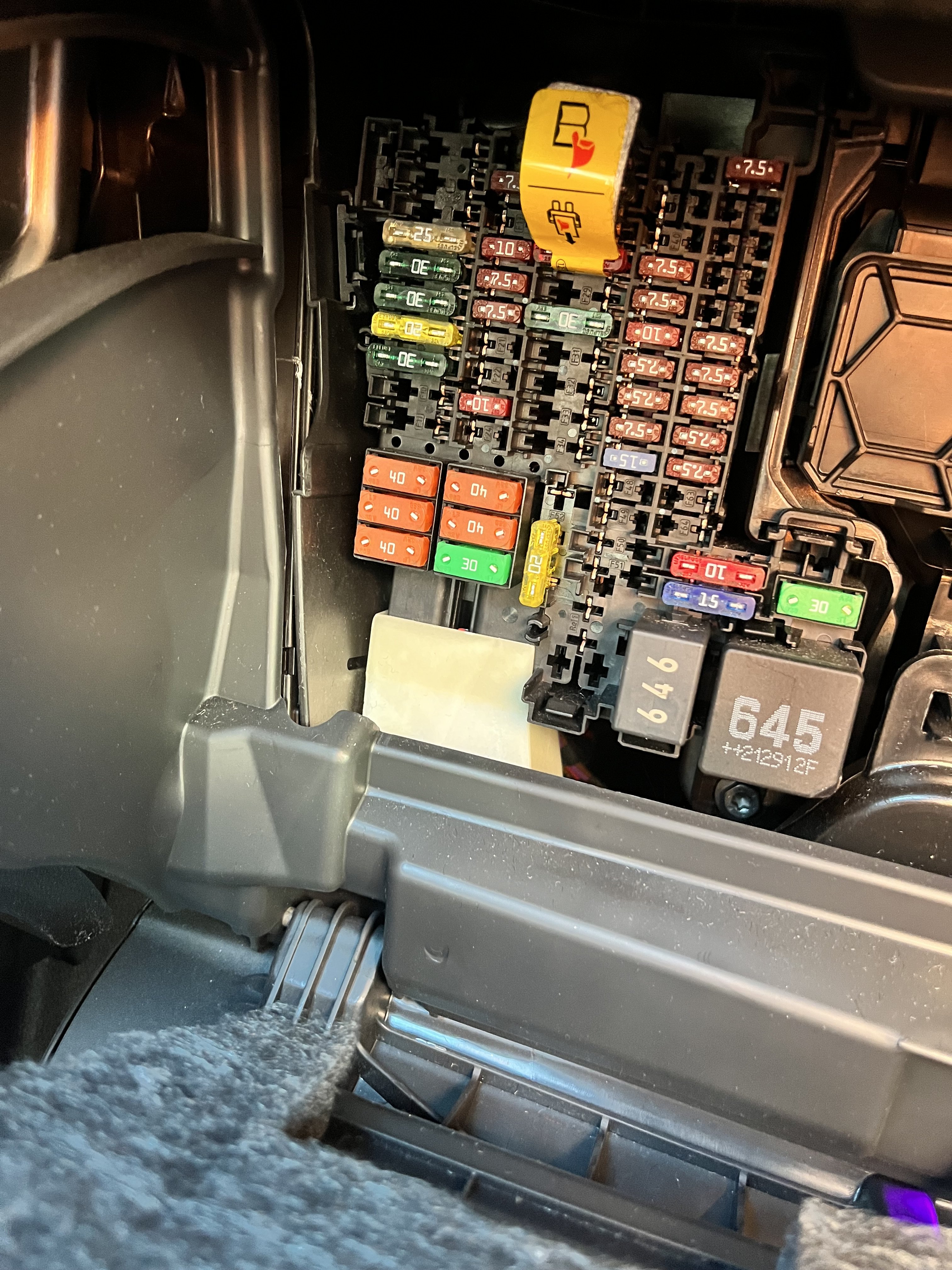

Update. It was looping terribly, so i pulled fuse 30 (30amp, picture below, one below the yellow tag on its own) and then left it out, locked the car Abe came back 30 mins later, reinstated the fuse and started the car. Seems to have fixed it.
