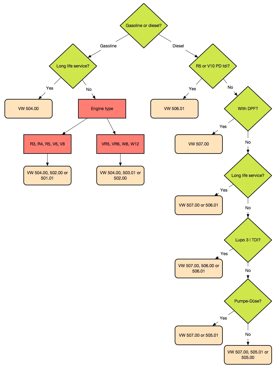

The 5w 40 Full Synthetic is to VW502 00 spec and for fixed service intervals.   Use 0w 40 Full Synthetic if you want.
You could use 5w 30 or 0w 30 Full Synthetic III (Long Life) if you want and do Fixed Service Intervals.
VW504 00 /507 00

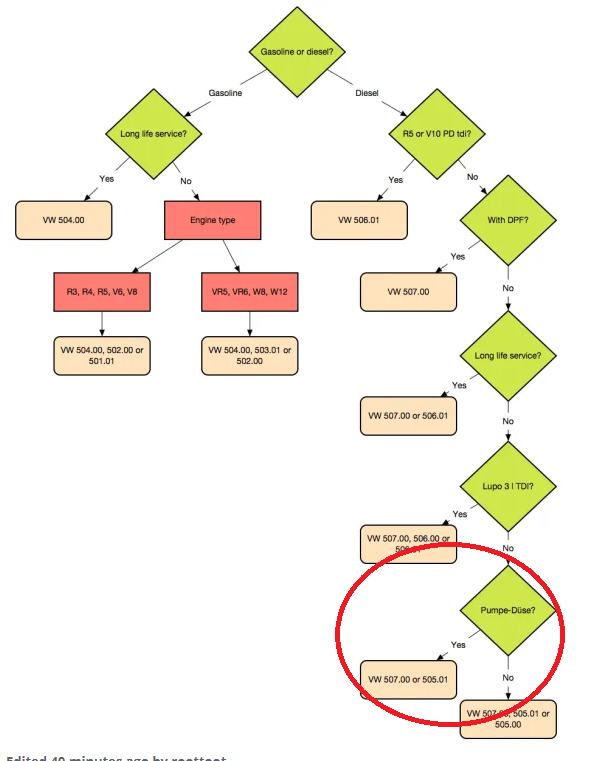

If your engine is a PD type, the important part of roottoot's chart is circled here:
Using any oil that isn't rated to 505 01, or 507 00 will cause rapid cam wear on a PD.

@conniebell - Actually, @Wino has raised a very important point. Is your car a PD? If so it will have a badge TDi on the boot.
