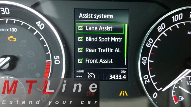

When u start the car, they should briefly light up, as part of the ignition sequence.
.... assuming they r installed.

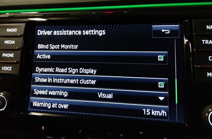

If they r there, then u can switch them on via the steering wheel or infotainment, under Driver Assistance settings.

My driver controls only say front assist, nothing else.

If your car is fitted with blind sport monitoring, both outside mirrors
should have the logo.
Additionally, you should be able de (de)activate them using the right button on your steering wheel and it should be displayed i the maxi DOT.
