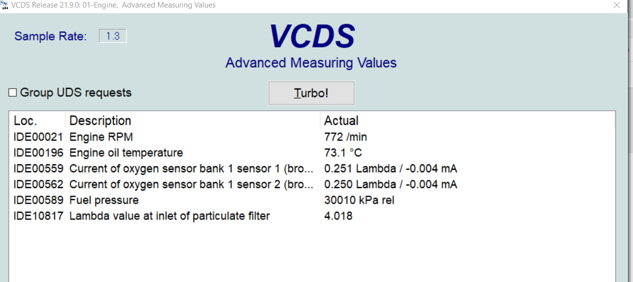

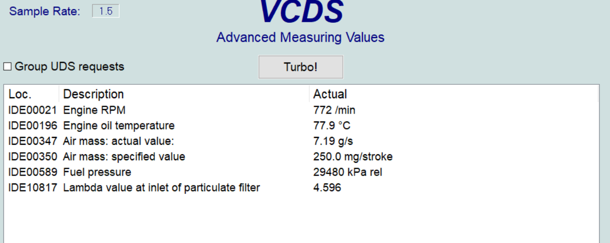

same engine, heres a screen shot for you of mine, oscillates between the same values as you mention
Screen shot from VCDS ADVMB.
and with Air Mass actual and specified.

Thank you! I can now compare and see that my problem seems with the oxygen sensors or...
 current of oxygen sensor 0.250 Lambda but 3.005 mA 🧐.
are you sure your engine is working fine? I also checked a passat same engine and year and have same reading as mine including the mA

I think your engine wasn't warm enough for the o2 sensors to work properly, plus they need time to reach a temperature of 600 C to read as it should. Can you please take the same measurements when it reach 90 C

That's ok always like a dig into VCDS when some one else is in need. Not sure what you're looking into to be honest but happy to get some screenshots.
Pretty sure my engines ok, there are no fault codes, I'm sure lambda would flag fault code as used for emissions.
You want coolant at 90c or oil at 90c?
Oil at 90c might be tricky given I have a slow drive home the last 5 miles..

   Just observed on mine, first oxygen sensor start to show mA readings before reach 90C ( coolant temperature) and the second oxygen sensor at 80C (oil temperature).
   The first oxygen sensor is positioned at the exit of exhaust and the second one after catalic converter so it's logical that is reaching optimal temperature (600C) to start functioning before the second oxygen sensor.
    I am interested in what readings they show when the oil is at 90C on other cars
