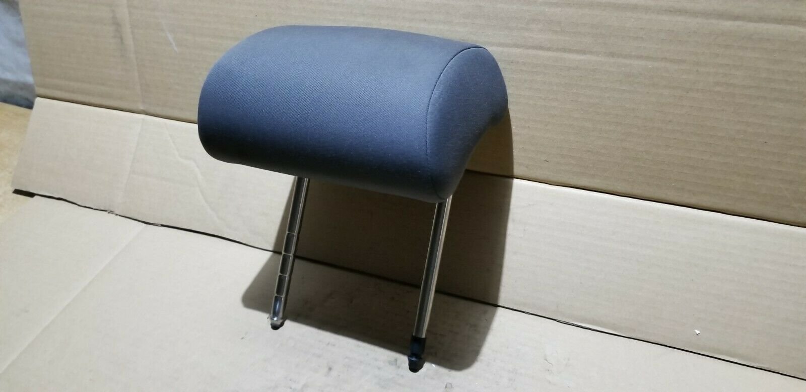

Now, getting the headrest from a Fabia is like finding fangs in a rooster. The solution is to look to other VAG cars. As such, looking to the 9N Volkswagen Polo was my solution, since it shares the same platform as the Mk1 Fabia and the SEAT Ibiza. Mine was purchased from a car breakers on eBay and was wrangled from a 2008 9N Polo. You may choose to do the same, or you may seek one from a scrap-yard.
As a point of note, the headrests that can be found on the left or right-hand-side of the rear seats are larger and using one of those for the middle may restrict your view of the road behind you. If you want to use one of these, then go ahead, but I don't recommend it for that reason.

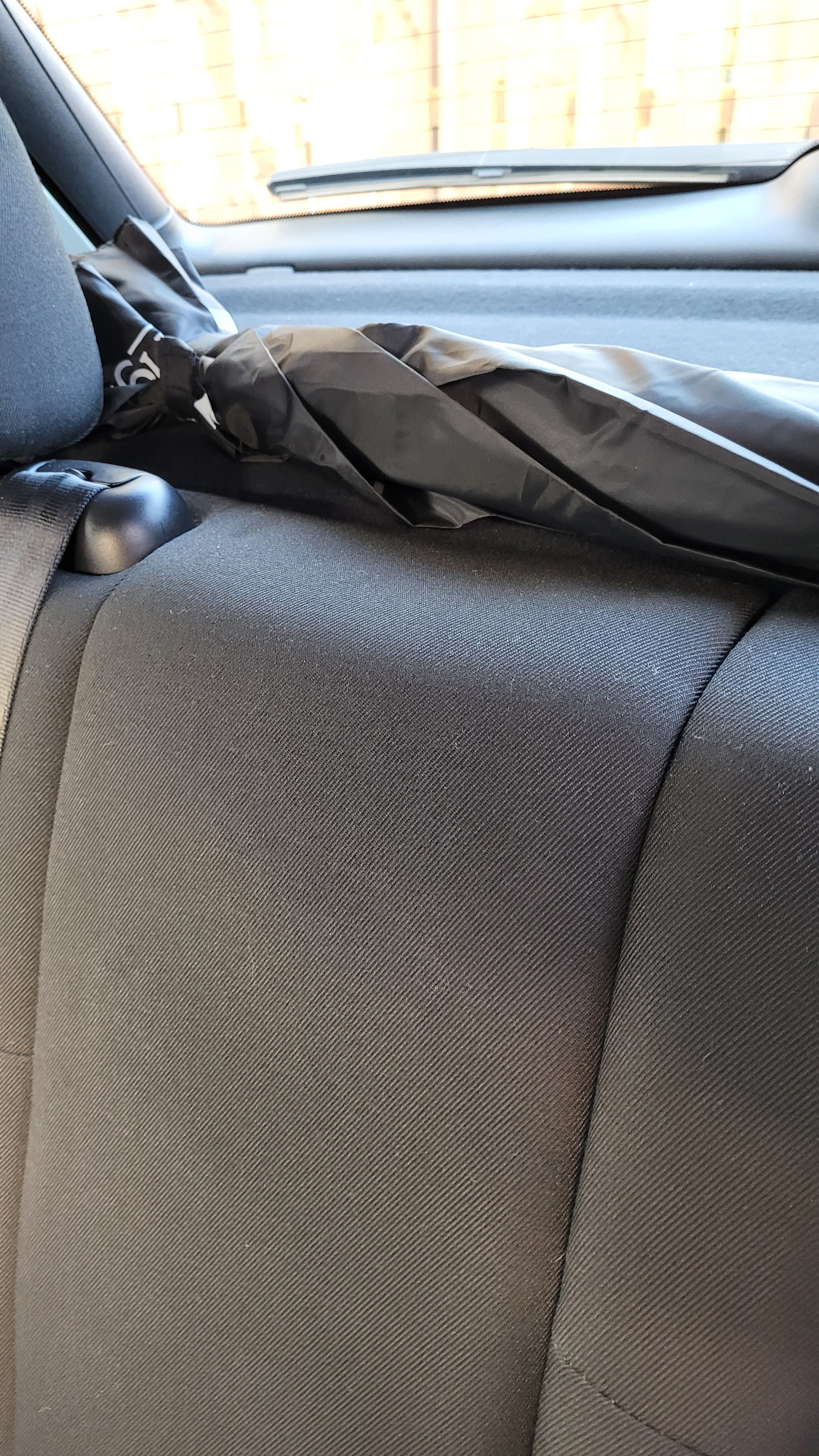

Like the first two steps, but important nevertheless. Go out to your car and check the rear seat back where the headrest goes to make sure you have the holes there for the guide tubes to go into. You'll be able to run a finger across the top of the fabric and feel the little notches where the tubes will go into.

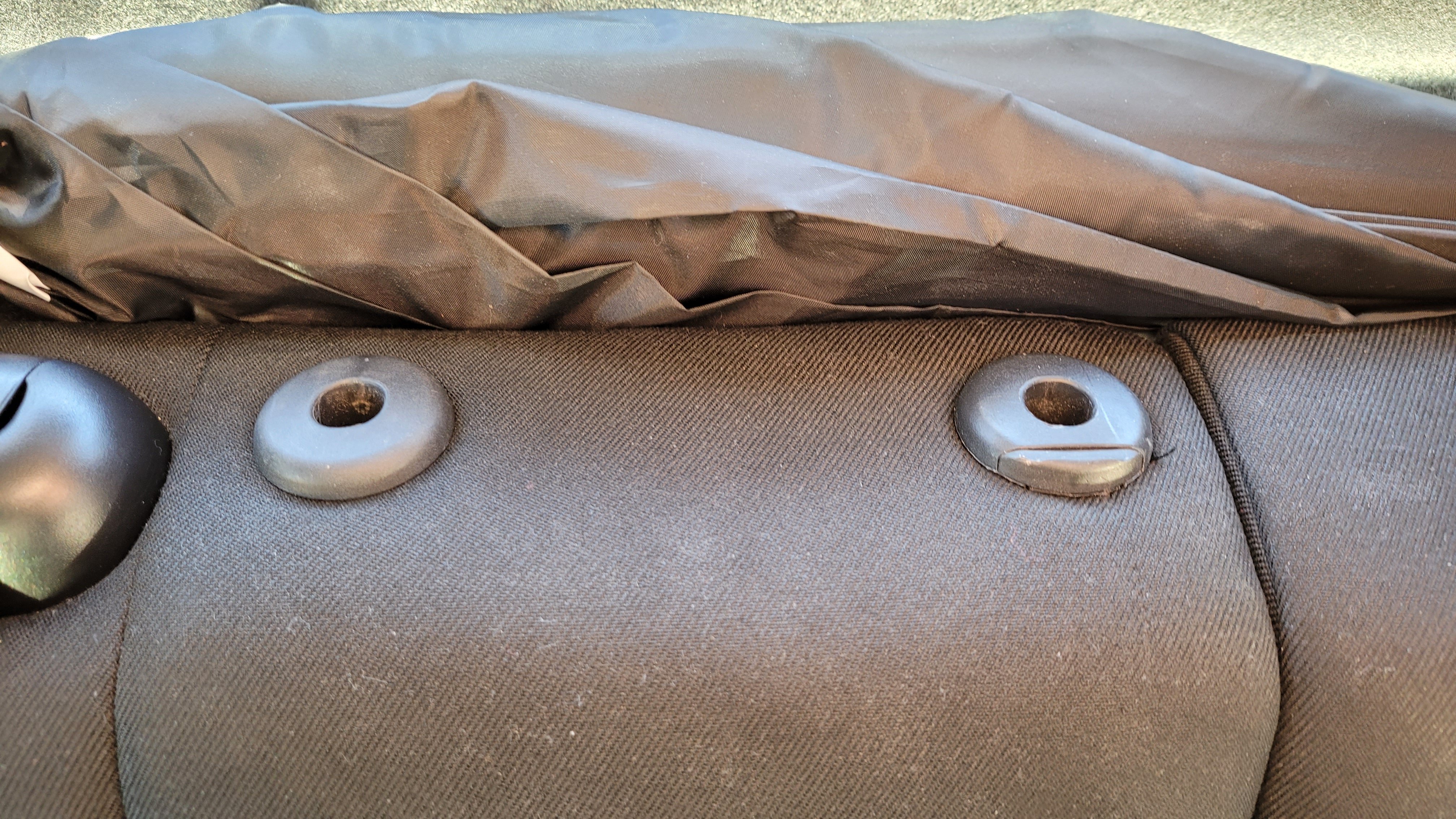

Take your cutting utensil and make small guide holes in the fabric in the area where the guide tubes are going. You may then proceed to continue cutting enough fabric for the guide tubes to fit into the holes. You shouldn't need to cut too much. You should also be careful as not to damage other fabrics. So if you can, take the seat back out, bring it forwards or whatever.
Step Five - Fitting Parts:
First of all, there's no point in having a cart without a horse, so get the guide tubes in first.

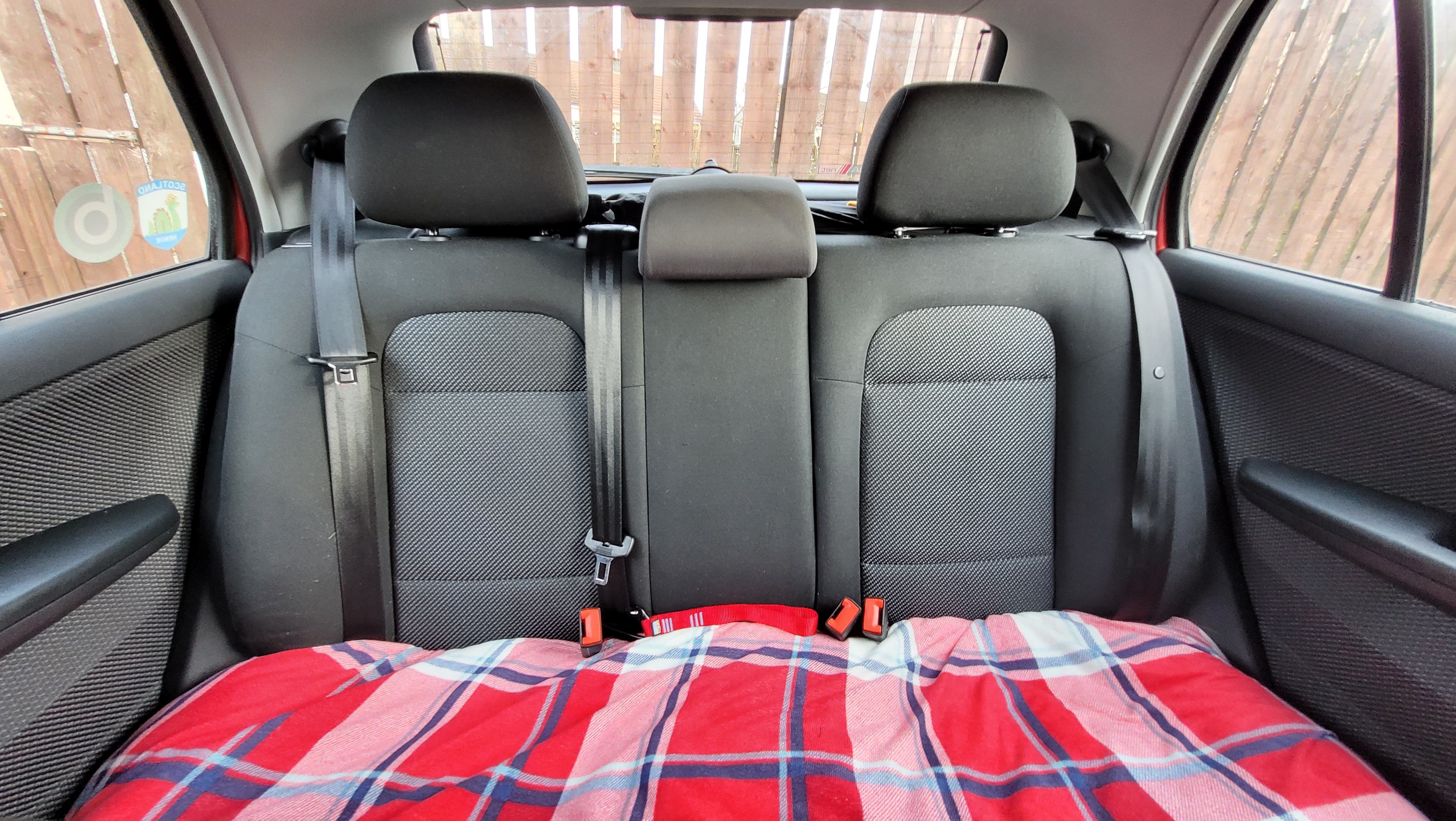

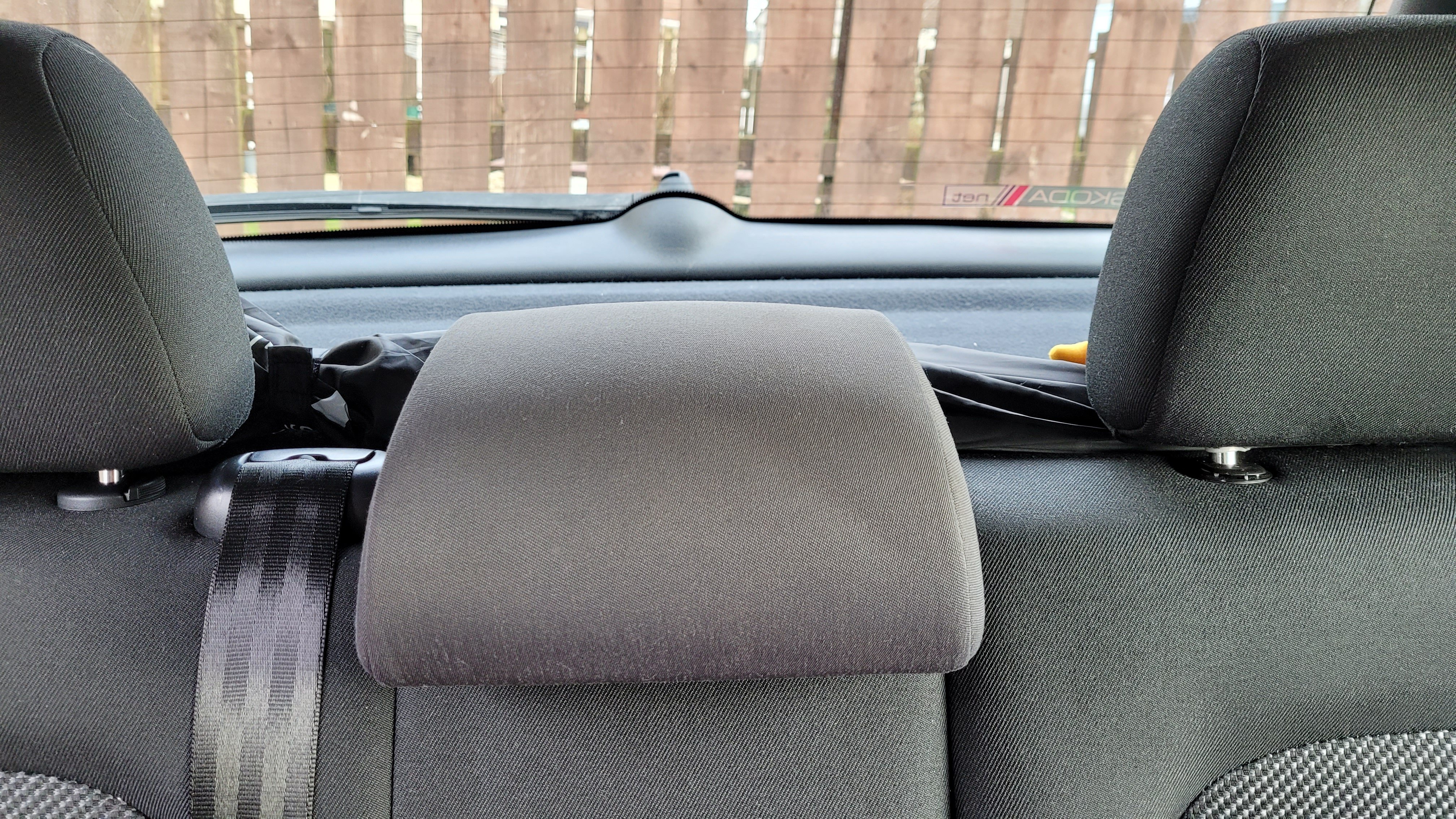

Secondly, fit your headrest. It should click in nicely and securely. As an example, here is mine once completed.

I find that the middle one doesn't actually interfere with my view behind due to the way it sits.
