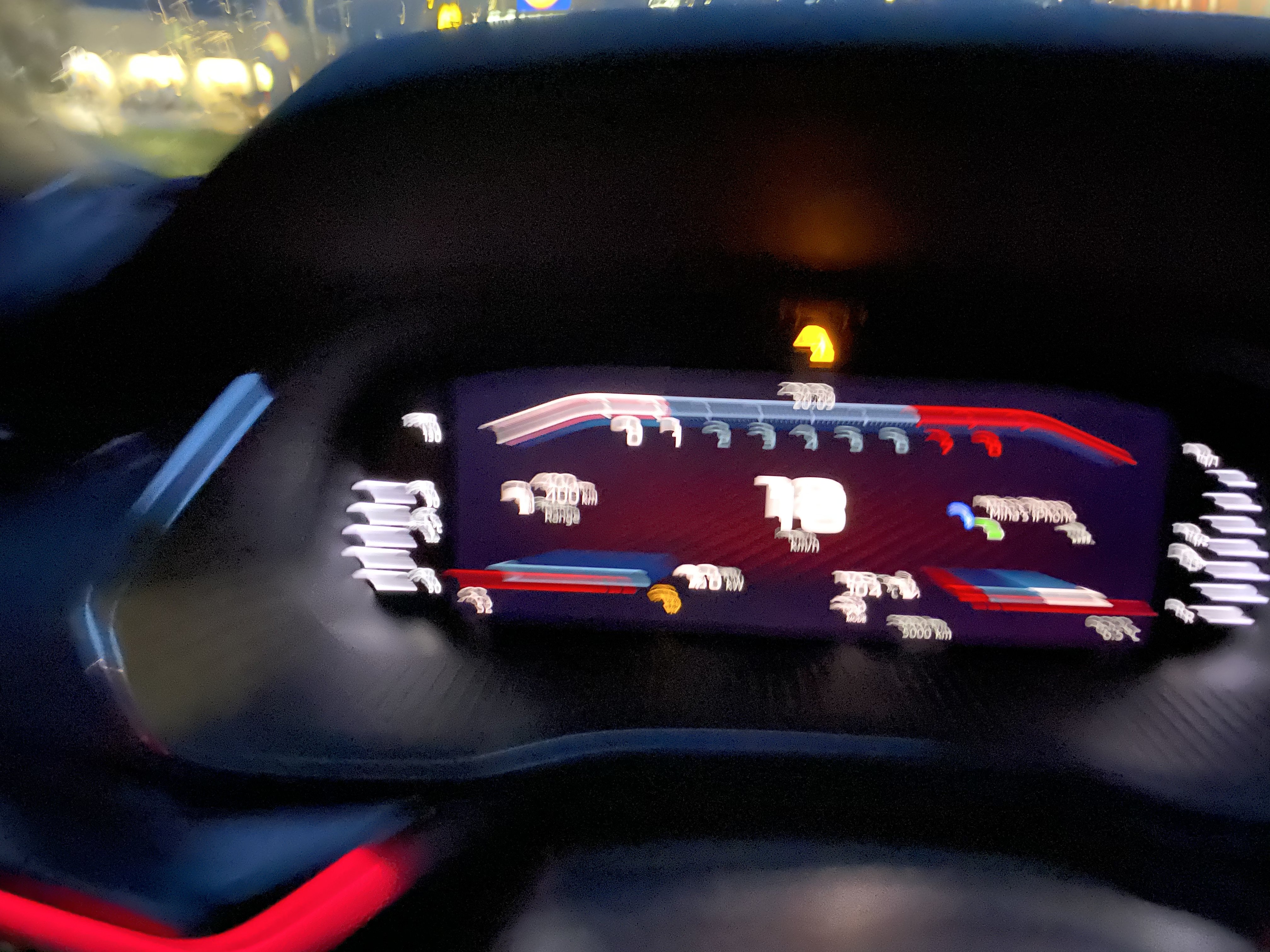

Sorry for bad picture. But you can see I have the phone selected in the right menu. When connected through bluetooth you can call the last (don't know how many) dialed contacts with the steering wheel buttons. Pressing the right wheel button, then go right and then you can use the right wheel button to scroll up and down through contacts.
Ohh and you can only use this when phone is connected through BT. You can't use it when connected to Apple car play.
Forgot to mention. You can answer or reject the call from the steering wheel. But to terminate an ongoing call is a bit more trickier. At least on my car. I think I saw somewhere on the facebook that it can be done differently so it could be this is a bug on my car.
