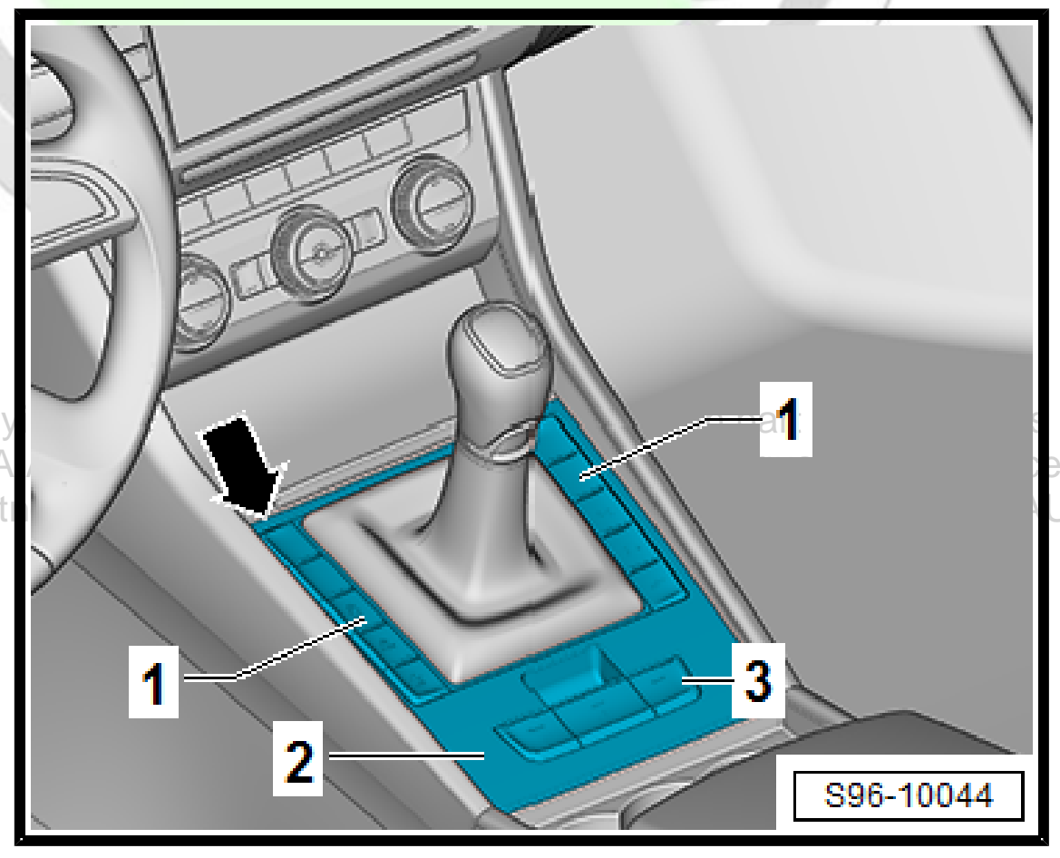

Hi folks.  I bought a cable to be fitted underneath the auto start/stop to disable it forever.  I have prised the bottom of the trim a little but don't want to force & break anything if there is a better way to go about it. Anyone any ideas?

Pull on the gear selector gaitor in the corner till it pops out. After this, reach inside and underneath the switch pack and push it upwards, it will come out and no need to remove any more trim
Thanks very much

using trim tools, i simply removed the switch module by prying from the top part upwards (see arrow n picture below), and the pry from the back to lift the switch module up.
