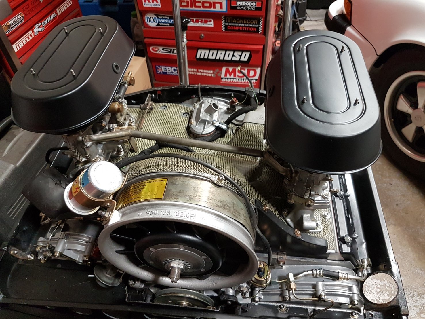

That is some price, still it is a Ferrari. I dropped in on my mate Nick today, who I have known for over 50 years. He has his own small garage one man business mending and building Porsche cars, engines and gearboxes etc. He is like an artist with the excellent work he does. Anyway, he asked me to guess the price of the engine he has just built for a classic 1969 Porsche 911 he is completely refurbing from the ground up. I guessed 20k. He said the pistons and liners on their own were £10k. The price was over £50k.  I took a photo of the engine while I was there.  Can't imagine what price his customer will be paying when the car is finished. Some car people live in another world to me, money wise that is.
