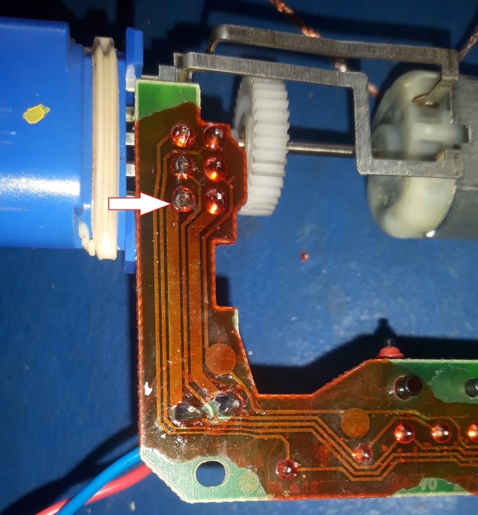

I would be checking for broken wires in the door bellows on passenger side.
If nothing is found I would repair or replace the door lock on that side.
Probably something like this:
Thank you so much, I'll look more into that, I really appreciate it!
It was exactly this issue, thank you so much!

Yeah, you need to get the plastic panel of at first, then remove the rivers by screwing them in with a powered screw driver and get the locking mechanism out. Then you'd have to check the connections on the locking mechanism board. I suggest changing it completely with a new one, as there can be multiple issues with like like perhaps a dying motor.
