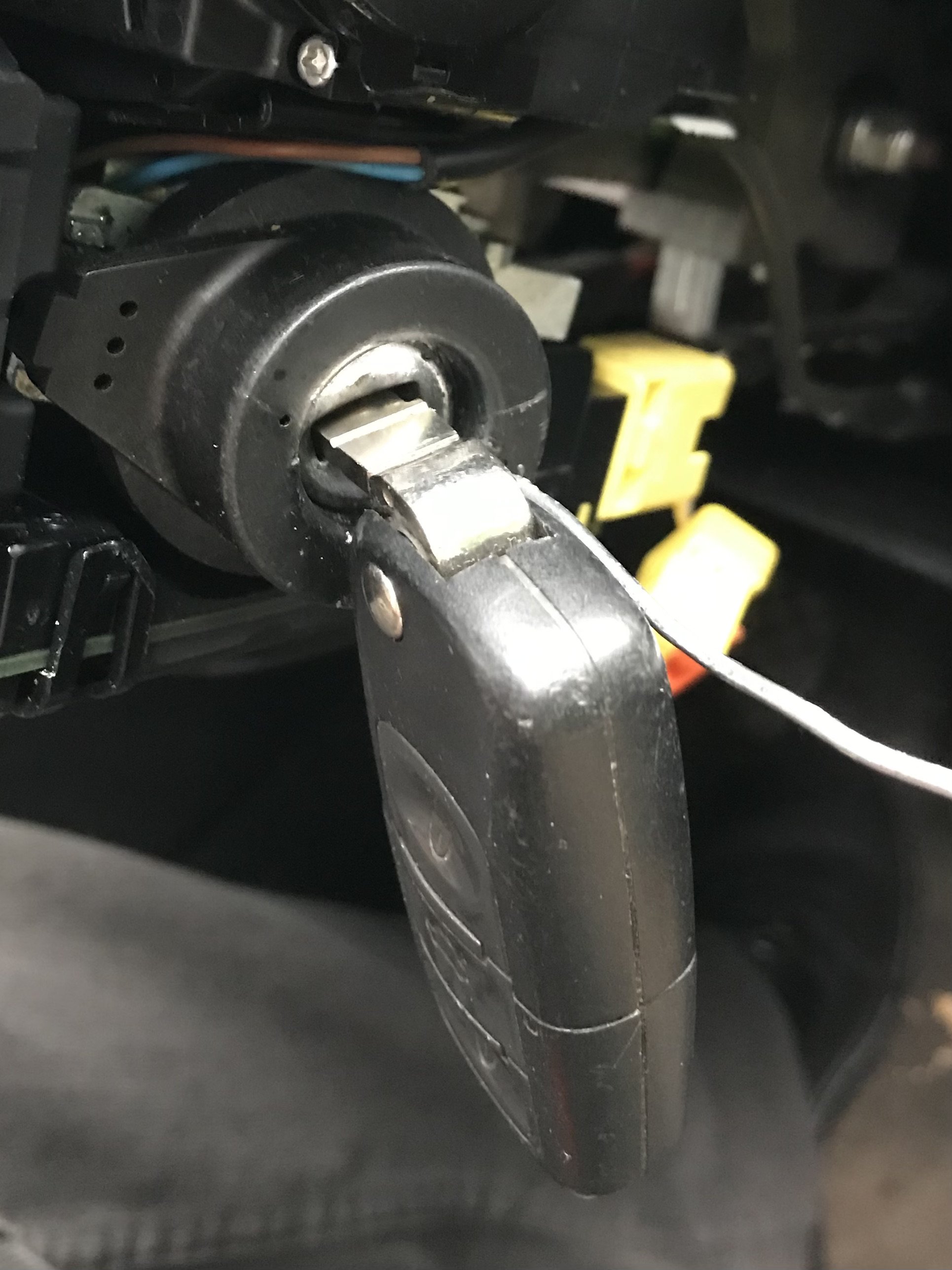

  • This is what I used for mine, it's a giant paper clip
Perseverance and brute force got you this far after previous failure, if you are sure you are depressing the catch with a piece of wire the lock assembly should pull out.
Possibly a paper clip isn't up to the task, try a thin allen key, screwdriver, drill bit, sewing needle etc.  It's tricky trying to think of everyday household items to use if you don't have the tools.
Once removed, you may not need to disassemble, just a good wash out might be all that's required to flush out any debris, you are best placed to assess things at that point.

This is what I used for mine, it's a giant paper clipIMG-20200823-WA0000.thumb.jpg.2da6e3656e2f421bb9750db7f4292f59.jpg

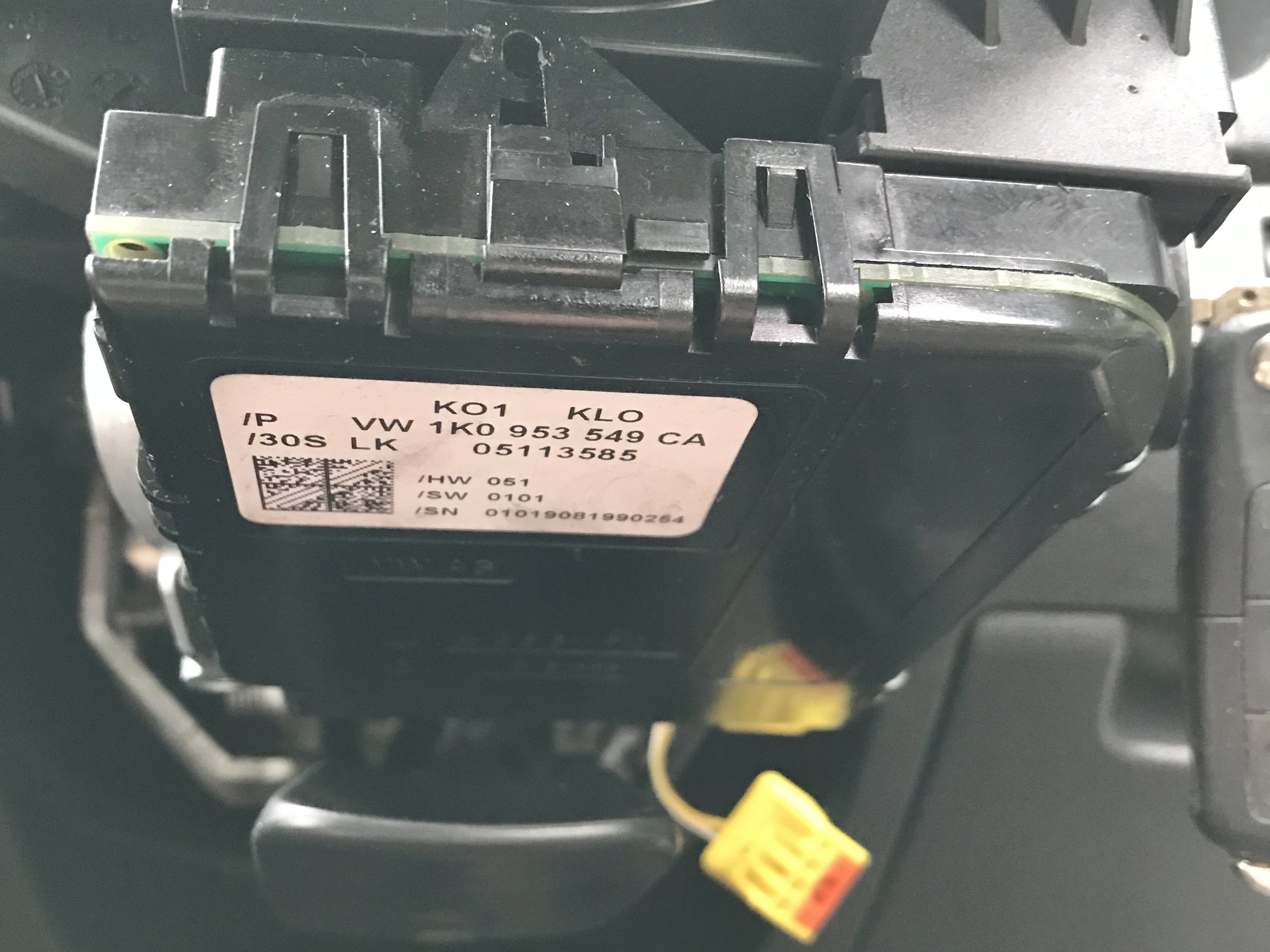

I guess I'll need to remove the barrel, but this flat black box is underneath and not sure how to remove that. I have taken out the tiny little Allen screw at the top centre, but it's still held. The ones I saw in the videos were different to this, and I don't want to wreck it. Any advice? Many thanks.
This may help, as there is a black clip you need to push in to remove the black box.   I did it a few years ago but I think I used a small Allen key to release tab in black box.
At
Cheers for that, I did get it off in the end, but somewhat more piecemeal than that!

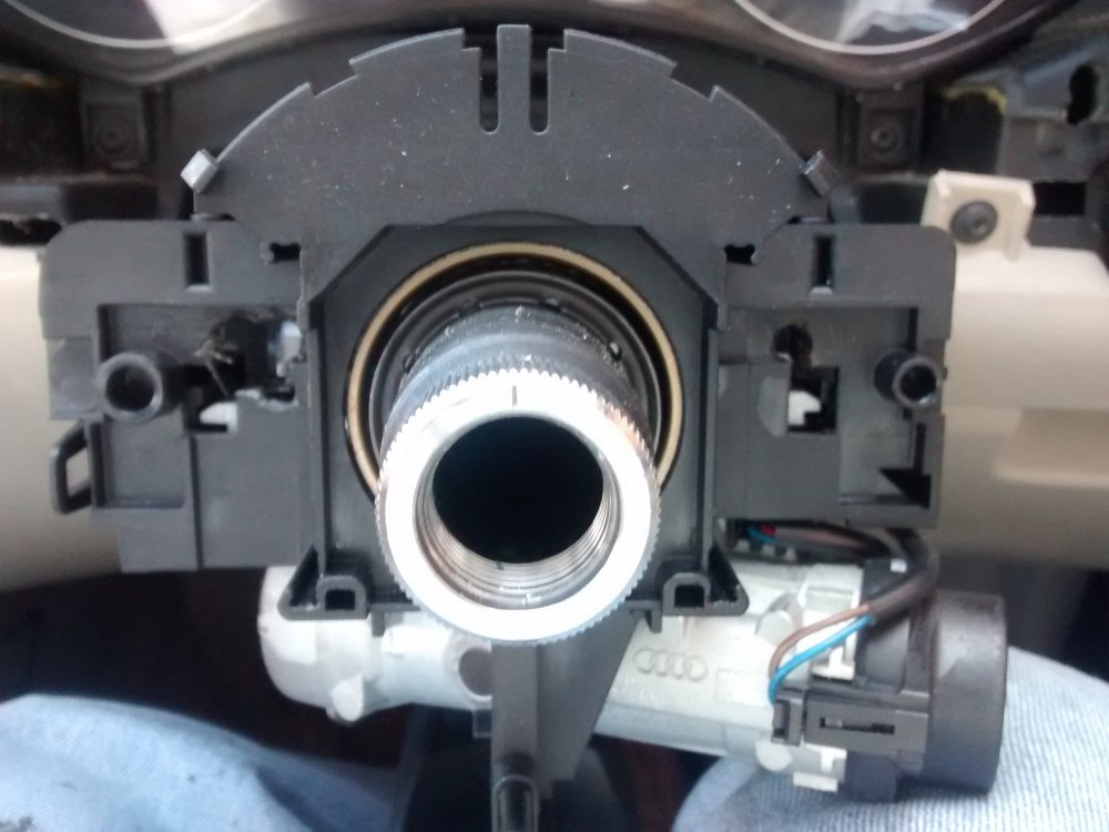

Believe it or not, after trying the shaft from a pop rivet, (strong, smooth and exactly the right thickness), with a lucky shake the cylinder finally came out. Only took nearly a week!
Trying it our on the bench after removing it, it was clear that the catch was not moving very far, and whatever I was trying in the hole wasn't hitting the right spot. But never mind, it's out.
Right, so now it's a question of what is actually wrong, as you can see from the key and cylinder video, they are not jamming at all. Looks like the cylinder is jamming at the steering lock point I think, unless it's the ignition switch at the far end. I might try and remove that next before taking out the barrel.

I went to remove the ignition from the end, and after popping off the cover then removing the switch internals, unfortunately they came out in bits. The main body, the white bit, had to be prised out. So that's one piece I definitely have to purchase! I'm thinking it's probably best to replace everything. We only have one chipped key, and the unlock function doesn't work, so we have to unlock the boot to stop the alarm from going off. And the steering lock does feel rather notch. Is there any one single supplier who any of you could recommend as best to get these bits without spending a King's ransom?
