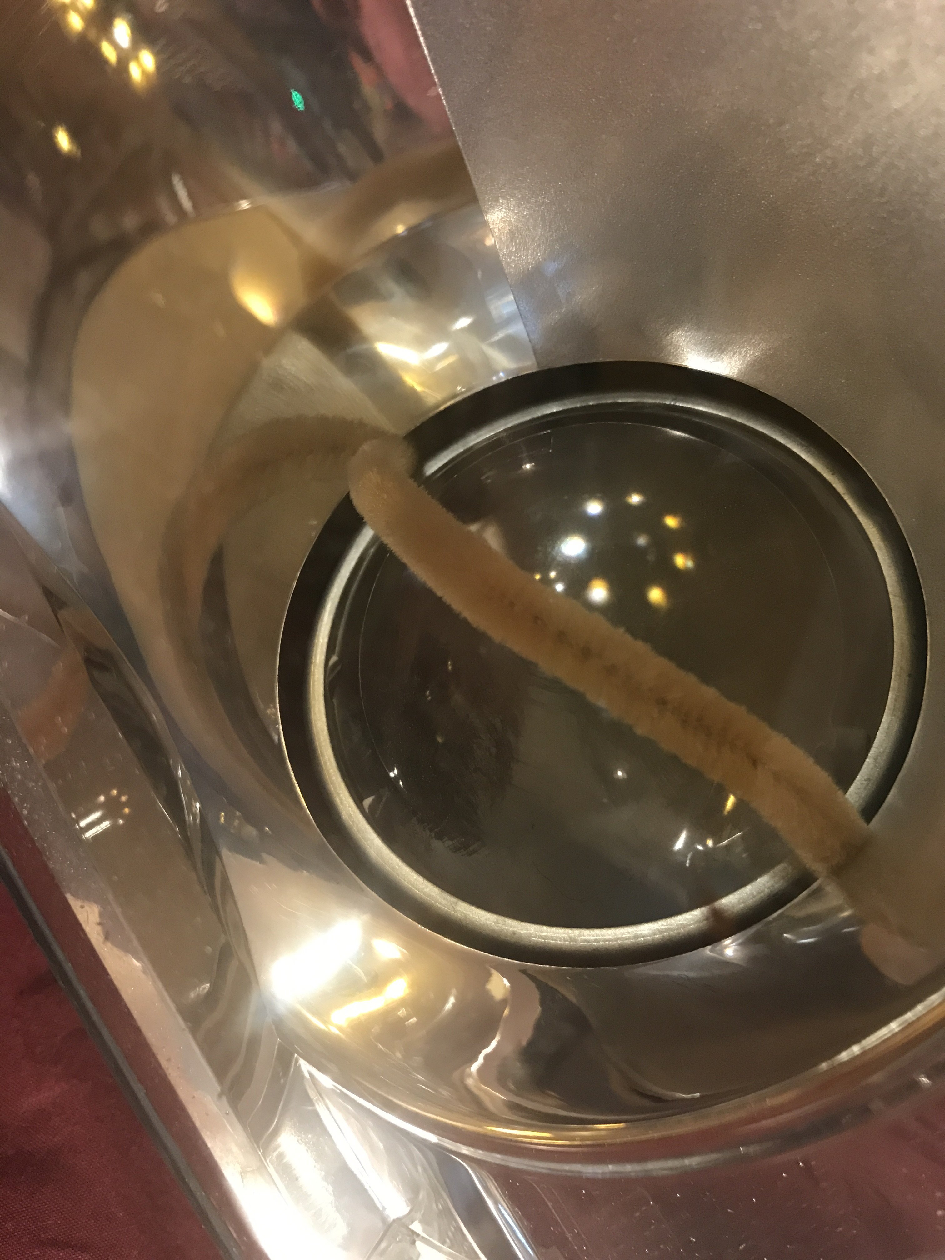

Got round to doing this job today. What a FTFTBBW (far too fiddly to be bothered with!)
I used pipe cleaners and IPA. I found that the front of the lens was as bad as the back. Had to get a bendy pipe cleaner and wound a few together to get the length and rigidity (f’nar) to get through a tiny gap in the side to access the front of the lens. A bit like keyhole surgery wearing boxing gloves. Made a huge difference. Can’t wait for a test drive to see what it’s like.

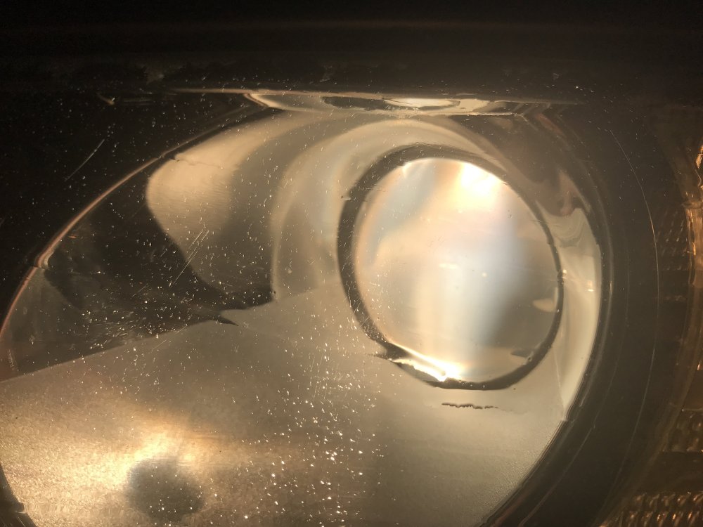

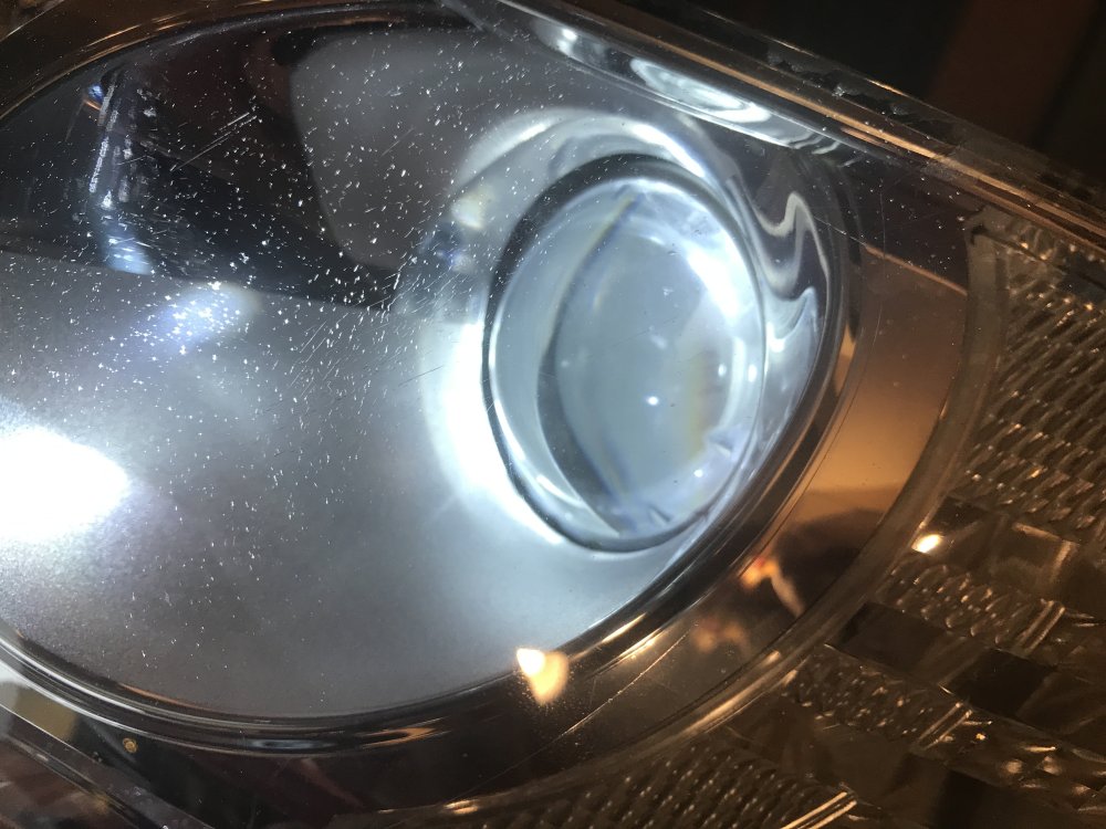

so this projector ball, how does this seem - not bad?

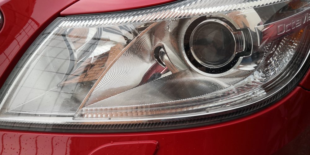

 That looks fine. It’s best to look at it with the headlights on and from a side angle. If it’s milky you’ll soon see it. The FL headlights look a lot easier to clean the front of the lens than my older model.
ok, i'll light it in night time and see it from an angle view , i'll attach photo to confirm - thanks

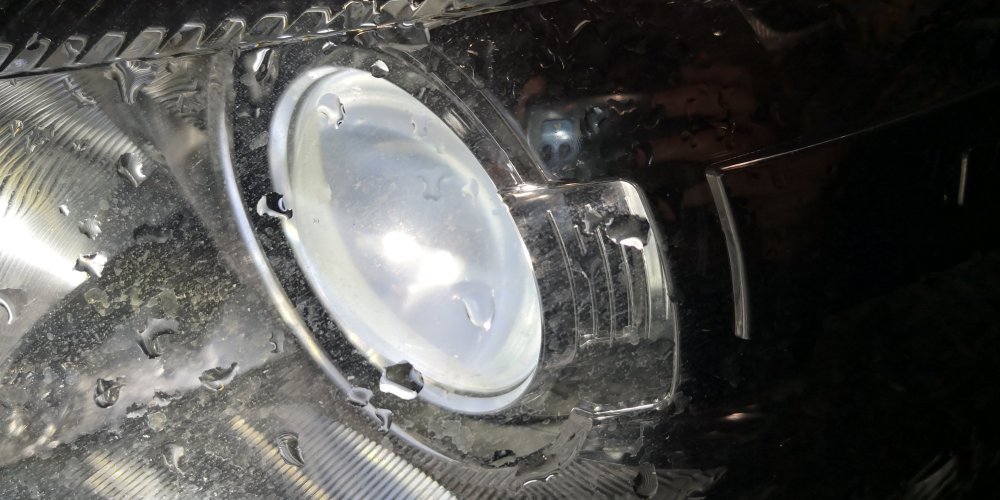

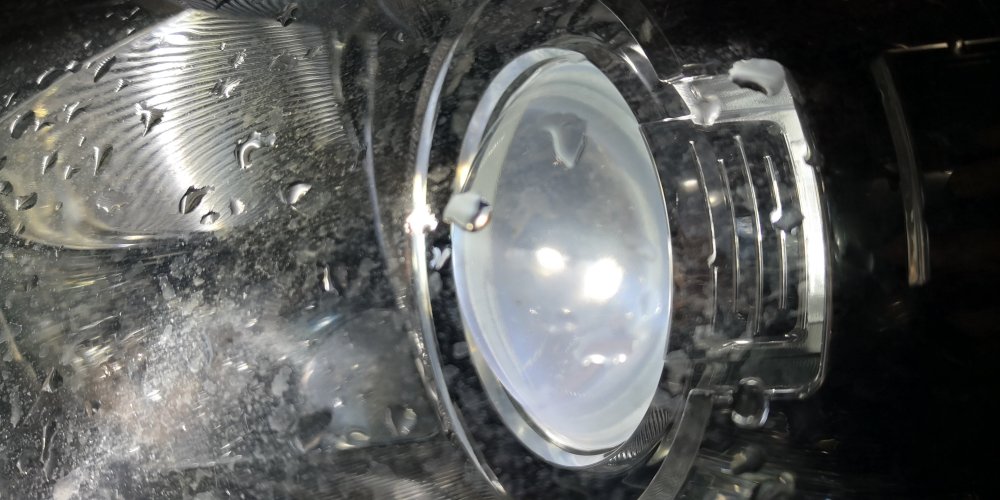

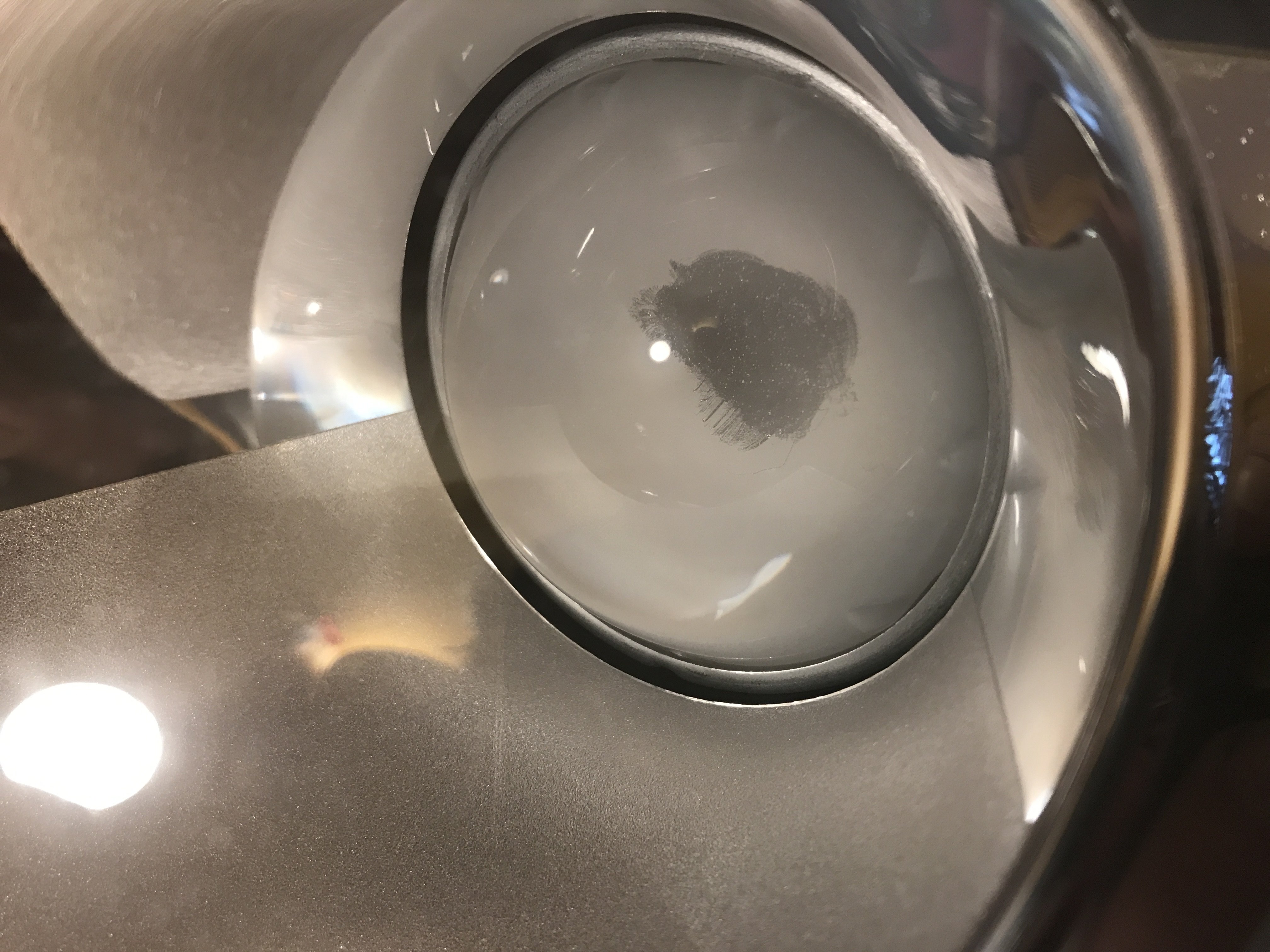

Some  photos with bulb lighten to show if it is considered as a milky one
Sorry for not cleaning the cover of it was necessary..
Edited by AVHreplica
I’d say that looks milky to me. The only way to tell for sure is to get them out and clean them. You’ve nothing to lose apart from a few hours of your time and maybe your sanity!
Thanks Golf-fiend, I'll arrange someday to do so.
I'll post same view photo as a comparison then.
