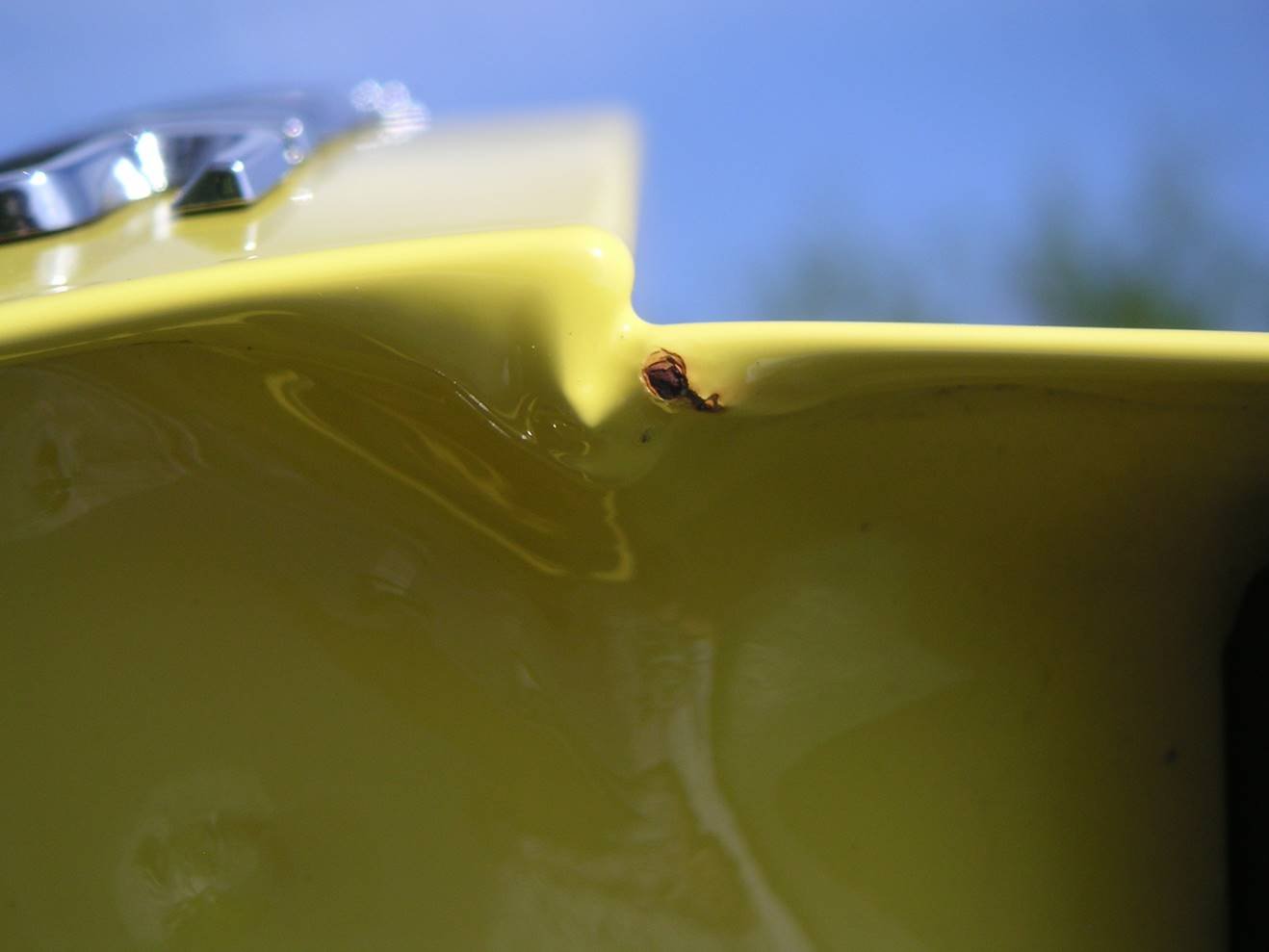

I think "sealings" might not be the correct word possibly due to an auto translation, its difficult to see what the photograph is of and what is the correct orientation.
To me it looks like a photo of cracking paint on the side return flange of the tailgate where there is a horizontal swage line, is that correct? It also looks like the side of the panel may have been dented, perhaps the tailage has been closed when obstructed by an object?
If it is a paint crack and not a leaking seal or leaking panel joint seal 5 years after a repair on a vehicle at least 5 years old then I cant see a main dealer or lawyer taking the matter very seriously.

I had a similar problem when my 2015 vRS was nine months old.  Skoda UK initially rejected the claim, so I sent them high resolution photo's and asked them to reconsider, which they did.
Stand your ground and challenge them all the way.  I had no idea there was a TPI.

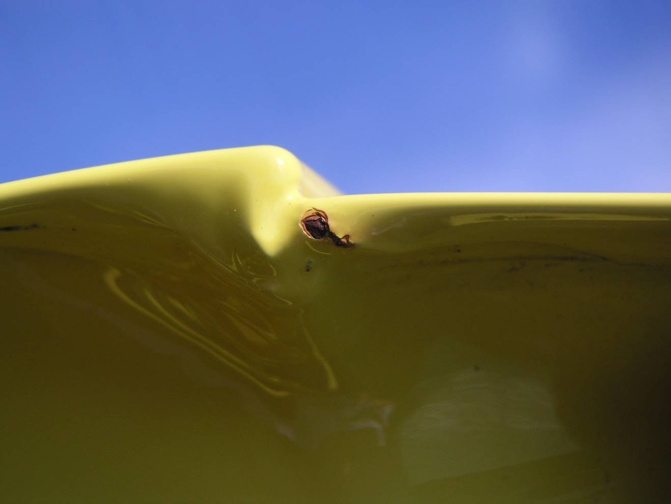

Photo's of mine:

That is terrible, from the silver letter in the photo was I right in where I think the location is?
Yours does not look to have sealant in that area, as a jig & tool designer in a previous life that looks like a badly designed component or press tool, the material being overdrawn and cracking, maybe a dry film lubricant problem.
Its looks to be stress corrosion and not a breakdown of sealant, no surprise that a repair would crack, I'm actually surprised at how little after 5 years.
Looking at the back of the car, mine was on the far left edge of the tailgate - yes, that's the S of Skoda you can see, above the swage line.  I was told the tailgate has a join here between two metal components.  I'd had mine from new and was a bit surprised to find it.  I was mildly apoplectic when they first rejected the claim as you might imagine .
G
Red arrow on my original thread shows the offending location:
