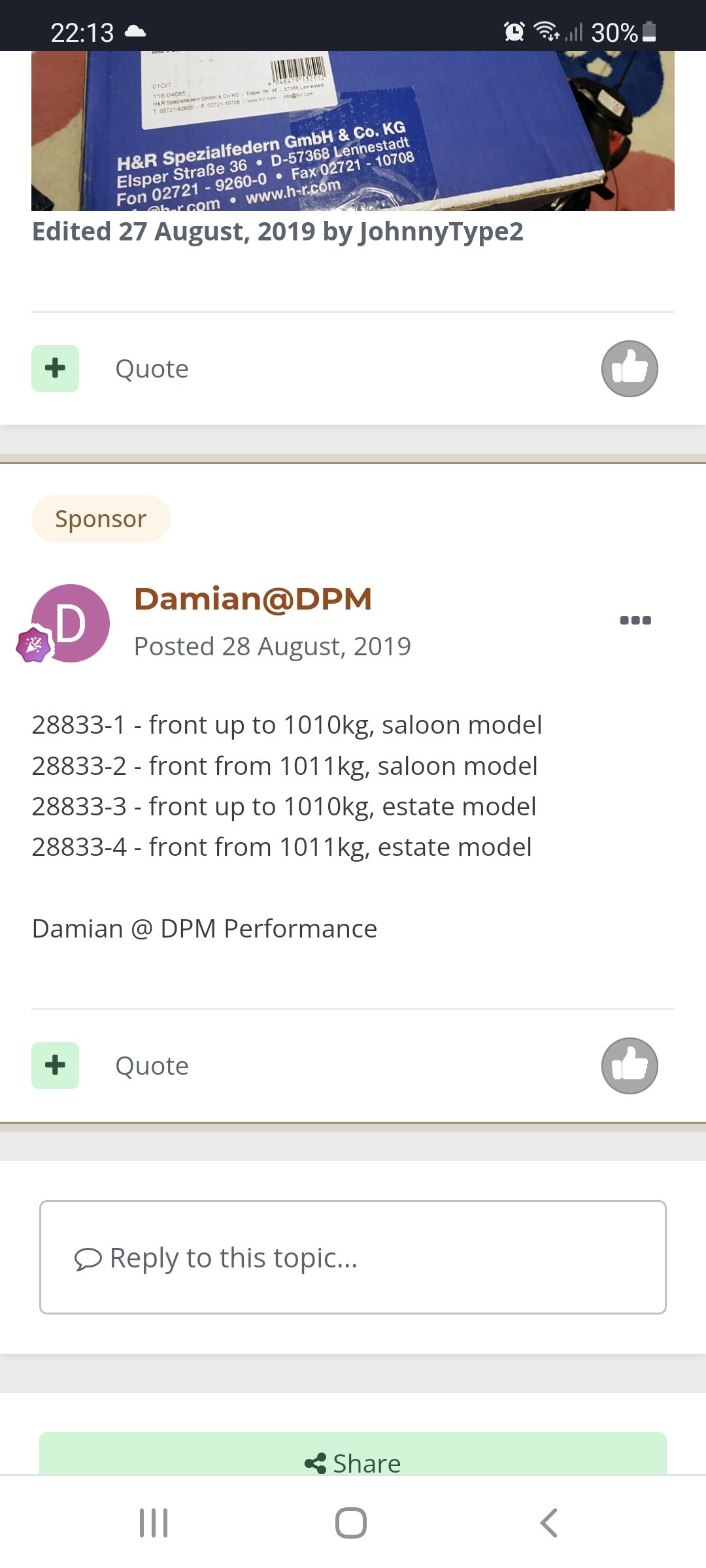

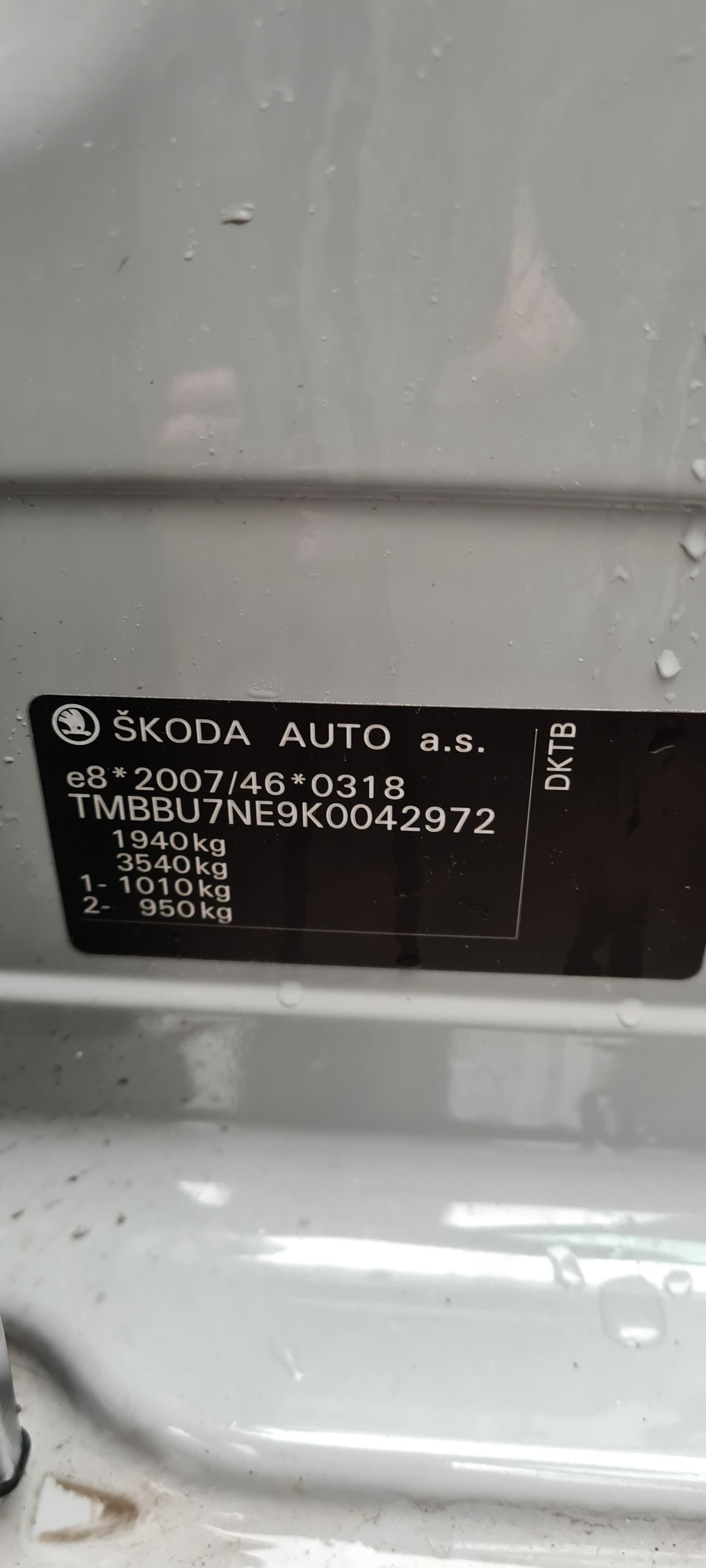

I've found the below on a thread, and then below that is the data plate from my door. .
If the information on these 2 pics is correct I need part no 28833-1 ???

28833-1 for petrol
28833-2 for dervs
28833-3 for 4x4
